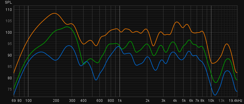

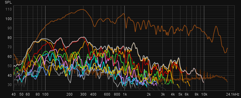

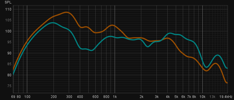

Managed to do some measurements, but had little time and was a bad day with a big bunch of noisy crows in a nearby tree and unusually much traffic 🙁 I hope I can get a better opportunity in the future to do better measurements, but for now this was the best I could do.
So most measurements have quite a bit of pollution, likely resulting in harmonic distortion being much higher according to REW compared to earlier measurements, and I also suspect some of the variations between FR at different distances can be attributed to that.
I had two plates hanging to the side of each other, so total plate surface 500x660 and all measurements are with 24dB 90Hz HPF, otherwise unprocessed.
Here is on axis measurement as 1, 2 and 4 meters:
45 degrees off axis at 1, 2 and 4 meters:
Averages off on axis (orange) and off axis (turquoise) :
I will do some work during the winter to smooth out the response by modifying the suspension at least, but they do handle EQ quite well. Didn't have time to do the EQ and iterate with analysis until I have a response I'm happy with now, so will hope I get some time to do tweaking at the venue next weekend.
My takeaways are first how different the FR is at different distances in the on axis measurement. When not using a HPF I have noticed deep bass is much more intense when close to the speaker, but that effect is very much diminished already at 1m and above 100Hz, at least that is how I perceived it. But in the on axis measurements at around 200Hz we see the expected 6dB difference between each response, even slightly more at one point. Then at 3k there is an even bigger gap which is a surprise which I have no explanation for at the moment. The on axis measurements for both 4m and 1m does seem quite wonky and I really have to redo them to verify they are correct.
Otherwise the typical difference between 1 and 4 meter seems closer to 8dB than the usual 12dB, but in the off axis measurements the average difference is perhaps 10dB.
So I would say that the graphs as they are does show that the sound travels further than with a regular point source, but being of questionable quality they are not really conclusive.

I what kind of location did you take these? The appr. 300 Hz is probably the floor bounce?

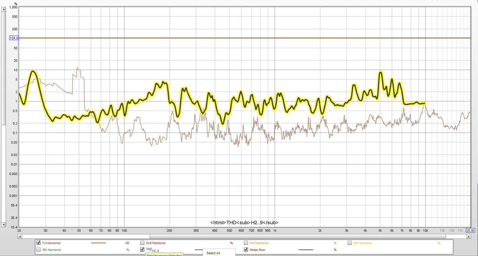

45 deg look quite nice. You didn't include any distortion graphs...
The frequency response could likely be very flat with some experimentation wr to varying the thickness of the panels from outside edge towards center. I wonder what might happen if one were to contour the panel to match the typical response graph but reversed.
In my garden with the centre of the frames hanging around 1.5 m above ground. Would been better to hang them higher as well as on top of each other instead of next to each other I think though.I what kind of location did you take these? The appr. 300 Hz is probably the floor bounce?
But I suspect the bump at 300Hz is a strong mode in the panel, which is seems typical for a panel around these dimensions. The first and second modes of both the sort and long side will easily cramp together in the lower mids, and getting them to spread out to avoid that bump is one of the main goals and challenges when designing a panel it seems.
I didn't include distortion graphs because I felt they where very unrepresentative since the distortion is much higher compared to earlier measurements I have done. I will have to try to determine if it was simply the background noise or the fact that I was driving a single plate per amp channel in 4 ohm instead of two plates in 8 ohm as before, and still getting similar SPL, so in effect driving the plates/exciters double as hard.
So until I know what is the cause of the increased distortion I would not read too much in to it, but here is the graph for the 2m on axis:
Off axis and difference distances look quite similar with about 30dB between THD and fundamental. Can also see that noise floor reaches almost 60dB.
No, like I mentioned I ordered an SPL meter so I can make absolute measurements, but it got lost in transit, so waiting for a new one :\Is the voltage/SPL calibrated?
Personally I don't have as much interest to know the absolute SPL any more after testing them in the field and knowing how they stack up together with some decent subs, but will do calibrated measurements next time hopefully.
There are a few ways to flatten the response. Varying the thickness is one way, but a lot of work and will not give the strongest effect.The frequency response could likely be very flat with some experimentation wr to varying the thickness of the panels from outside edge towards center. I wonder what might happen if one were to contour the panel to match the typical response graph but reversed.
Width and height of plate seems to be the most important factors when it comes to where the strong fundamental modes will be placed.
Plate suspension seems to have a quite strong effect and can be quite easy to modify.
One can also place weights at certain spots to dampen modes, which will have a similar effect to varying thickness.
That said, DML doesn't give a flat response by nature. The sound is built up by modes, and you can spread out the peaks those create to get an overall flatter response. But even with a prefect design, count on having to EQ those peaks down a bit if you want a flat response.

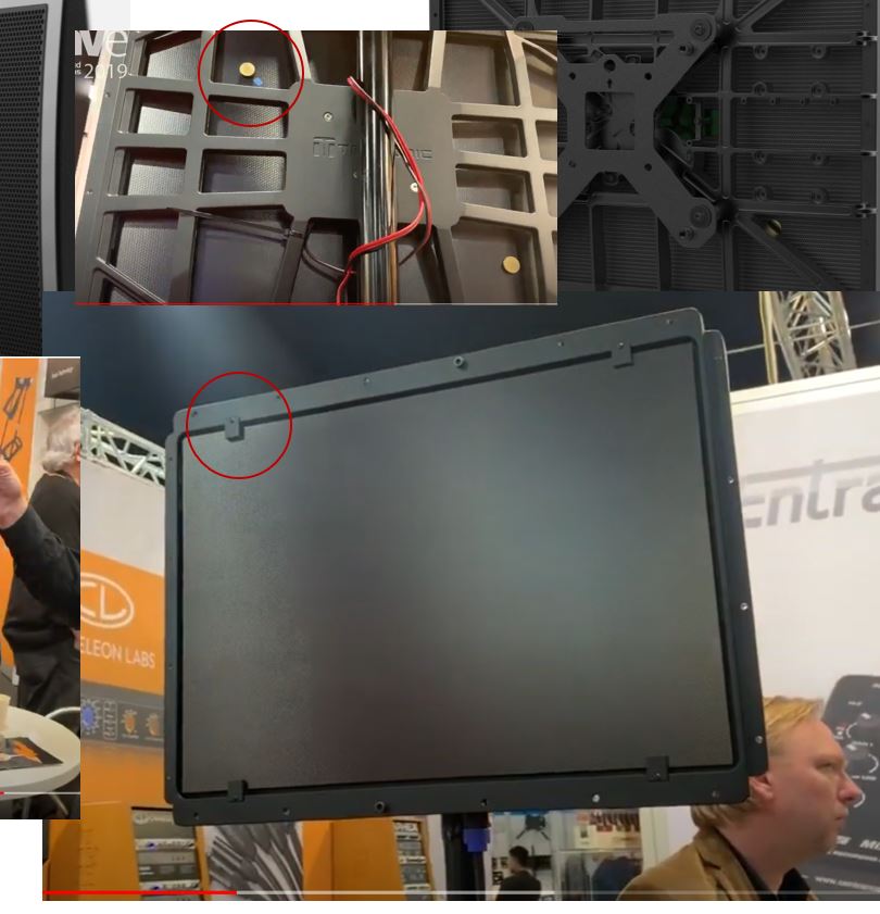

One of the things otheres have found/reported is that rounding the corners will help reduce the edge reflection (think og waves in a pool hitting a wall and being reflected .... not sure how much this matters.

PPPS. Also you can see on this picture how they use 2 weights for damping, and that they are supporting the panel 4 places (See red circles)

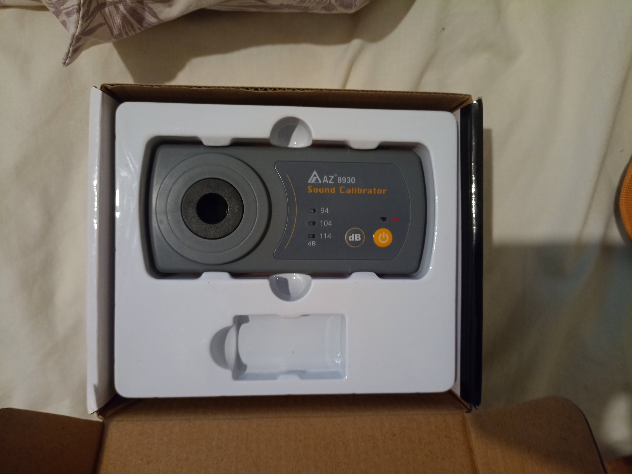

I looked at those, but not sure I feel it is worth the investment compared to a SPL meter? I guess the advantage is much better accuracy compared to an SPL meter in the same price range?The way to get calibrated measurements is to use a microphone calibrator it fits around the tip of the measurement mic and generates a 1khz tone at a known SPL. This one is the cheapest available that works with the ecm8000.
Was hoping that a cheap SPL meter would be good enough as reference, but I guess their typical +-2dB accuracy is a bit useless.
You can calibrate your mic and also use it as an SPL meter. Quite often you need to monitor SPL when doing gig/festival work in the UK due to offsite noise restrictions, adjacent stage bleed etc. As the cheaper calibrators are only class 2 and cheaper measurement mics start to compress >120dB this isn't 'perfect' but from my experience using an ECM8000 and this calibrator my results are very close to and track any expensive metering that has been brought to FOH. This is very useful as you can then define numerical limits that you can follow. Cheap SPL meters won't have measurements like Leq(z) which are often what people will want you to follow. The next step up would be a class 1 calibrator and a measurement mic that could handle higher SPL but this is expensive.
The main advantage of using a calibrator for me though in speaker development is that I can take measurments and have them be comparable to other measurments I took at different times. If I measure at 2m/2.83V with a calibrated mic and record how I took that measurment I can easily use with another measurment I took another day.

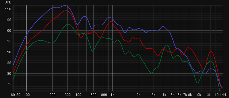

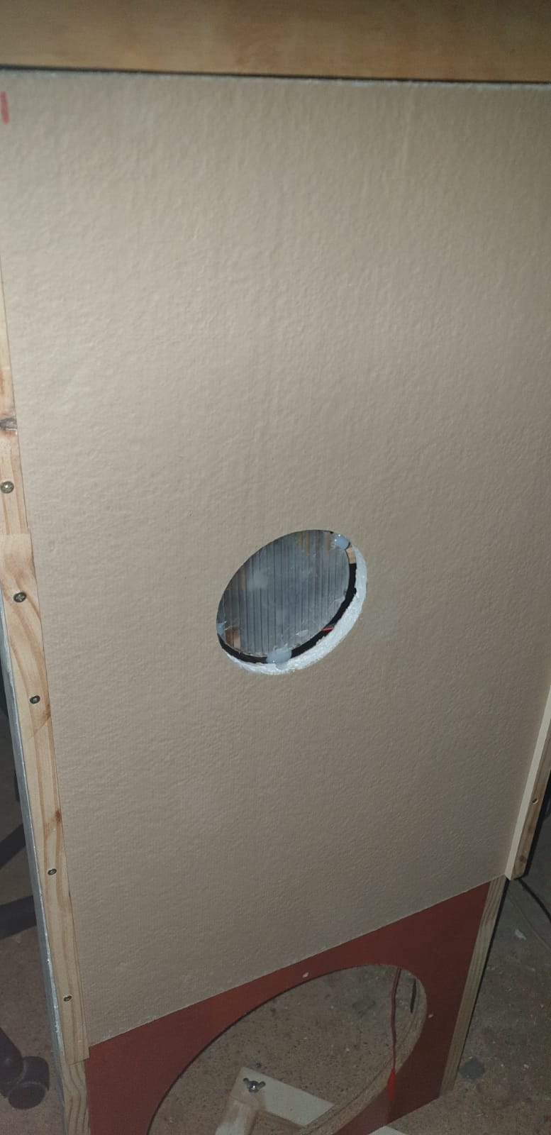

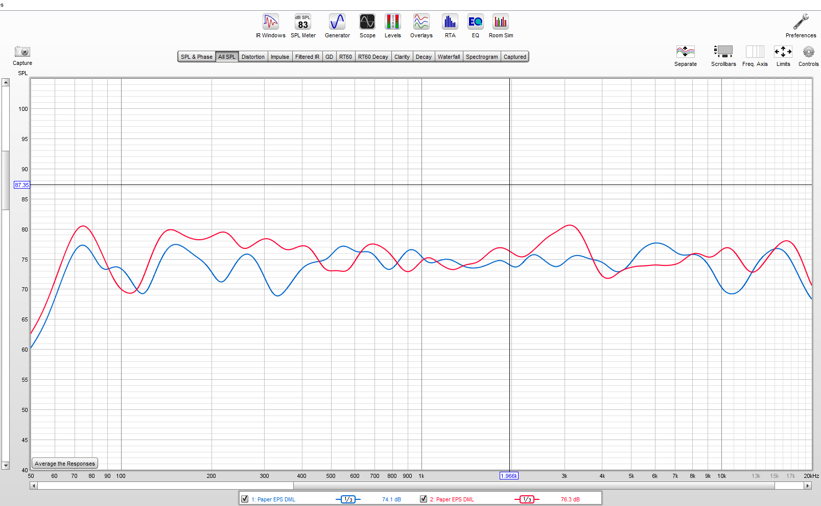

Sooo I've been playing with this... after battling with Tectonic exciters, and multiple variations of substrates and laminates, I've eventually settled on 20mm EPS with paper skins which sound kinda ok.
The screen-shot shows FR curves for two panels sized 460 x 770mm and measured nearfield (50cm). The panels are fixed, undamped, on their long sides, and the short sides are unsecured. The drivers (one only per panel) themselves are bolted into a stay, and mounted on 100m dia polycarb discs behind a 105mm hole cut out of the EPS. Three blobs of hot-glue secure the polycarb discs to the EPS. The paper skins are the only damping.
As the other pic shows, I WAS going to do a hybrid open-baffle with a 15" high-Qts driver for the extreme lows, but the slight bass loss vs better dynamics and definition (without the cross-over and additional woofer) is a no-brainer. So these curves are for the panel only.
The difference between the curves is due to the amount of glue used to secure the paper to the EPS. The panel with the flatter response (blue) weighs about 240g in total, and t'uther (red with the peak at 3k) is about 290g. Too much glue...
Next step: Drive this baby with 4 exciters per side and see if I can use it for live gigs. Each panel SHOULD handle around 160WRMS. And at around 99dB/W sensitivity per panel, this translates to over 119dB when driven at 300W peak.
I suspect that the EPS/paper laminate might not handle so much ferocious abuse for 3 or 4 hours at a time. In which case I might have to revert to polycarb twin-wall panels, and a bit of EQ.
Whaddaya tink?

Zeess von?Nice! Can you please post distortion graph for the blue trace?
