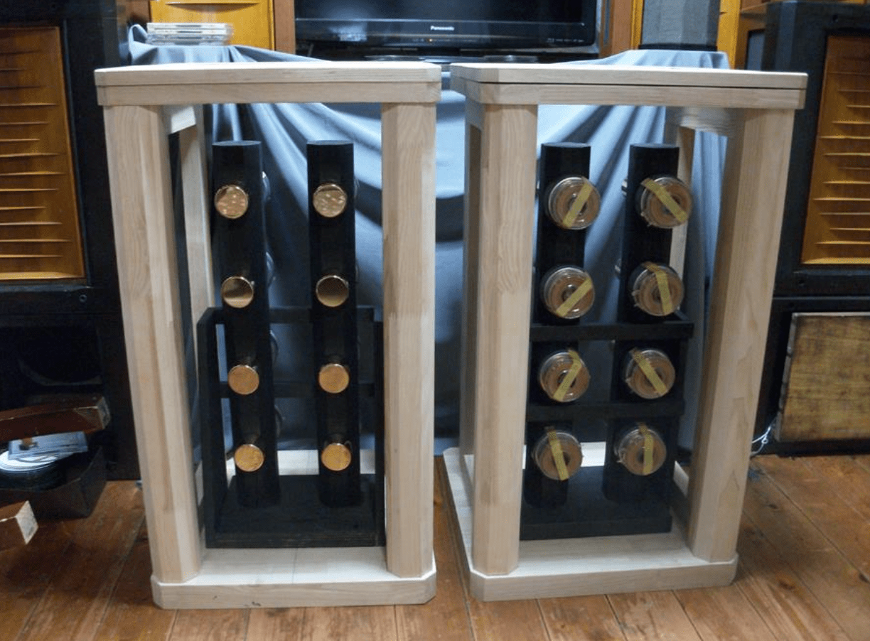

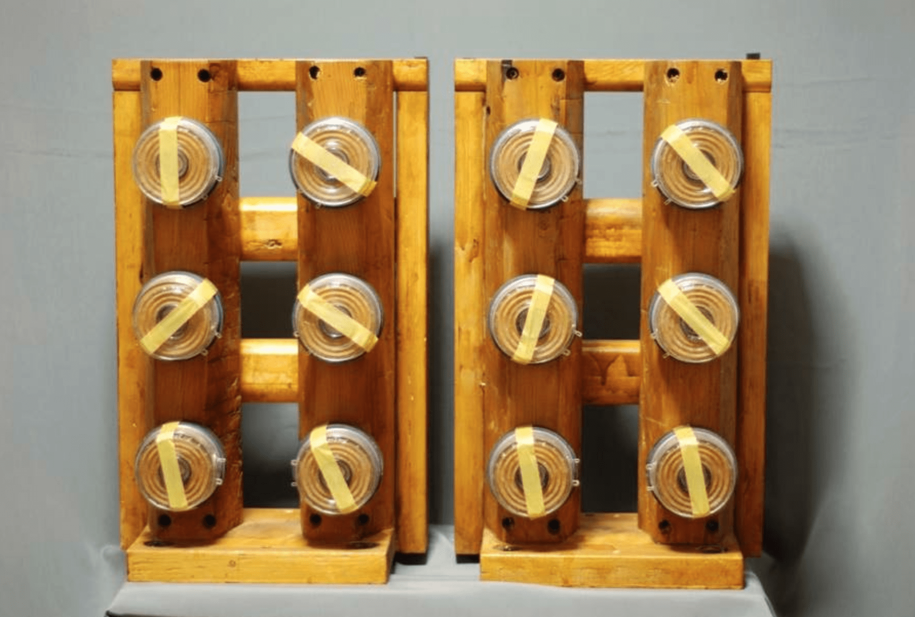

While I am waiting for components to arrive I have been looking at how Teragaki-Labo use exciters and there are a some aspects that are very interesting.
You can see from the image below that they use a lot, six is not exceptional. They also position them symmetrically with no attempt to find a 'hot spot' to excite modes.
They are also huge relative to the size of the panel similar in size to the magnet structure for a 100mm mid-bass or even a 165mm driver.
There is one more thing that, as far as I am aware, is unique to these speakers. They use a mix of 4ohm and 8ohm motors as the bandwidth varies according to impedance. There is no XO used, they rely on the difference in response due to the difference in impedance.
This last aspect I find intriguing.
Burnt

This is a nice sounding video, but I would expect this type of panel to excel at playing this type of music.
It was also interesting the photo of the extention to the coil, this would tie in well with the sort of exciter I was talking about, I must do a drawing to explain this ?
Steve

Hi Steve,
Yes I have seen those images and they are interesting. I have no idea what the extensions to the drivers are for and the Japanese website does not go into much detail on the motors. The details I could gleam were more about the need for a very robust frame, the original design used logs as a perimeter frame, and the use of 2mm thick balsa for the diaphragms which are hand made and varnished with special care taken with the varnish and the placing of the curved struts. The curvature is introduced to raise the resonant frequency of the panel. The motor array doesn't take any notice of modes or special positions as you say so although a DML, the evolved design is very different to what we are used to exploring.
Te design was evolved by trial and error from an initial design that had the massive log frame and a flat panel reinforced with ribs. The development was iterative recursive approach led by listening tests. Very interesting and it opens up the design space significantly. I am going way of topic so now will return to exciter designs. I have found a way to ditch the spider for Option 1 which I need to detail to get the components made so I am focussing on that.

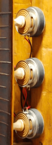

Hello Burnt
By extension do you mean the white part between the voice coil and the membrane? I have always in mind to test a point driving...
The curvature gives stiffness in the direction across the grain. In a thesis about piano soundboard, it is explained that this increase of stiffness has a limit in frequency when the wavelength comes in the range of the distance between the ribs.
An other observation is about the opening of the engine between the spider and the magnet to avoid probably spider noise.
The voice coil seems very long too.
Hi Christian,
No the extension Steve is referring to looks like it might be an extension to the magnetic circuit which you can see on the left in this picture
What isn't obvious in this shot is that the extensions are something like 200mm deep and that is not including the circa 60mm thickness of the large wooden mount the motors pass through. This implies a very large magnet assembly and potentially a high B component. But equally clearly there is a large ferrite magnet visible from the front which is a bit more conventional. All very confusing. Its difficult to tell without a sectional view or a patent but I am not sure there are any patents for this design, I have not been able to find any
I agree that the white extension attached to the voice coil is probably a force concentrator and it also helps deal with the curved surface of the panel. The point drive is something I want to experiment with at some point and I am trying to develop a set of modular components that will allow me to experiment with a variety of motor structures and panel 'drivers' I will put links to these components up on the site for anyone to experiment with once I have settled on component designs that work well together.
On the panel design I also would anticipate that the ribs restrict the bandwidth and you will see in several other images a great deal of experimentation has taken place to establish best positions. However, its difficult to be sure because the only music I have heard played on them is also bandwidth limited. Teragaki-Labo used to sell a 10inch paper bass cone with the panels to handle the bass but there is mention that later on this was dropped and the response of the panels were extended.
The effect of the curve is intriguing and something I intend to experiment with in due course. As is the use of drivers with bandwidths tailored using just the voice coil impedance which is a novel approach.
