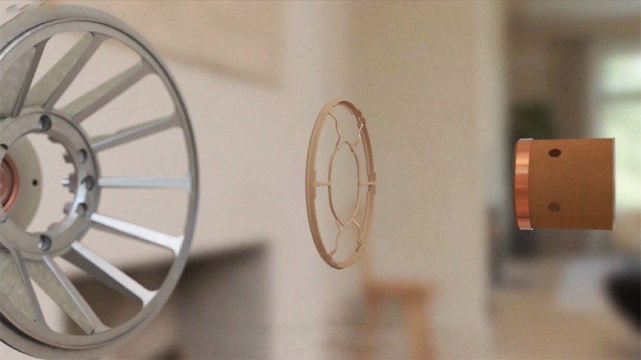

No, composite material doesnt say much.Thank you @lenta, that is very interesting. Do you have any information on materials at all? Also the hinge?
Burnt
Also what looks like hinge maybe is not hinge and is fixed.
Part nr. for the driver is LF27723.

Burntcoil.
Some good ideas already on this new site.
I like the thin spider , which looks similar to the photo I posted a while back ,of an old cone drive unit spider ,possibly from the 1950 ?
I'm not sure if it was made out of thin leather or maybe a form of gasket material.
There were screw mountings, so it was adjustable.
The point I was making about different exciters for different materials and why, ( I will have to do at another time as I am being beckoned away ) .🙄
Steve.
