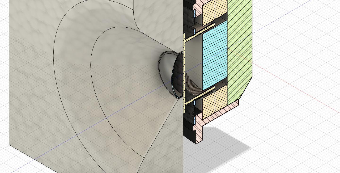

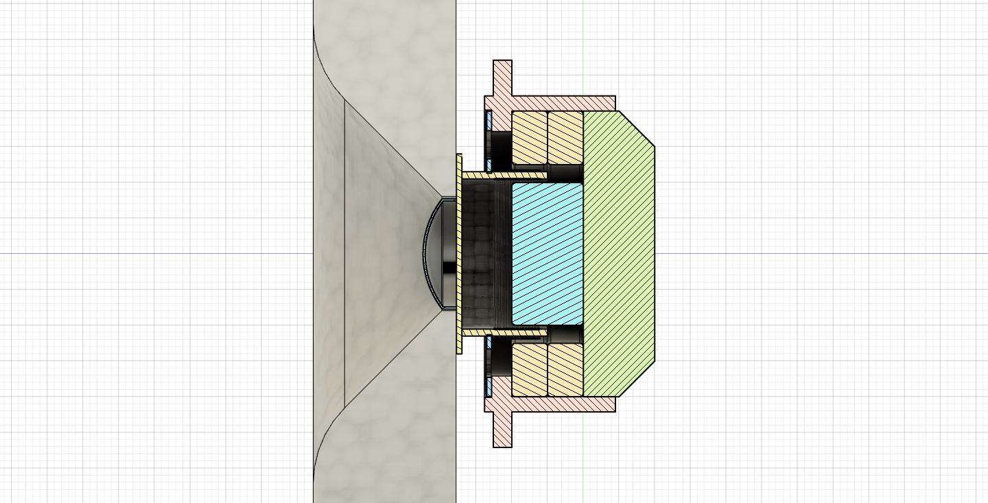

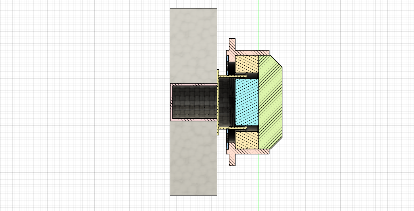

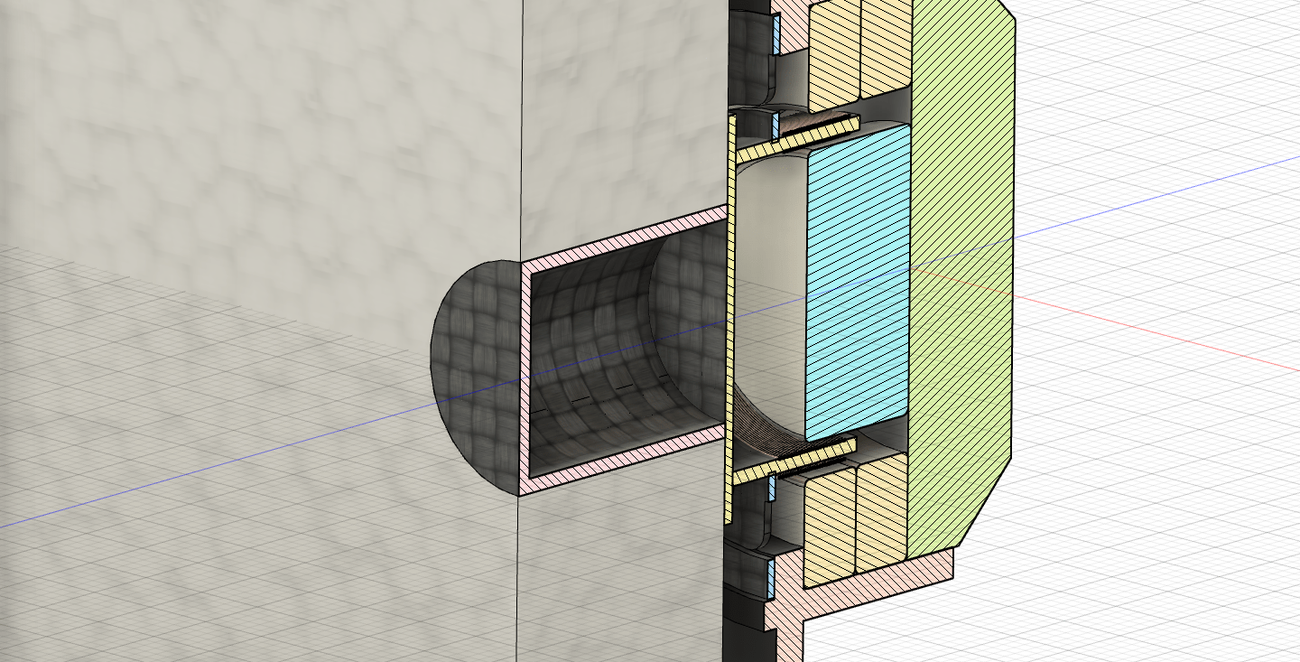

@spedge A very quick sketch of an extended pusher idea for 20mm EPS. A 3mm Ply would be sized to fit. The extension would be epoxied in place to both the pusher plate and the EPS panel including the sidewalls of the EPS hole. The final sizing and profile of the extension would be subject to testing.
I would test using Carbon Fibre because it has a fast velocity of sound, faster than EPS, so even with 20mm to travel it would not exhibit any phase lag from front to back of the extended pusher within the audio spectrum and the front circular cap break up would also probably be outside of the audio frequency. The chamber could be lightly filled with Dacron fibre or foam to mop up any resonances should they occur which I believe would be unlikely due to the stiffness of CF.

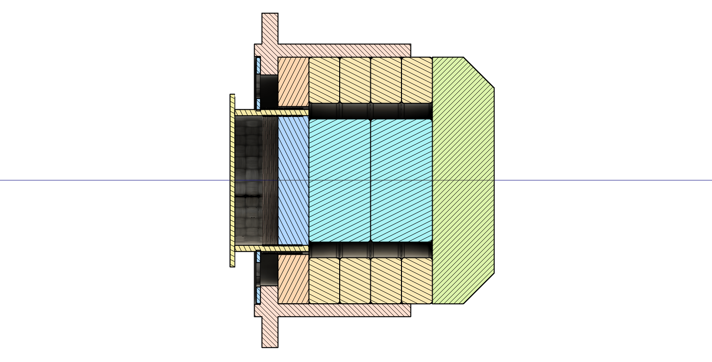

So for Option 1 I now have a set of components that allow me to experiment with the strength of the motor and the stiffness of the suspension. By changing the magnets count in the motor I can change the flux in the voice coil gap and by changing the material and thickness of the suspension I can tune the compliance of the motor. All hand wavy theory at this time.

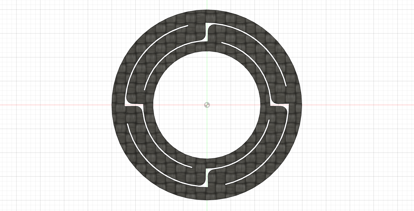

The Spider design is shown below. I am planning to have these cut by water jet to provide accuracy and allow several different material types and thicknesses to be produced with an identical design. Water jet cutting is cheap if you provide the materials and from experience working with Carbon Fibre manually is perfectly feasible but the dust produced is nasty stuff so best avoided.
