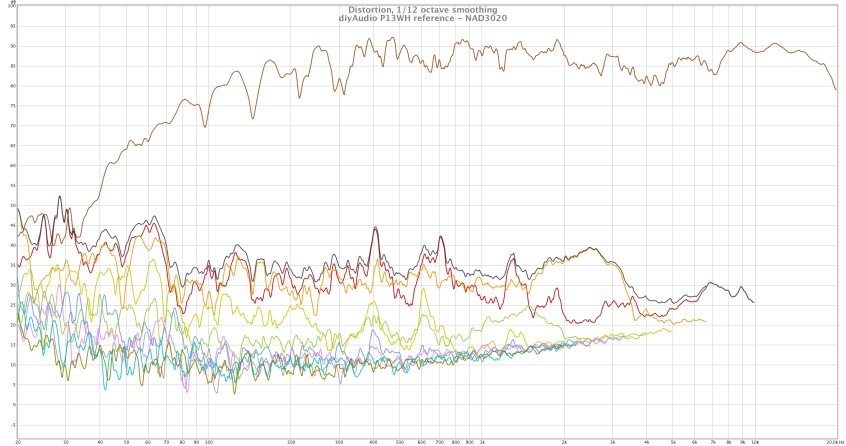

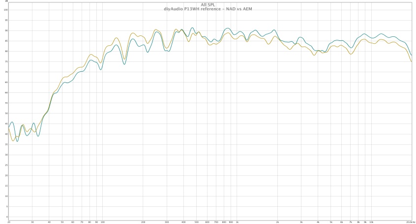

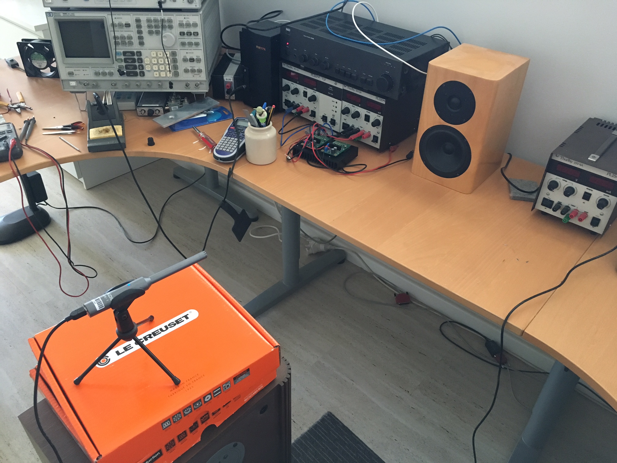

Now that my diyAudio P13WH reference speakers are broken in (ten plus years of daily music's gotta count as broken in, right?) I thought I'd measure them.
First photo shows the measurement setup. The position on my desk is pretty-much as I have them on the bedside tables - about 10cm from the wall.
Next plot is with an AEM6000 derived amp. This thing is flat from 5Hz to 100KHz +/-.1dB, so makes a good reference. The bass is... lacking. It gets much worse when I pull it away from the wall.
Next with my NAD3020B, which has been sitting by my bedside driving these speakers for pretty-much the whole time I've had them. Despite building a pile of super-duper low-distortion, incredibly flat, super low noise MOSFET amps, I've stuck with this one for driving these speakers, despite the hum and hiss.
Now I know why. It's lack of flatness (bass and treble controls are mid-way) EQ these speakers rather well.
The final plot shows a comparison between the two amps.

Thanks for posting the measurements Suzy. Not too bad and I'm happy with that as I've seen a lot worse. The xo, with 3 components, seems to be doing it's job. The distortion values are higher than I expected and in particular H3, but you tend to get higher H3 than H2 in speakers. At least there is not huge variations in distortion over the operating range. Yep, bass is MIA. If you need more top end you can always drop the resistor to the next lowest value.

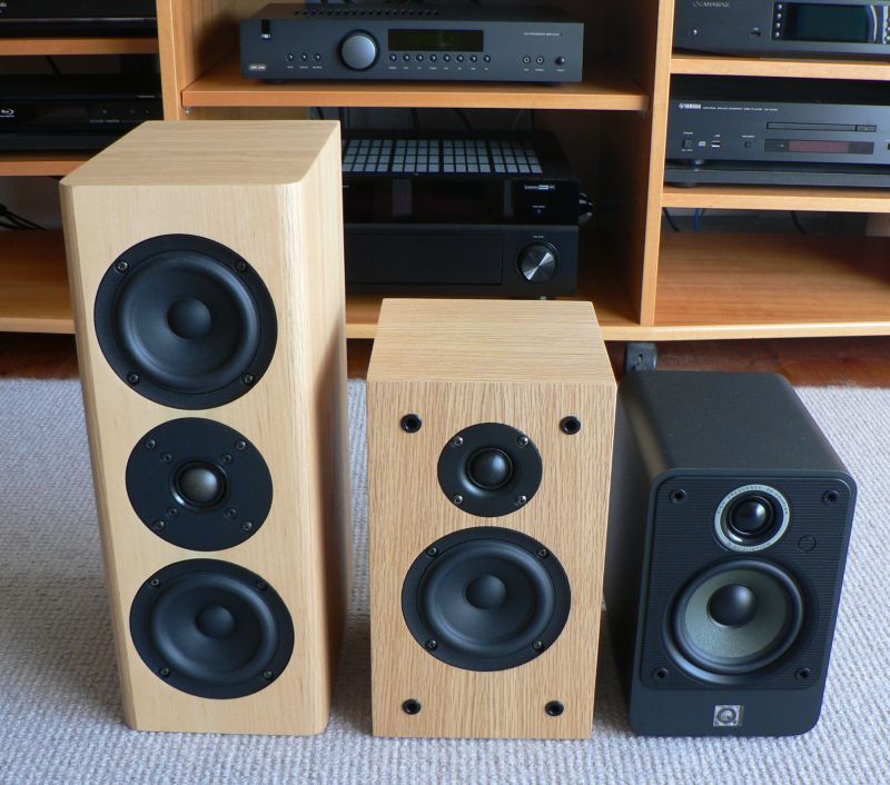

Had a look at your "noisePlank" and very cool. As usual you've done a great job and it's an interesting read.
What speaker is the black one on the right? What drivers?
Look like one of a set of Q Acoustics 2010i's, an off the shelf speaker, with their own drivers.
Q Acoustics 2010i Compact Bookshelf Speakers Pair
Correct. There are details on this speaker and later in the thread, driver details.
