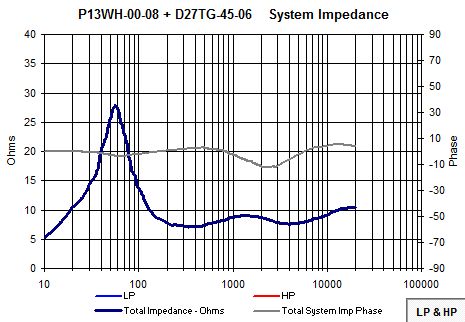

I have been very satisfied with my Vifa combo and recently went bipole (one set front - one set rear) in a metronome. I would like to try the series crossover but am unsure what needs to be changed. The simple but costly solution would be to treat each pair discretely and parallel the pair.
Can someone tel me how to change the values contained in post #179 by rabbitz for a 4 ohm pair?
? Halve the inductor value and double the cap value?
The best starting xo for a bipolar is the last one from post #179 as it doesn't have BSC.
Changing the inductor and cap values as suggested would in theory be a starting point but the value of R has an effect on both the tweeter and woofer unlike a parallel xo. You could try it but I wouldn't be confident as I can't model it or have never tried it but if you like playing with designs, then play away. Start without R and add R starting at 1R (then increase) to each tweeter as required but this could be a long process.
The safest would be using a separate xo for each tweeter/woofer and then parallel but there is no guarantee of the sound as the xo was designed and tweaked for a monopole only. The impedance would drop as low as 3R5 (so would the above) which could be a problem for some amps. I've added the impedance graph for a single as designed xo for reference.
There is an existing bipolar design, the TLb, using only 1 cap in the xo.
The TLb -- Introduction

rabbitz, perhaps I could ask you to comment on which set up would be preferred if using a single set up on an OB?
Hi bjohng
None would work on an OB due to the roll off below Fe and slope up to Fp. You would end up with no bass and a large loss in the mids. OBs really need very wide baffles and a 3-way design with a large woofer in a vented or sealed design even though OB woofers can work but are generally specialised large drivers. These require a lot of crossover work as have to allow for for the behaviour to Fe, upward slope to Fp and increase above Fp in addition to driver behaviour.
