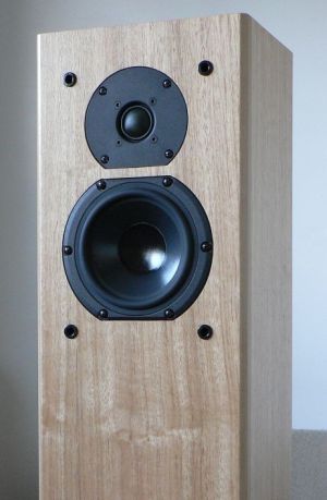

Problem with the ScanSpeak and SEAS drivers is most beginners are on a much lower budget

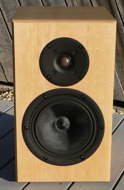

I know what you mean but there are some in their range that can be had for less than the D27TG/P13 combo such as the Discovery series. Of course there are other manufacturers and for example, my SEAS 27TFFC (old version) + Peerless 850488 which cost less, kills the above but the drivers are no longer available.
I think PeteMcK is on the right track as I recently moved to larger 6.5" woofers in a similar size box (10 litres) and just adds so much more body to the music even though the F3 is higher (F6 and F10 is much better due to the sealed loading). It uses a Peerless 810921 + Vifa XG18WH00-08 and was designed to do nearfield work and be better than a Yamaha NS10M I had years ago for this duty.
What I'm saying is, the larger woofer would allow more flexibility in the design as allows for small bookshelves as well as floorstanders which is not generally possible with 5" drivers. For example, the XG18 (now gone) can be used in 10 litres sealed (F3=66Hz) but also 22 litres vented (F3=42Hz) which means it can suit more users. I'm sure PeteMcK's suggested combo of SEAS CA18RLY + 22TFF could do that and there would be plenty of other other combinations.

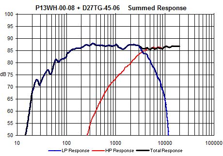

Agree. I like my main 2.5 way and other large speakers but this little speaker was a good low cost step into the hobby which was the intention. A low crossover part count (3 components in most cases) helped to keep costs down without causing too many problems with the drivers.
I haven't looked around in recent times for other drivers that would keep a design so simple. I'm sure there are plenty out there and just takes patience and modelling to find what's suitable. As I've said before, get the driver choice right and you are more than half way there. I'm sure there will be suggestions forthcoming and maybe eventually another simple design with current drivers.

A beginner project is probably much better around the 10 to 15 litre internal box volume, this is a very acceptable size for good WAF as well as needing little if any internal bracing but as Pete says it does limit you to a maximum driver size of around 150mm ( 6 inches ) and my preference for the P-13s is because they seem to have the best reproduction of the midrange/female voice and I listen to a lot of female voice on recordings.
So a driver that works well in a small box, works well either sealed or vented having a smooth roll-off so XO work is relatively simple and with enough bass to work as a 2-way and having good midrange reproduction and also affordable, what could be simpler?

As for the position of the XO point, I find it less of a problem than most people when using the better ( smoother ) drivers and I can live with crossovers anywhere in the region from 2500 to 6000Hertz, I don't think any project using anything more than second order is feasible for beginners ( which as pointed out is the whole point of this particular reference project.

I found using a coil on the P-13 that high made no difference.
just 1.2R and 4.7uF worked for me.
