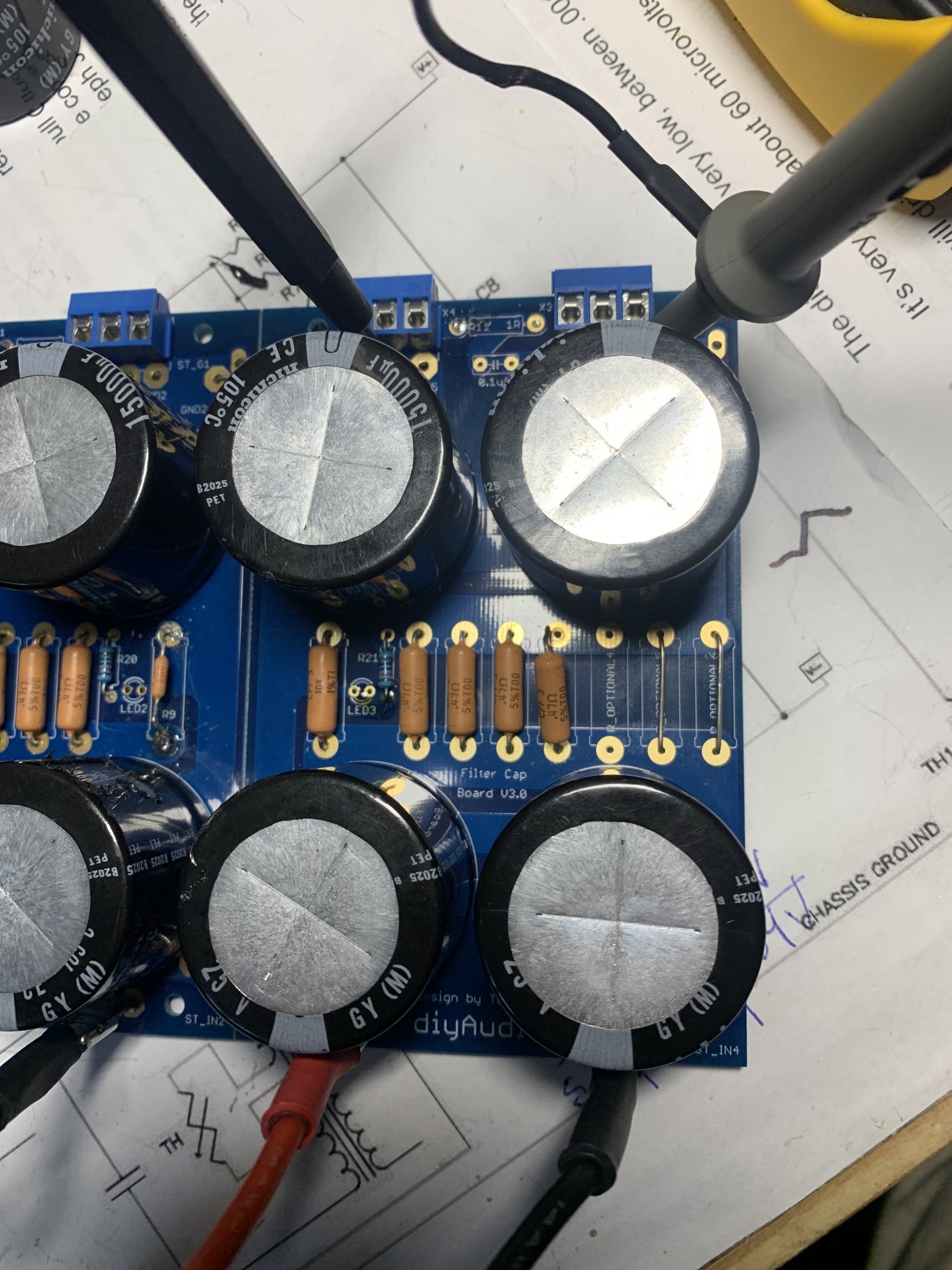

25 volts across C1 and C2 and R10 is correct.
You should have that same voltage across C5 and C6
If you really have got 25 volt DC across R1,2,3 and 4 then they are not 0.47 ohm resistors. Switch OFF, take one out and measure it. They would have to be something like 470k or 4.7meg to give that voltage across them. Anything lower would charge C5 and C6 up.

If you can measure 25 volts across any of those resistors then they can not be 0.47 ohm. Does that make sense 🙂 The current flow would be massive.
And just to be clear, when we say 'across' that means one meter lead on one end of the resistor and the other meter lead on the other end of the resistor.

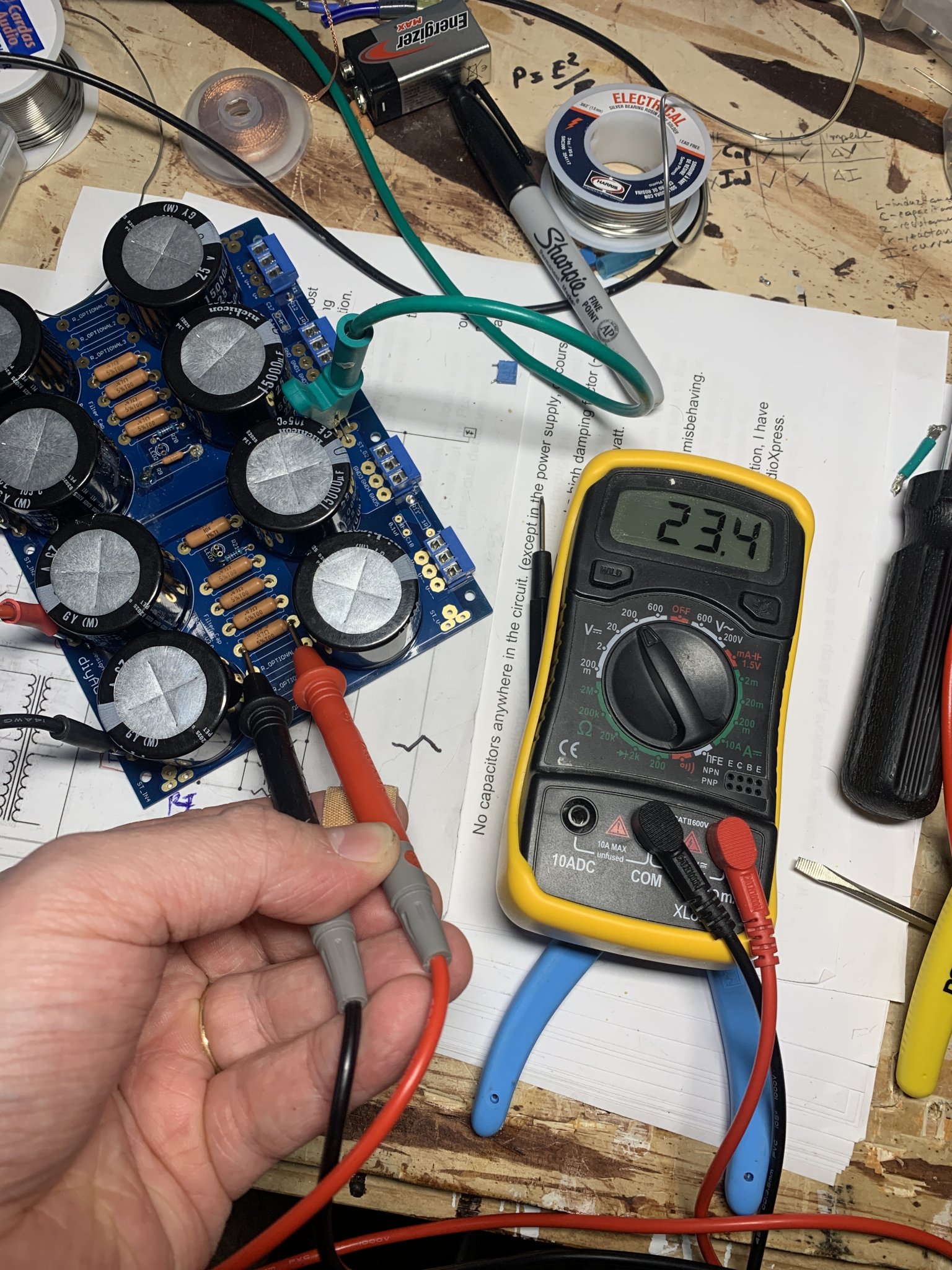

Yes the ohms law equation makes sense. And yes that’s how I was measuring them.
You need to measure the resistance for real then. Take one out that you know for sure had 25v across it and measure its value. You can just lift one end to isolate it.
Also and with the power OFF just check there are no shorts across C5 and C6. If there were then that could have popped the resistors I suppose.

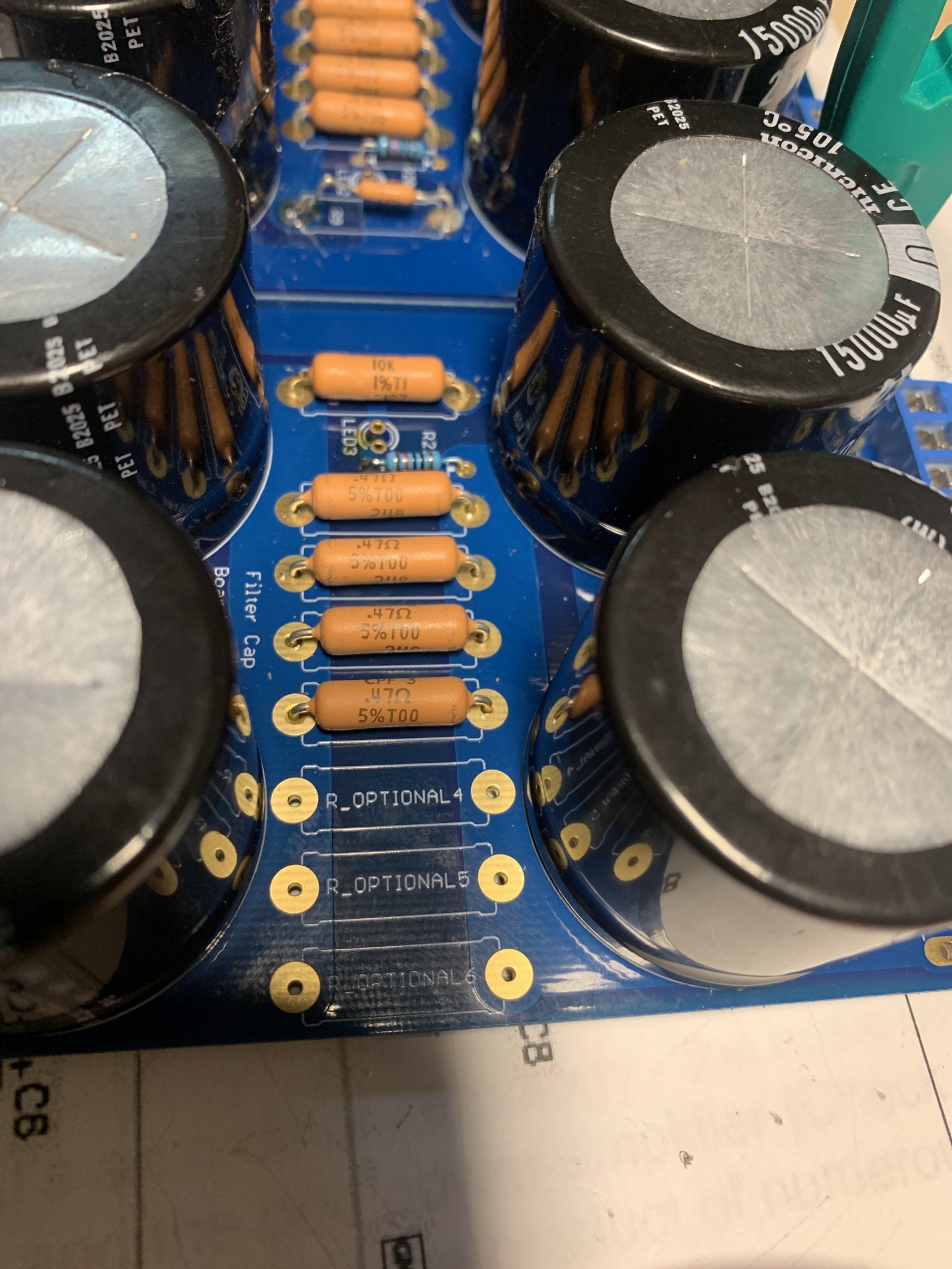

Ok got the negative rail to work!! I just shorted 2 of the unused .47R spots with wire. I’m guessing I had no continuity across the .47R path. Seems more likely that I burned them out somehow than they are all defective…

Don’t forget you have now de facto bypassed your 0R47 resistors by jumpering the R6-7 spots. I recommend you replace the defective resistors/resolder bad resistor joints, and remove the jumpers. But rereading your post it seems this is your intention anyhow 🙂

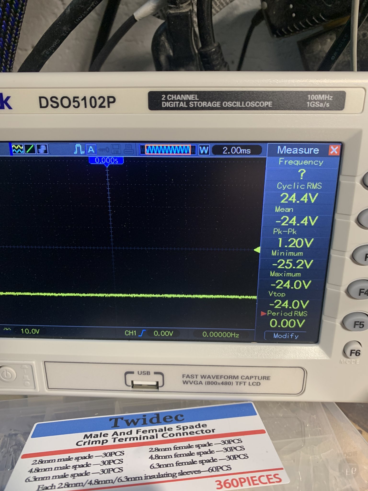

not familiar with your scope. But does it not show only 1V2 peak to peak? Cyclic RMS is 24V4. But how many volts is «normal» RMS? What does your DMM show?
Andy
DMM shows the correct 24vdc. I think the pk-pk v on scope is ripple
