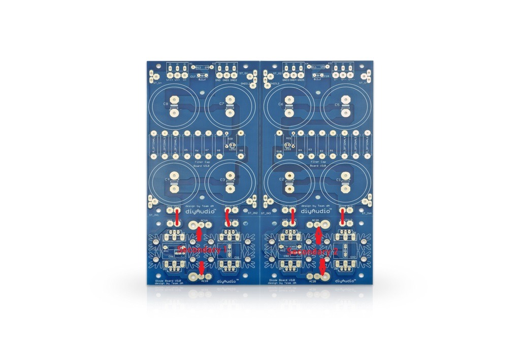

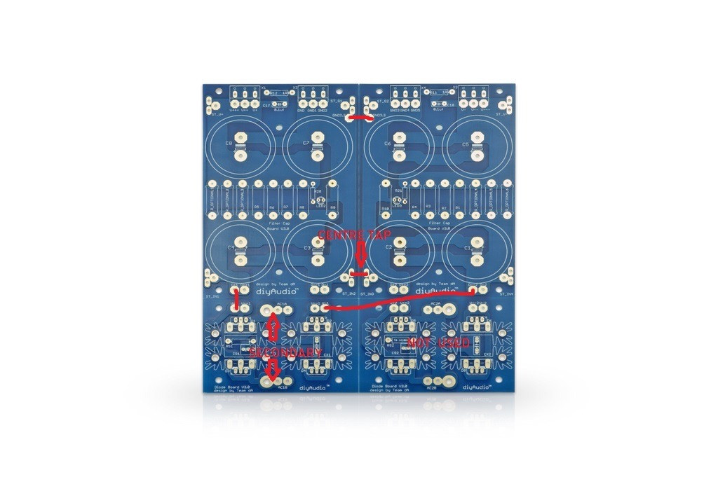

Sorry if this was already explained before, I could not find. How do you connect the transformer secondary to 1A, 1B, 2A and 2B on power supply board? I believe a transformer with symmetrical output of 17-0-17V is not useful? In the photos I see a single transformer was used Do I need 17V-0V single output? In either way how do I connect to 4 separate posts on the power board?
The centre tap of the transformer secondary goes to the ground of the board and each end of the secondary winding go to the AC input.
The V+ output of the rectifiers go to the V+ PS filter and the V- output of the rectifiers go to the V- PS filter.
Only one side of the rectifier board needs to be populated with diodes. Alternatively a bridge rectifier may be used in place of the discrete diodes and the rectifier board.
If your transformer has two identical secondary windings then both sides of the rectifier board is populated. Alternatively two bridge rectifiers may be used in place of the discrete diodes and rectifier board.

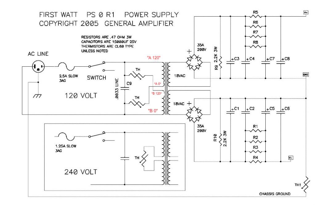

Ben Mah I greatly appreciate all detailed information and images you provided. I am building the F5 amp, so in photos in the build guide all 8 of the diodes were in use. It was not clear in the photos but I now understand that there must have been 2 separate pairs of secondary outputs (17V) in the toroid they used then. On the other hand, in a symmetrical output transformer like I have (I considered it so (17-0-17V) since I read the voltage between 17-0 leads and 0-17 leads as 17Volts each) if I take center tap for ground and use two 17V leads to connect to 1A and 1B, wouldn’t I then be feeding 34V to PS board? Once again sorry if these questions are too naive for this forum.If your transformer has two identical secondary windings then both sides of the rectifier board is populated. Alternatively two bridge rectifiers may be used in place of the discrete diodes and rectifier board.

Wonderful! You are well on your way. All (well most) First Watt clones can utilize the same power supply. Yes, there are endless options, but my personal recommendation for a person in your shoes is to build one based upon the one that Nelson Pass uses in the commercial products. The link above is (IMO) a really fantastic way to get a basic understanding of the PSU and get it built up and ready for your F6. You can simply ignore the sections on the amplifier itself. If you've got any questions re: the F6 build itself, there's a dedicated thread. As you may have noticed, the threads can get a bit lengthy. For the F6 in particular, there are (what I'd consider) a few very simple changes (6L6 mentions at least two of them in the guide) along with a simple modification (using some LEDs in a novel application) that don't make the build any more challenging for a beginning builder, but can make your life a bit easier long term. Once you're ready to get going on that side of things post any questions over in that thread.

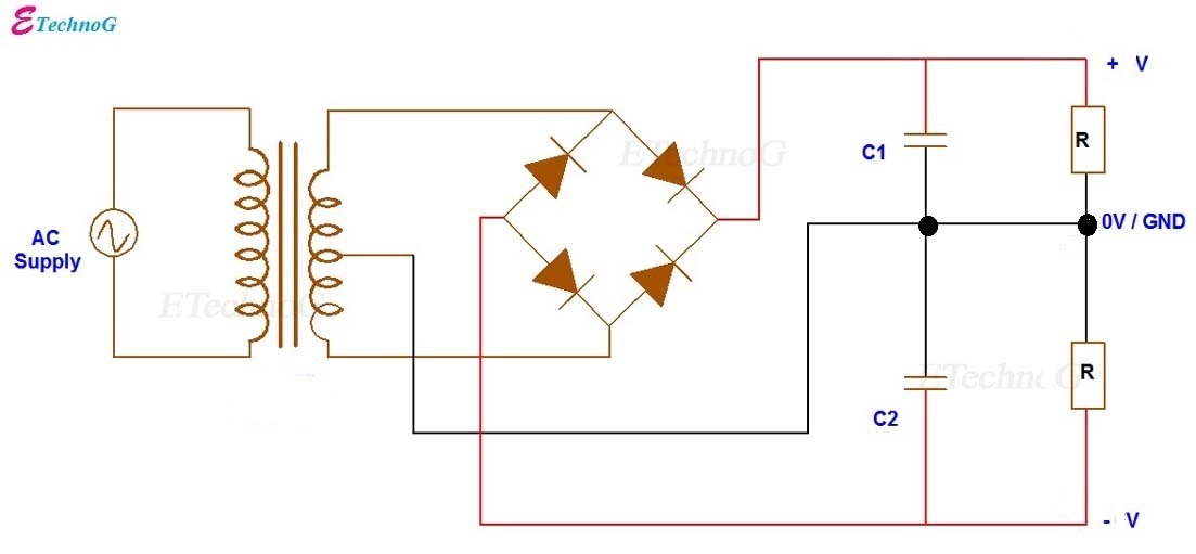

To clarify, can I use the store boards for two single-rail supplies? I am looking for PCB options to add capacitance after a +27VDC SMPS for LuFo monoblock builds.
Ground is relative... and also where you decide it to be.
So if you were to split the PCB and make two single-rail supplies, stuff everything as labeled, but attach the output "backwards" -- what's marked as GND will be V+ and what's marked as V- will be GND.
If you stuff as labeled the lower voltage will be on the V- marked output pad and the higher voltage will be on the GND pad. (This is also true when it's a bipolar PSU...)
Your lower voltage you will call GND, and the higher voltage will be called V+ .
