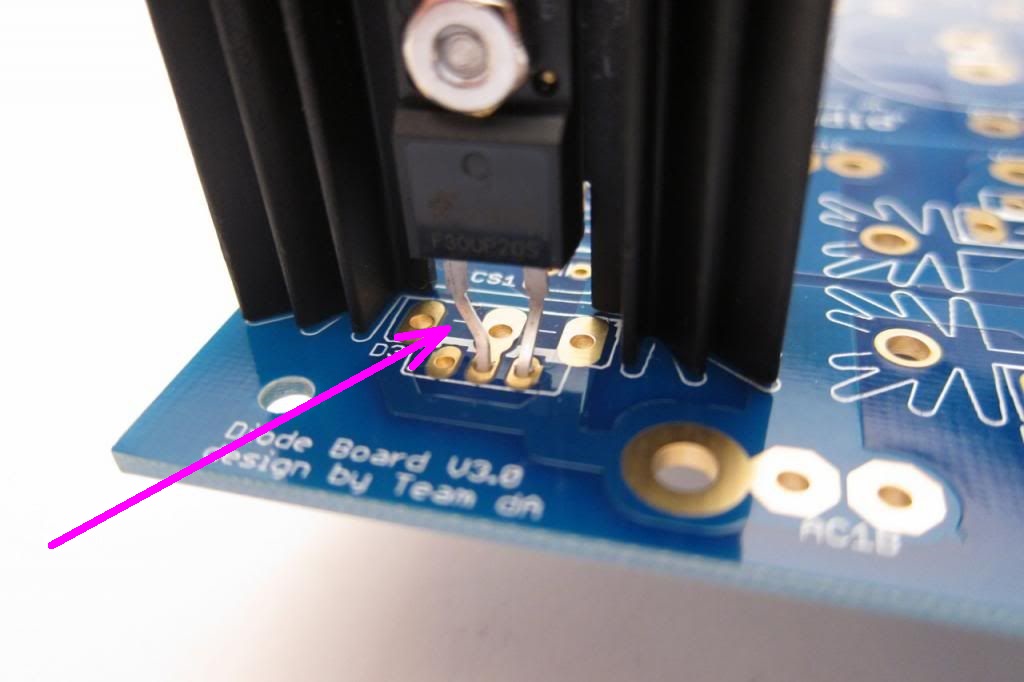

Before I place my order for PSU diodes I would appreciate some advice about their spec. A 30A 200V minimum diode is recommended which is the part specified in the build guide BOM.
Q1. Regarding minimum: Is that a 30A min, a 200V min or and combined 30A/200V min?
Q2. Does that minimum mean that I would be better off going for a 40A/350V diode such as the Fairchild FFA40UP35STU (mouser part: 512-FFA40UP35STU) or will I be fine, if not optimum, with the part in the BOM?
If you buy the MBR40250T Mouser link you'll get three benefits:
1. High cost ($1.62 per diode), which confers the bragging rights to proclaim you used Premium Parts
2. Even larger safety margin: 40 amps (not 30) and 250 volts (not 200)
3. TO-220-3 package, the one with three legs not two. Now your diode legs won't have the unsightly bend shown in the photos of the Universal PSU board
