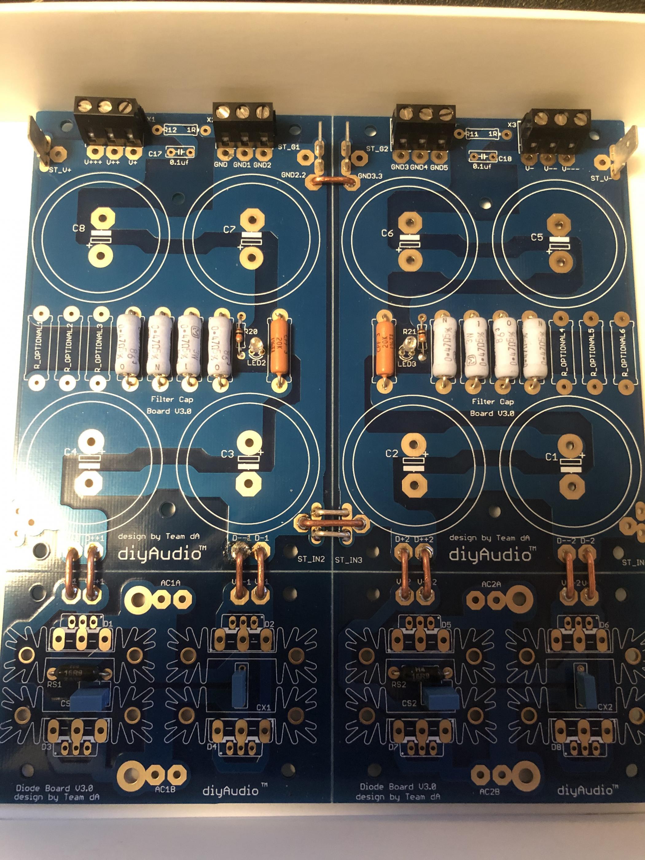

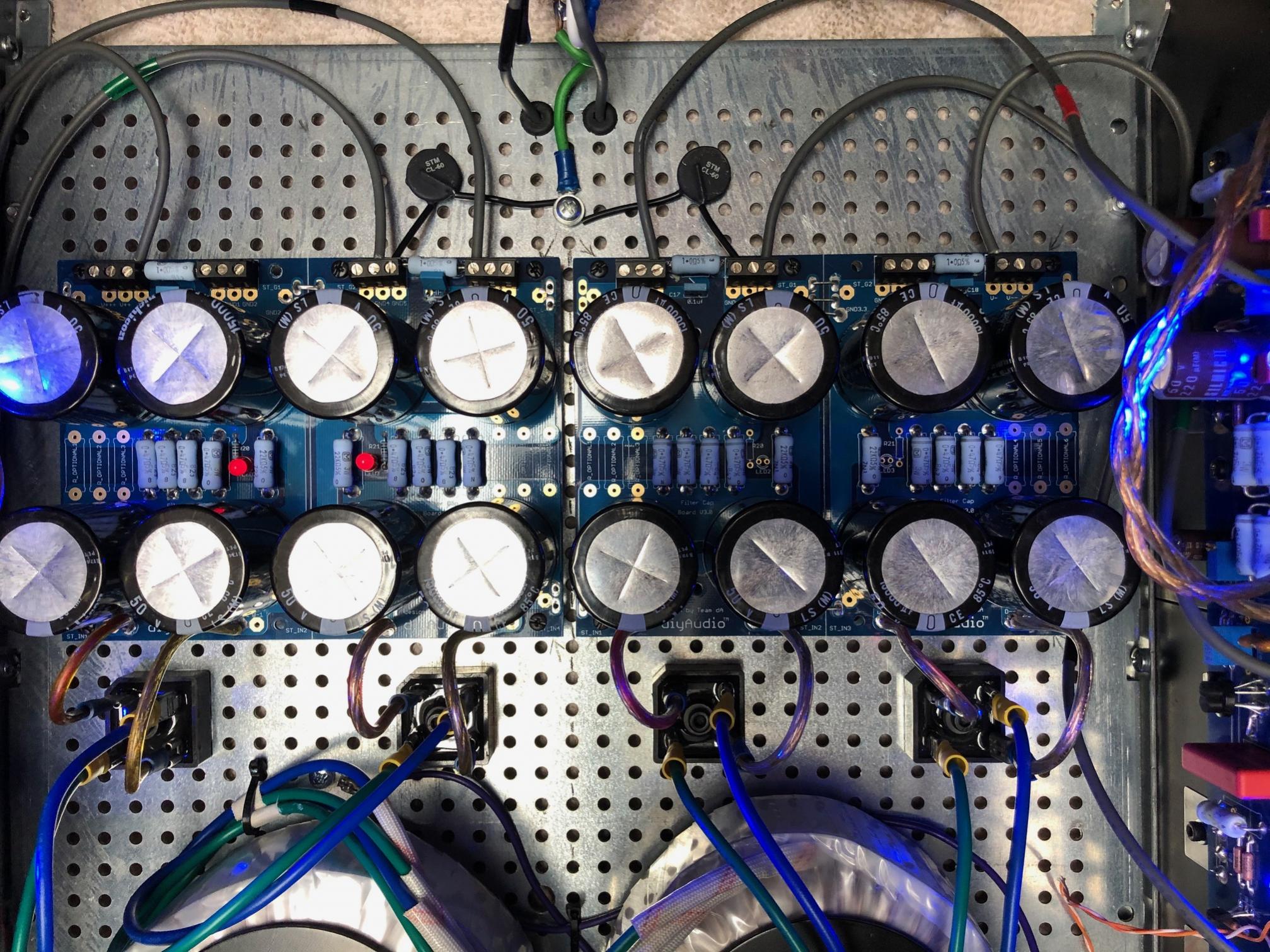

Completed testing and reset of bias voltages and DC offset after conversion from single 400VA transformer/PS board to dual mono 2x200VA transformers and addition of 2nd PS board yesterday.
Everything fit into the 5U chassis quite nicely. Didn't have to do a bit of tapping, only drilling was for the grommets in the holey base plate.
Mains voltage is nominally 245VAC.
Amp boards are Aleph J.
Got the 1rst listen in last night and I was stunned by the improvement in SQ.
Listened to 6 CD's, stopped at midnight 'cuz I couldn't keep my eyes open any longer.
Will get some more time in before trying to describe in greater detail the difference PS mod has made, over in the Aleph J thread.
For now, I mainly wanted to illustrate how well the diyAudio store components mesh together.

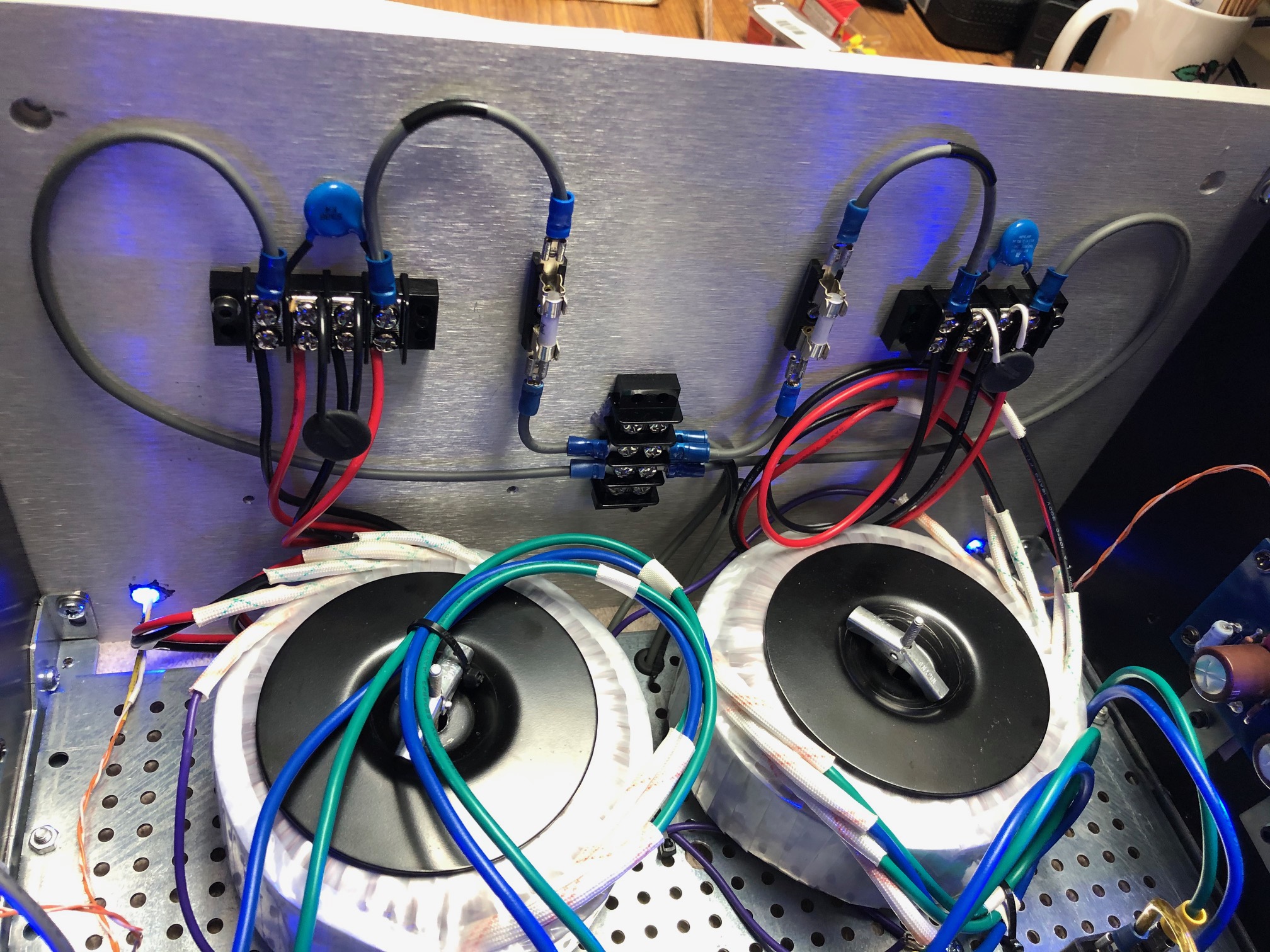

Input and output snubbers - do you mean snubbers between the rectifiers and the first capacitors and snubbers after the final capacitors? If yes, then most diyAudio First Watt amplifier builders do not put them in their supplies. Note that the typical First Watt power supply does not include those snubbers.
As for the Quasimodo derived snubber between the transformer secondary and rectifiers, many builders, me included, do put those in. The values that you noted agree with the values shown here Quasimodo results (ONLY) in post #17. Mark Johnson recommends Epcos B32529 series metallized film capacitors and 0.5W metal film resistors.

The high-quality Polyethylene Terephthalate (PET) capacitors are for the Qausimodo (snubber capacitors)
The safety capacitor goes across the primary. Its value can be anywhere between 0.1 and 0.033uF, but it must be safety rated, at 250V AC.
"Safety Rated" = the capacitor can not become a short, it will ALWAYS lose the capacitance in case of overheating, i.e. the metalized polyester film will start developing little holes in a metallised film - therefore losing its capacitance and “self-healing” in a way that it will cool itself by losing capacitance & reducing its current, until two things happen:
the capacitance goes to almost zero

Hi rsaurmure,
What Extreme_Boky said.
The safely capacitor is shown on the power supply schematic connected across the power transformer primary.
If it fails, it will fail "open", not as a short as some non-safety rated capacitors may do. Failing as a short in this location is not safe as it will short circuit the AC power from your wall socket. Failing "open" means it will fail by opening and taking itself out of the circuit so electrically, it no longer exists.

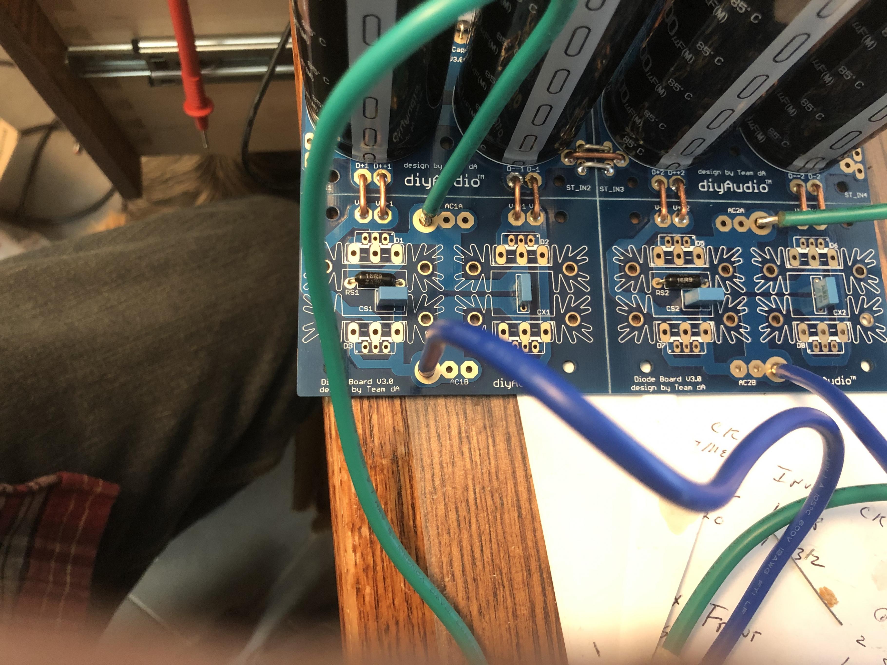

So I have been soldering away in my spare time.
Stuffed all the small components in the board, (yes I did clean up the flux) and have the capacitors in.
I am using the Antek 4218 and have a question about connecting the secondaries to the board. Does the wiring in the attached picture look correct or do the green and blue wires on one side of the board need to be reversed?
Should it be:
AC1A green from 1st secondary
AC1B blue from 1st secondary
AC2A green from 2nd secondary
AC2B blue from 2nd secondary
or
AC2A blue from 2nd secondary
AC2B green from 2nd secondary

@rsaumure - your secondaries are good per your last pic.
Edited to add for clarity - Either way you noted would work fine.
Thanks, I am still trying to get my head around + rails and - rails. It just seems to me that you have a circuit - one side is positive and the other is negative.
Well, I'm still a bit new to all this still too, but in essence, the secondaries are just the reduced AC voltage from the transformer. In this case 18VAC or so down from 110VAC or so from your wall. There is no + or - on the AC side prior to rectification. Once you've got your lovely clean 24VDC or so out of the beautiful PSU you're building (the V+ and V-), you'll really need to pay attention.
