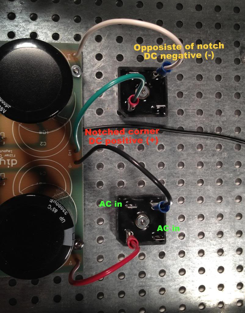

I have read and re-read this (entire) forum, but cannot definitively tell exactly how to connect the 18V AC leads from my transformer to the PSUv3 board using the diode rectifier bridge. I've posted a photo of my current build below -- and indicted what I *think* I understand about how this should be connected to the 18V AC input. I know this is a trivial question and one I should be able to figure out (or infer) but I simply don't feel confident that I'm understanding this correctly. Thank you in advance!
Did you get any answer on this issue? I have the same problem :-((.

Is this correct

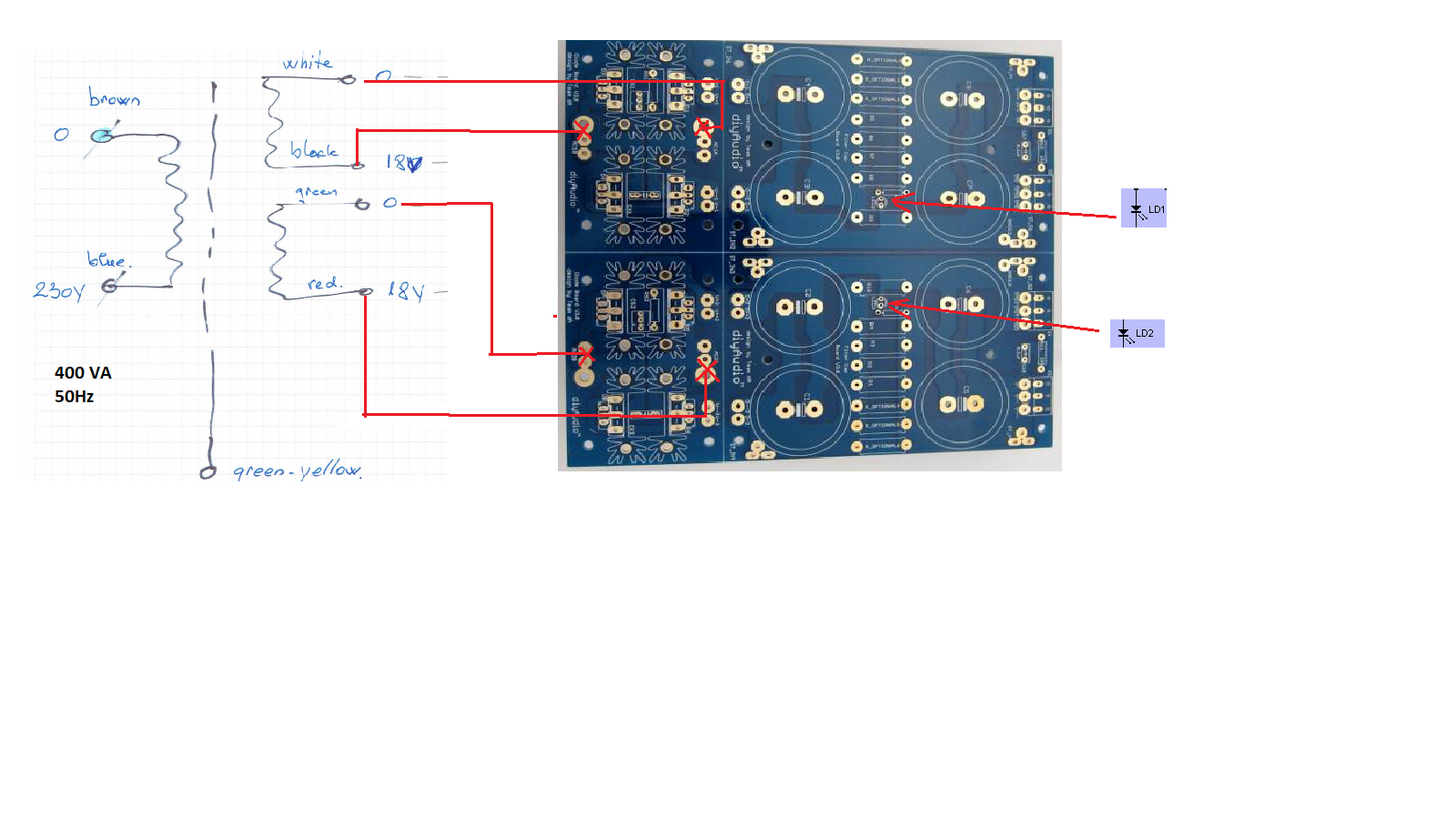

Good evening,
I'm building an F6 , I have a 400VA ,230 V transformer and I would like to be sure if the connections presented in the attached picture (transformer to PSU board) are done right. Also if the 2 LEDs are installed with the right orientation.
Thank you
Regards
Thank you
Regards
25A 200V, or 35A 200V
going to 400V does no harm.
