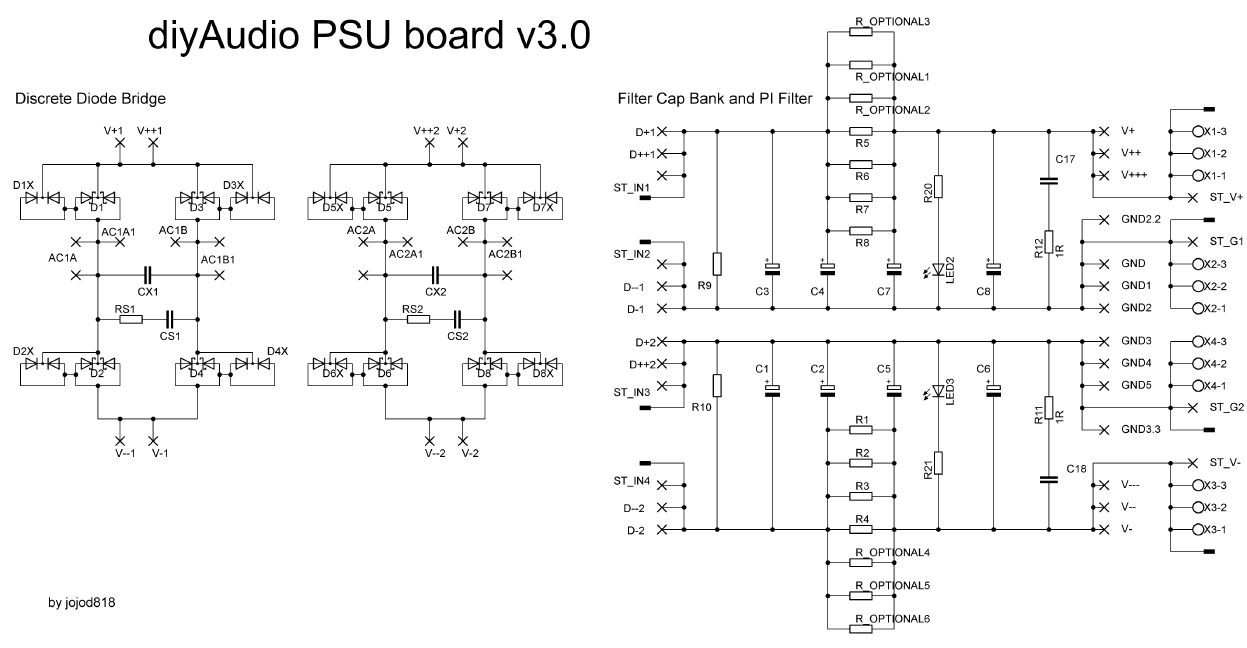

Andrew, looking at the schematic for PSU v3, what qualifies as a load, across which to locate the spark suppression cap?
Do CX1 and RS1 (in the snubber circuit) perform any kind of spark suppression?

I don't agree with the way both those diagrams are wired.
I think the top one should have the fuse before the switch.
The bottom one has no convenient location to place the snubber across the load. that is because the fuse is on the wrong side of the switch.
You could place the snubber across the Neutral and Live of the switch, but the fuse if or when it ruptures breaks the connection.
If the Live goes to Fuse first and then goes down to the switch, then a snubber across the L & N, on the load side, of the switch is effectively across the load even if the fuse ruptures. Opening the switch, or rupturing the fuse, now activates the snubber action.

1) What do the the PI resistors do, and how would I select the correct amount for my application? (Driving 2 Honey Badgers)
2) Would I omit C17-18(output snubbers) if I don't plan on using input snubbers?
3) I was gonna use YAGEO 10K, 1/2W, 1% Metal film resistors that I have on order for R20, and R21. I imagine that this would be suitable?

A normal capacitor input filter using an electrolytic just after the rectifier is actually and rC filter.
The "r" of rC is the resistance of the circuit through the transformer and through the rectifier and all the wiring linking those to the capacitor, including the capacitor leads and it's own internal connections.
If you add on an extra filter stage you end up with rCRC where the "R" is the resistance of the wiring connecting the two capacitors and any resistor value you put into that wiring.
The CRC part is a Pi filter
But don't exclude the r. It is what creates the first filter.

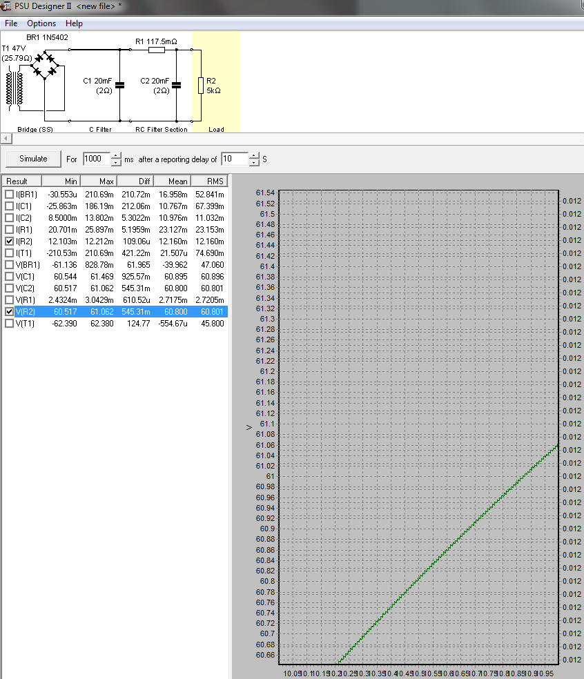

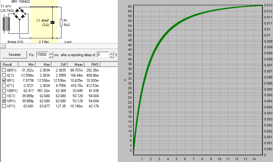

I was playing around in PSUD2, just for better understanding. I had to make a couple assumptions that I'm sure are not accurate, but should allow me to see the effect of the second RC. I kept the load at 5k (I do not know the actual load, but the effect should be the same regardless). These sims don't factor the bleed resistors, just the rCRC vs rC into a 5k load. The rCRC shows much less ripple using the 4 suggested 0R47 3W "PI Resistors", and 40kuF per rail. Does this seem like a reasonable simulation?

The results include the starting variations of voltage and current.
Ask the sim to start after a delay.
Try 10seconds delay, then 1second of display.

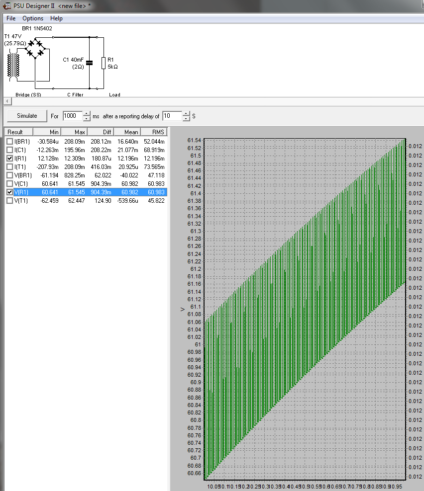

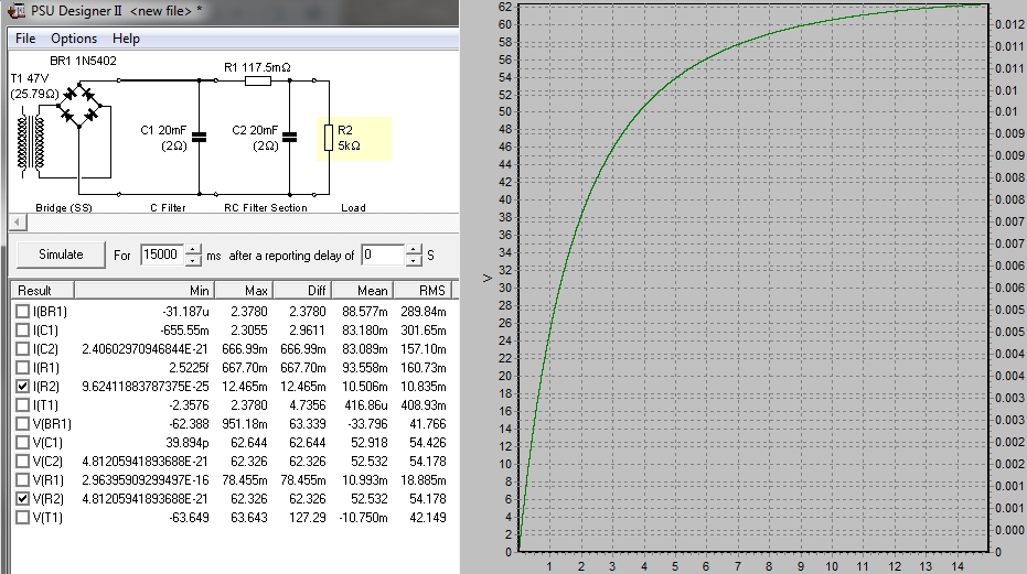

Using 47V Secondaries into 40kuF per rail; 10s delay; 1 Sec of display:
rC Vs. rCRC: The rCRC appears to reduce the ripple to approx. 60% of the original .9V ripple down to .5V ripple.
This would lead me to believe that using the suggested 4 x 0R47 3W resister(as simulated-except the false load) per rail would be a good improvement in this situation. Does that sound like a fair statement?
EDIT:
I mentioned ripple. I may have mis-spoken. The "swing" is what I should have said. The ripple in the 2nd graph is less than .02V
