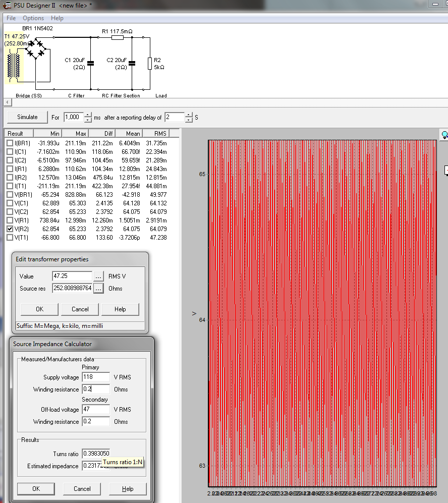

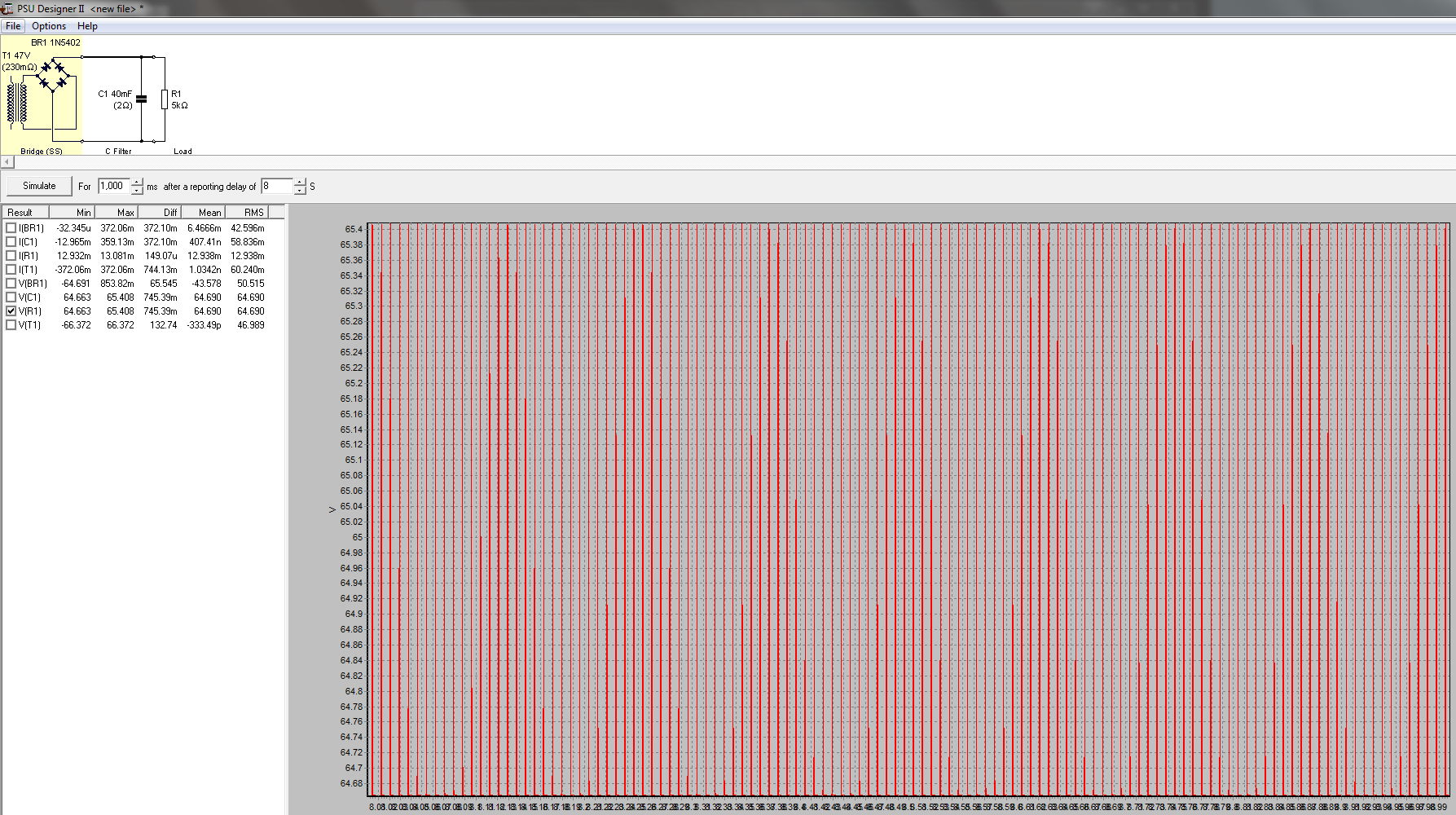

You need to change the transformer.
His default is basically suitable for driving a valve amplifier.
Then it should settle much more quickly and the 10second delay should work. It might even work with a 2second delay.
It stabilizes almost instantly. the "swing" or difference is less significant now.
rC = 2.405 VS rCRC= 2.379 .
Note: It is approx 2.5 V however.
Ignore that, the values changed from 20mF to 20uF

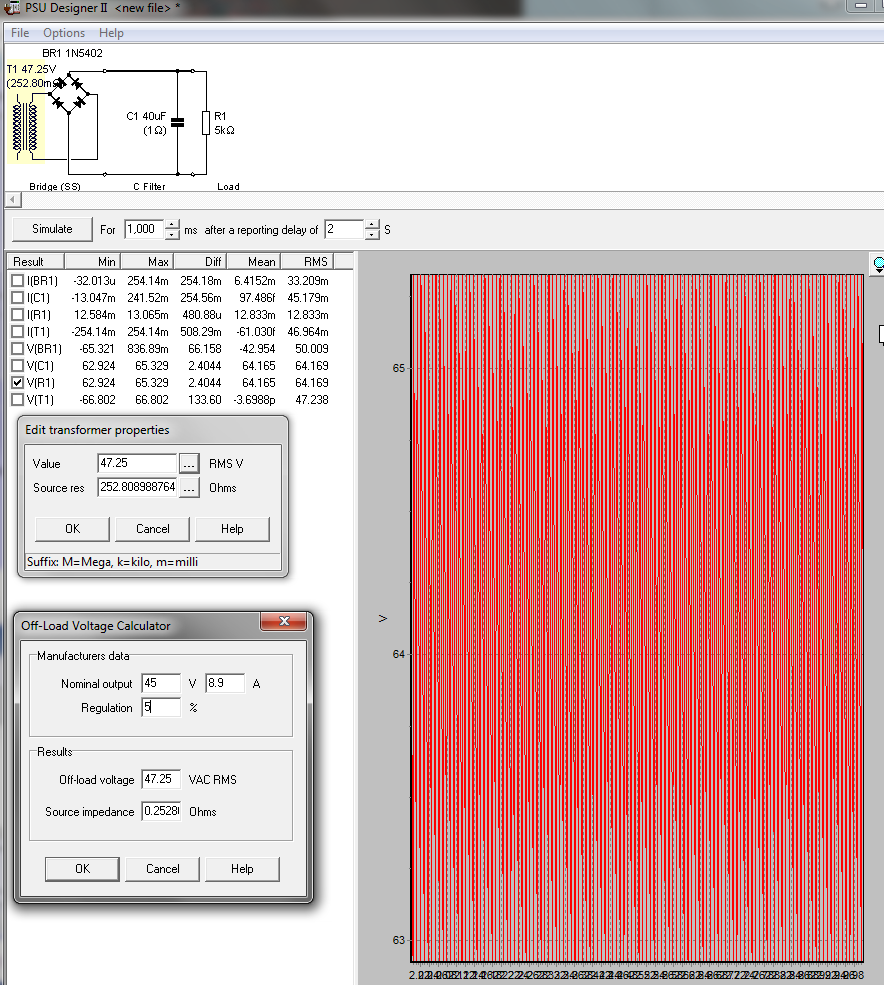

Do you mean the transformer settings (Ex: winding R, voltage, etc?) or is there a way to actually change the transformer to a different type (ex:toroidal)
If the former; than I get 0.7V ripple down to 0.02V by going from rC to rCRC
The transformer parameters might be OK, I see 230mohms. That is maybe a bit low.
the 2r for C1 is too high, 20mohms is probably nearer.
reduce sample time to 200ms.
reduce R2 to 8r to represent the load presented by the speaker when driven to max power.

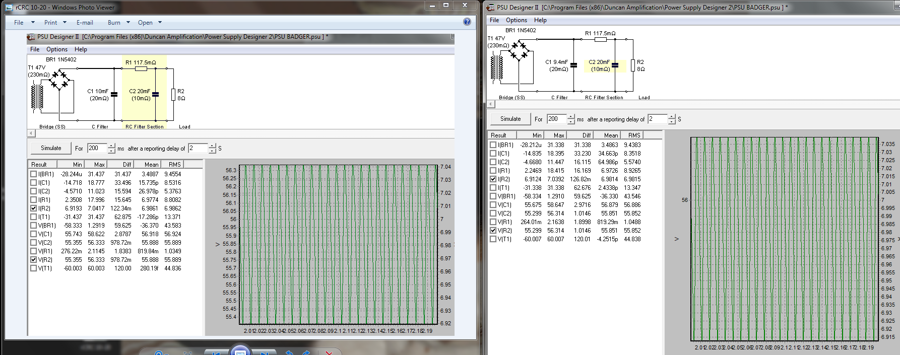

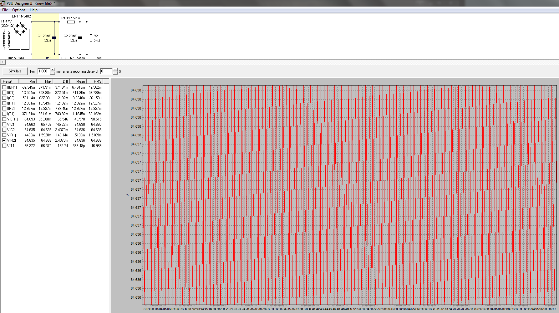

The voltage is higher in the rC compared to the rCRC (which makes sense). Although I expected it to be much higher for both.
If I look at the same simulations without the reporting delay (ex: 0), I can see the sharp saw tooth peaks begin to round out via the change from rC to rCRC. Both systems stabilize within the first second or less.
NOTE: with 0 sec reporting delay, and with "softstart" selected "OFF", it warns that that the maximum 99A was exceeded @ .184 sec. This is fixed by using softstart... Although the graphs don't show any exceeding parameters.

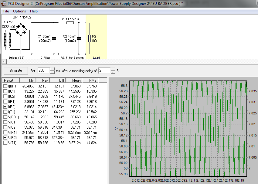

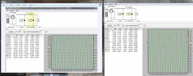

Note:
Ic1rms and Ic2rms.
The ripple capacity of the first capacitor needs to be much higher for an rCRC filter.
Maximum power in R1 is ~6.3W if you can sustain that current continuously. The duty factor is ~50%. But max power is only delivered during dummy load testing, not during music/audio reproduction.
Ripple rC = 1.38Vpp and for rCRC 0.56Vpp That's a 7.8dB reduction in mains ripple.
But you have reduced the capacitance directly attached to the amplifier from 40mF to 20mF. The amp sees a higher source impedance for the rCRC and thus does not quite perform as well for locally generated rail ripple.
You could try pricing a pair of 4700uF, or 5off 2200uF, instead of a singleton 20mF. See how they compare for ripple capacity and for ripple reduction.
Ic1rms and Ic2rms.

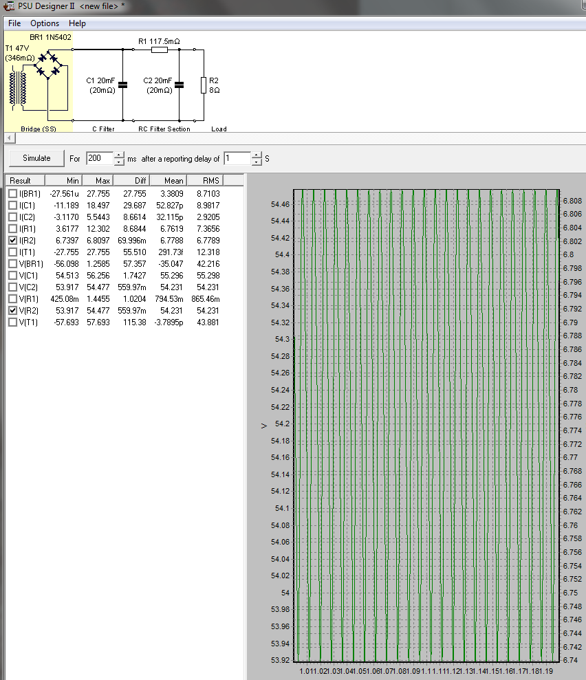

Thank for the info! The reason I was sticking with 40,000uF per rail was because of OS's recommendation in the build guide. He may have been using an rC though, he referenced an earlier PSU (V2).
I wish I had the proper background to make these kinds of decisions better! I'm slowly trucking along though, so any progress is good progress now 🙂
Note:
do you mean to keep the C1 @ 20kuF, and parallel a pair of 4700uF or 5(2200uF) or C2?
I've been playing with R1 as well, and in order to reach the target Voltages, it apperas that less R = better results (closer to 65V; which makes sense)
EDIT: I guess I would have to combine C2 and C3 into C2 if this is the case. PSUD2 doesn't allow for separate C filter sections after the initial one.
Since the last C is what the amplifier/Load sees directly and any previous C is isolated from the load by the R, then reducing the last C reduces the performance of the amplifier.
So any experimentation in the simulator is with respect to altering C1 to see if money or space could be saved without significant reduction in performance.
So I suggested 40mF for last C to match the rC version and suggest reducing first C to half value, i.e. 20mF. Try that.
Then try 10mF for C1 and 20mF for C2 and see what you lose compared to 20mF and 40mF for the rC versions.
Finally to get a high ripple capacity it is generally much cheaper to use multiple small caps for C1 rather than a big expensive high ripple capacity singleton.
That's where the 2*4700uF (=9400uF), or 5off 2200uF (=11mF) came into the equation/simulation.

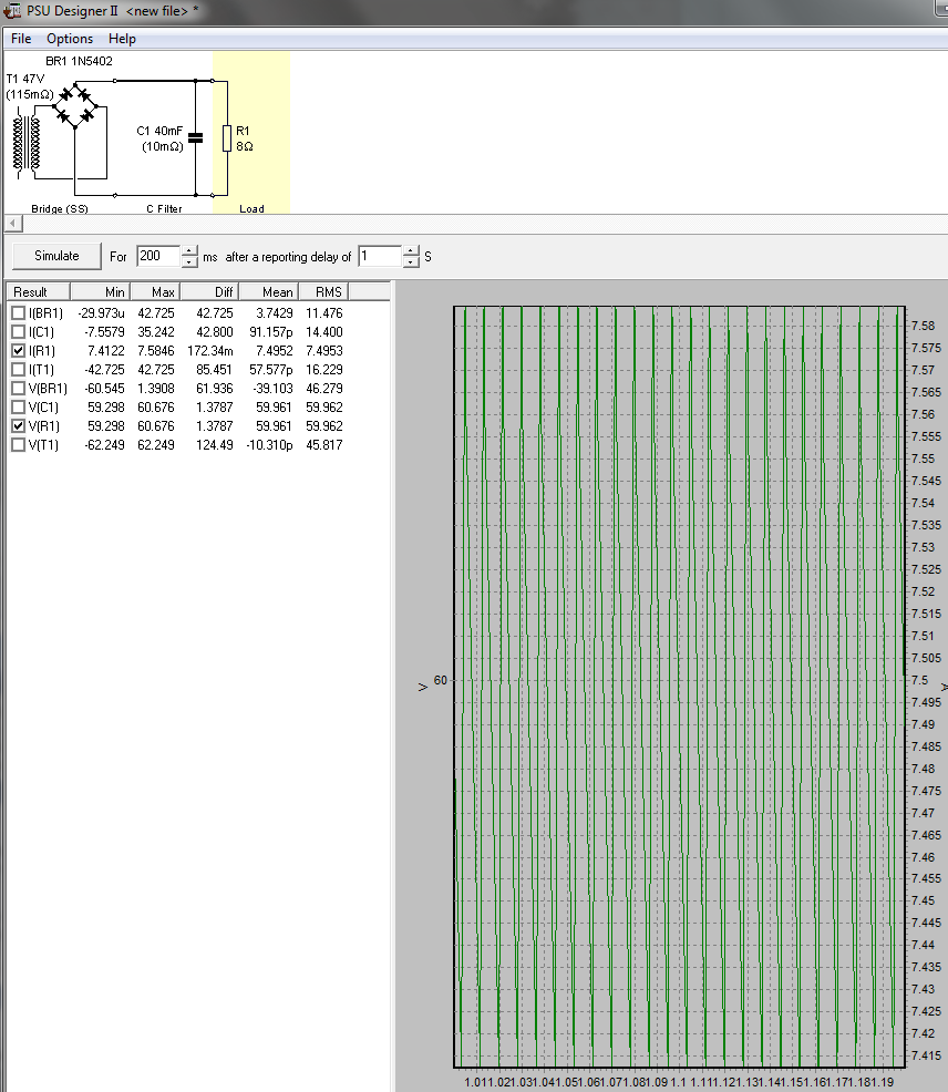

You are looking at volts and currents and ripple while the load is pulling 7A continuously...............If the above is all true, the simulated rail voltages would be approx +/- 56V which is approx 7-10 V lower than originally expected
Try reducing the load to 1A and/or 500mA to see what it looks like when the amplifier is ticking along producing audio @ -20dB relative to maximum.
Good Point, I was stuck on "worst case" thinking. Kind of missed the big picture.
I assume this would be as simple as increasing the speaker load(R) until I get a draw of 500mA to 1A? I will play around with some examples in PSUD2 later(when I have PC access again).
I really like being able to see the chages in PSUD2, and how they affect the various components (Ex: increasing V @ C1, etc.). One of these days I'll try to figure out spice as well 🙂 .
