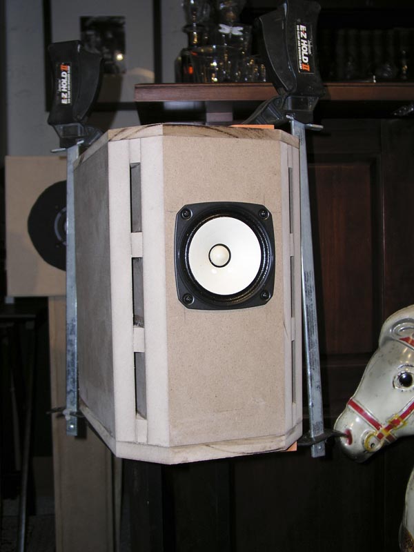

I heard Dave's pair at the last RAW event, and I thought that they were perhaps the best allround speakers there (with the exception of mine, of course! :^)
I think that you will be more than a little pleased with the end result, the only problem with the Fonkens is, IMHO, where do you go from there? It's something like Alexander's complaint that his father had been so successful that there wouldn't be any kingdoms left to conquer.
The use of 3/4 inch for the side panels is perhaps overkill, but it shouldn't cause any negative contributions, and it may help. I'm prone to heavy construction myself and would have done the same thing.
What are your plans for finishing them? They look pretty darn nice, I wish my efforts turned out as well as yours have.

Chris routes the back edges off at 45 degrees all the way round on ours (we are using plywood thou)....

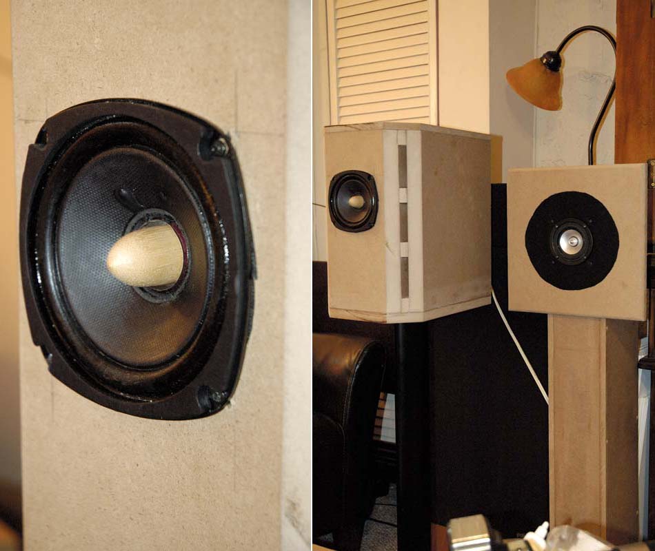

As i privately noted to Terry earlier, treating the FE127 cones turned -- IMHO -- the Fonkens from good to spectacular... speaking of which time to get the protos back from Chris.
It will be interesting to see how the MDF does...
For reference we get the 45 on the front ports by running the whole box thru the table saw after the box is built.
dave

As backwards as it sounds. I didn't actually do that. I cut and glued mine at 45. Probably much much easier your way. I don't know why I did that. It's funny. I thought of that after they were built saying to myself "Tom, why didn't you just glue them flat and cut the bevel on the front on the saw. Ah well. On the next pair (if I like these), which of course will be baltic birch. Then I can compare the differences.
On a slightly different note. These things are a tedious trial to glue up. The ports are quite the pain if you are only working with 6 clamps. I need to get more clamps.

Well, I got them running (with the wrong driver). I must say though, even with the fe126e in them, they sound very good. Not alot of bass, but enough to listen to until I buy the 127's Here it is with the drivers installed (And clamped closed). I love the sound. It certainly has a certain kind of character to it! Sure am glad I built these on a whim.

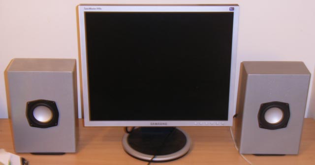

Hey everyone, I've just finished my computer speakers, using the Aura NS3 drivers, simple 3 litre sealed enclosure, painted silver to match the screen, and a picture of my gainclone amp, all in all an awesome setup, and enough bass for me for sure!
Cheers
Andrew
