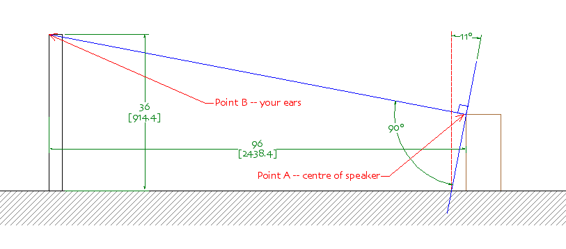

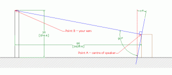

127 Bi -pole wedge plans
This is my first post here - a great site and great thread for a nonvice such as myself.
Basically I'm interested in doing a wedge or slanted bi-pole similar to what SCD did:
http://www.diyaudio.com/forums/showthread.php?s=&threadid=46934&perpage=10&pagenumber=45
How would I go about getting the dimensions?
Thanks in advance.

Re: 127 Bi -pole wedge plans
The amount of lean-back is dependent on the listening height of your ears, the distance you are from the speakers, and the height of the driver above the floor.
In the example below, lets 1st assume we want to be on axis (sometimes off axis is good to tame a rising hi-end), that the listening distance is 8 ft, your ears are 36" above the floor and the driver centre is 17 1/2" up (i've added a 3/4" base to keep the speaker from tipping).
Draw a line from Point A (speaker) to point B (your ears). A perpendicular to this line is the slope of the front baffle.
Note that a higher stand (for instance required if you port out the bottom) will mean less lean-back.
dave
jrosenth said:How would I go about getting the dimensions?
dave
