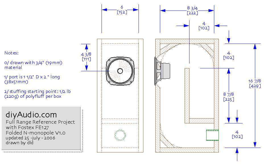

stelleg151 said:If that unclear, Im referring to the board that the arrow is pointing to.
For clarity there should be some more dimensions... i've added them in an updated drawing which i'm now referring to as V1.0.
Some recent experiments show that the design is very tolerant of changes towards larger cross-section.

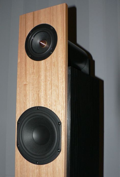

FR125S + Peerless 830875
Not quite a fullrange.... more fullrange with help..... but a use for some FR125S drivers I had and partnered with some Peerless 830875 Nomex woofers. Been a fun project and ended up a smooth laid back speaker.

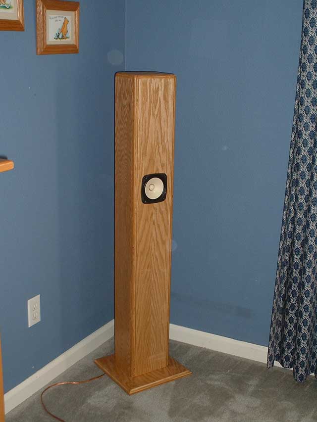

Im feeling like my folded monopoles arent really putting out as much in the lower midrange as I had hoped. It just seems that in comparison to many speakers near the same size they just arent filling the room nearly as well.
Granted they only have about 50 hours on them, and they already sound better than they did at first, but I am not optimistic that they will eventually fill the room a lot better.
One thing that was suprising to me was how much stuffing I was putting in. I put in the recommended 1/2 a pound for each cabinet, and it was packed in there pretty tight by the time I was done. Could it be that its so tight that it is muffling the lower mids?
Im being overly nitpicky here, I really do like the sound, and will eventually combine them with a sub, but I feel like the 200-600hz range is just a tad weak.

A few ideas:
If you're listening to them mounted on the floor as shown, try tilting them up between 5-8 degrees, or mounting on simple stand 12-14" off floor.
Hate to ask the obvious, but have you checked phasing on internal connections and speaker wiring? As recently as last weekend I made the same mistake when moving things from one end of a room to the other.
Assuming you can get at all the stuffing locations in the box, try pulling at least half out, and then play up & down from there.
I'm a firm believer that after all the math is said & done, it's still up to your ears to tell you what sounds right.
I'm familiar enough with the performance of this design to know that filling even a moderate sized open space room shouldn't be a problem, except for the bottom octave or so.

Heh Im pretty sure I got the phase right, but Ill just switch em to make sure.
I worry a little about unscrewing the driver again, as I have already unscrewed it and rescrewed it once, to put the grills on.
As for tilting them up, I now have them in a different setup in my bedroom on a desk, about 8 inches from the wall.and its not that they dont fill the room, its just they fill it with their beautiful mids and highs and not so much else. 😉

I think i mentioned it before, but it is worth rpeating. A significant improvement in the FE127 (&126) can be had by modifying them (if i do say so myself).
It is quite hard to get a good pic...
These mods are a direct result of comments Mark MacKenzie made earlier on in this thread crossed with my 30 years of experience modding drivers. More info on my planet10-hifi site (including a link to the FR Forum where i posted early results). I will be getting up a more detailed how-to on my website, but that is just one of many tasks in my queue.
