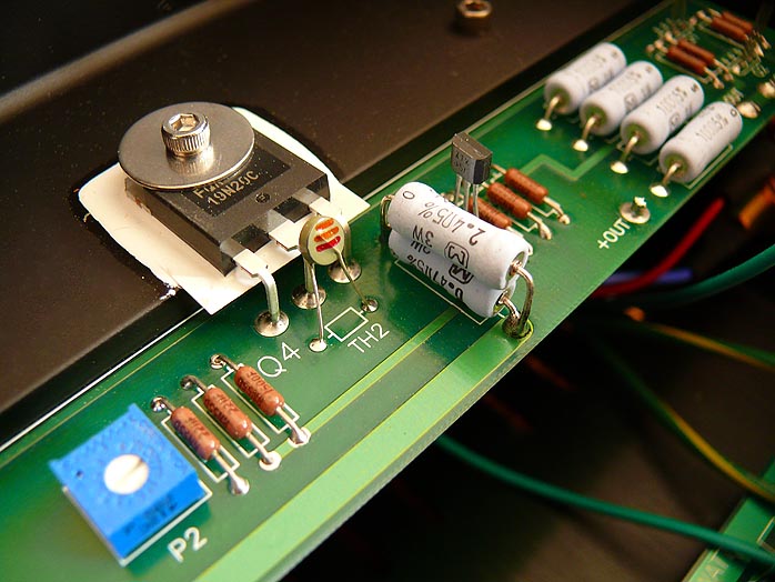

I have one question, why original amp have 2,4ohm resitor with 0,47ohm resistor ?
