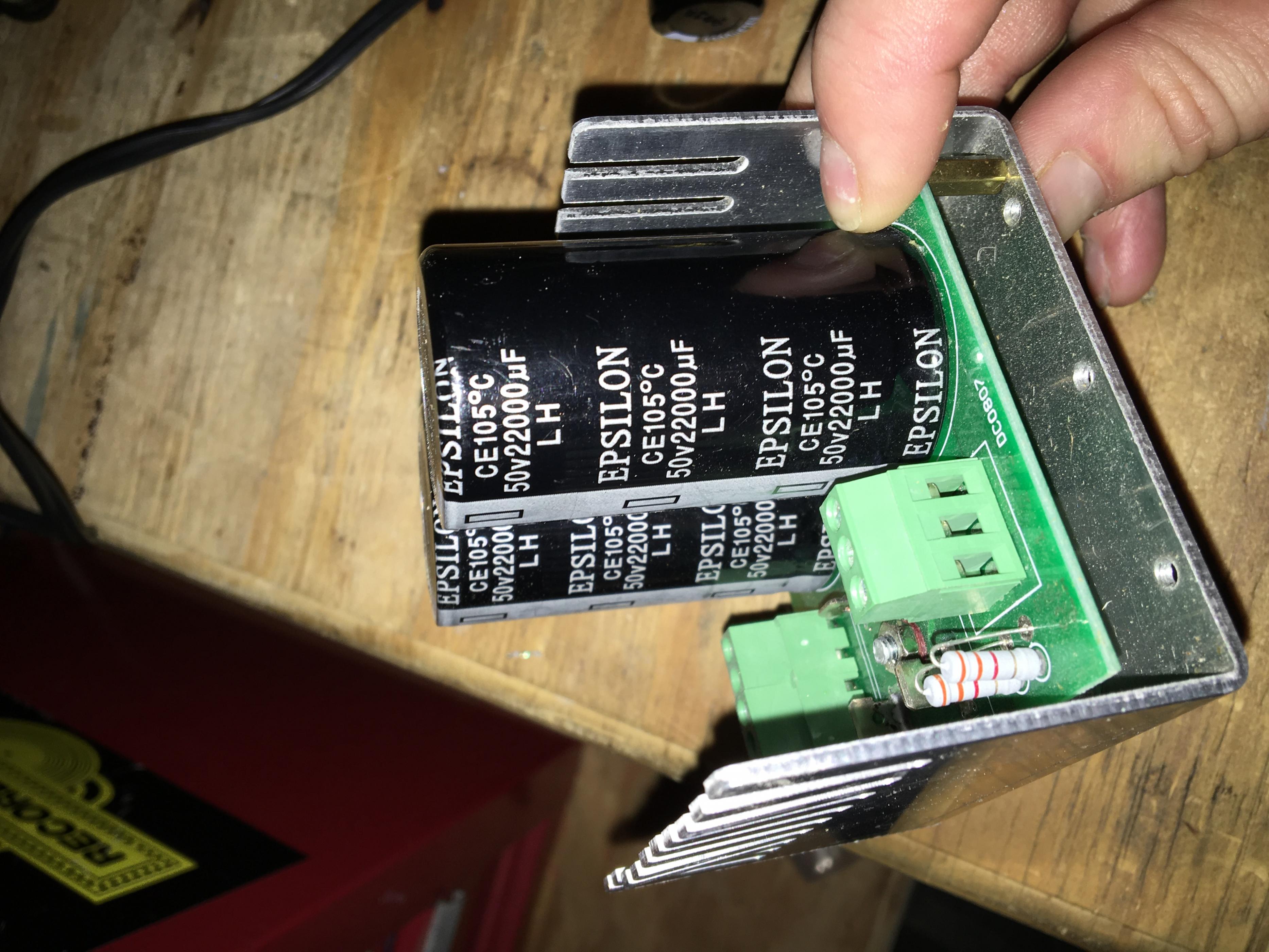

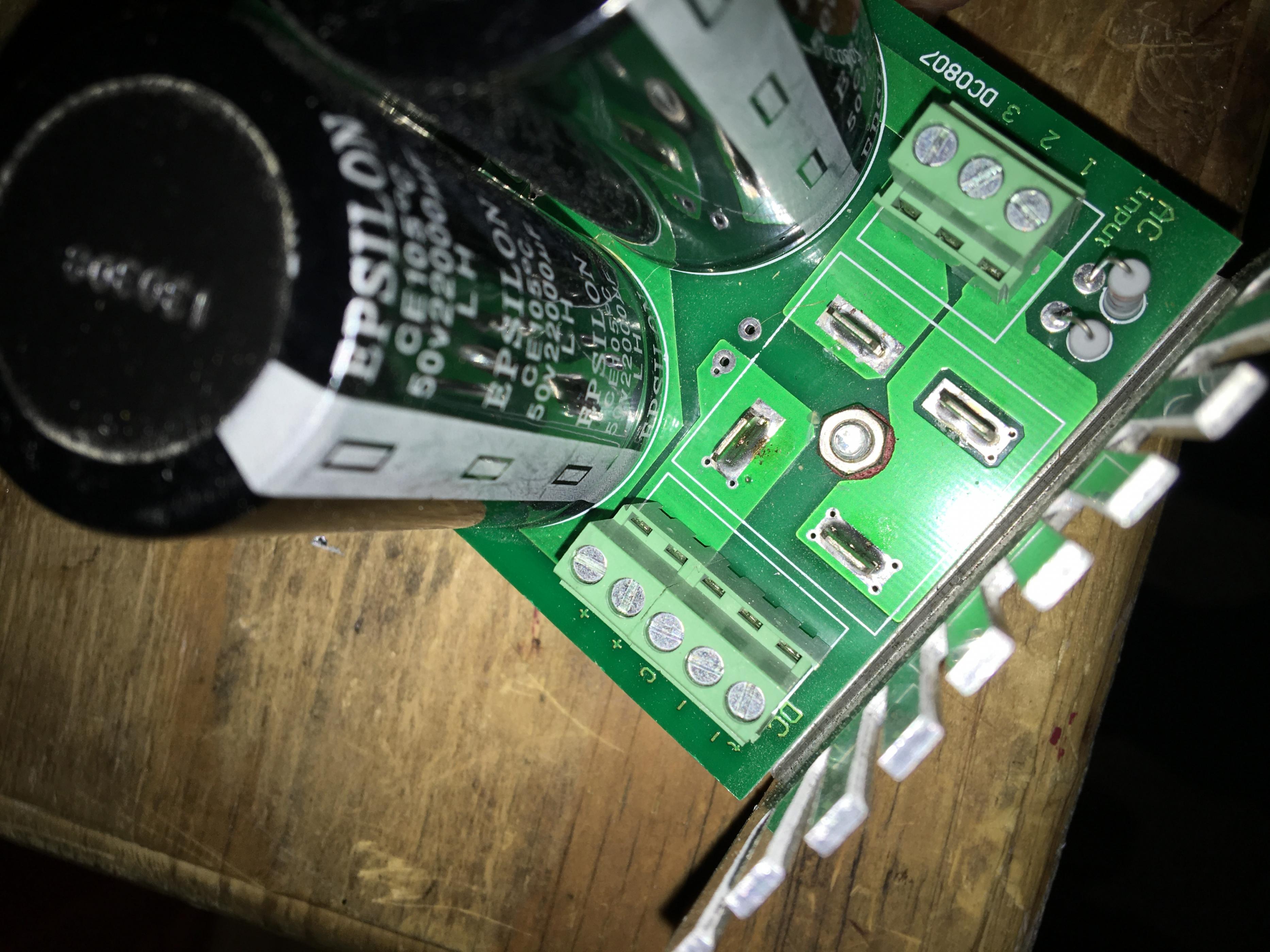

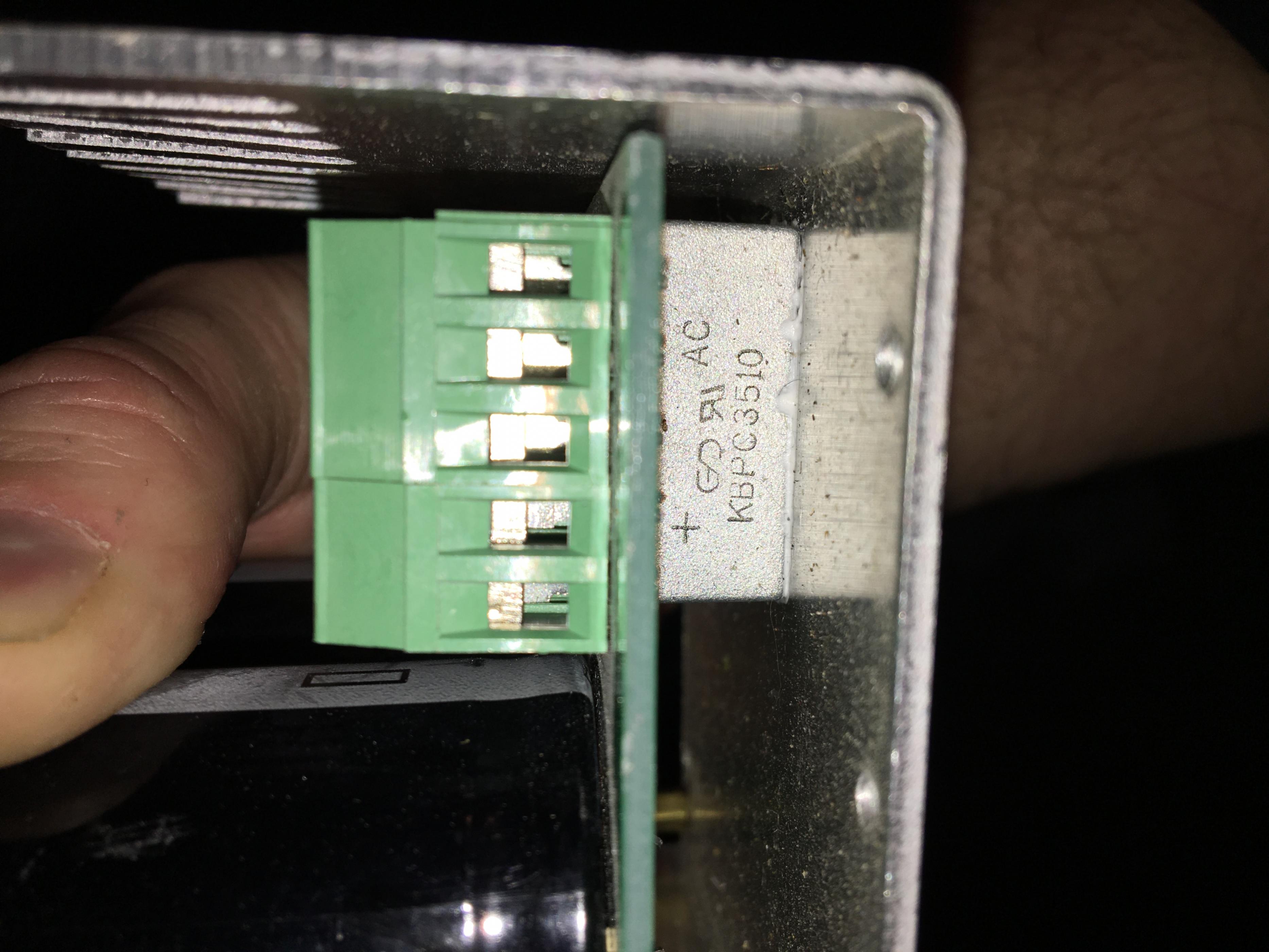

I have these spare PSU regulators (2 total) and I’m wondering if I could use two of them for an F5 or even An F4 or F6.
Each cap is 22000uf and two are on each board (44000 per rail). I’ll have to pull out the resistors to get the exact resistances but there are two on each board. There are bridge rectifiers attached Rated at 35V and 1.2A (KBPC3510).
Would I just need to wire the grounds together?
And what resistor values would I need to have total for each board?
