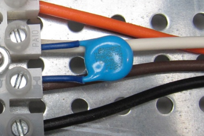

The attached photo has this blue what looks like a thermistor. The BOM and the schematic only lists the CL60 but this one appears to be different. Can you tell me what this is so I can order one?
all the info is on the bottom page of diy store where you bought the boards
