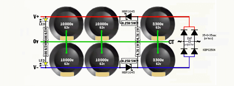

Okay, 63VDC*0.8 = 50.4VDC
35VAC*1.45=50.7VDC
Wow! Finally a simple way to relate caps and transformer. Thanks guys!
So far, it looks like this:
Simple, inexpensive and possibly suitable for one channel of Honey Badger. . . .
35VAC*1.45=50.7VDC
Daniel,
I don't know where your x 1.45 multiplier comes from? If you have a 35-0-35 Vac transformer (with primary voltage matching your mains voltage), across both rails:
[(35+35) * 1.414] - 1V = 97.98V. Divide this by two and your rails will be 49VDC. This is well within your capacitor voltage rating even taking into account transfomer voltage regulation. Why do you include a diode and paralleled resistor in each rail?
For an unregulated supply, there isn't a lot of scope for variation. Personally, I prefer (where possible) a transformer with good regulation, as few diodes as possible to perform the necessary rectification and adequate reservoir / filter capacitance. LED indication of rail state can be very beneficial, i.e. "are the capacitors charged" and minimal bleed to reduce heat and wastage. Other than that, a low-impedance PCB layout that is optimised for current handling if not using point-to-point wiring. Did I miss anything?
