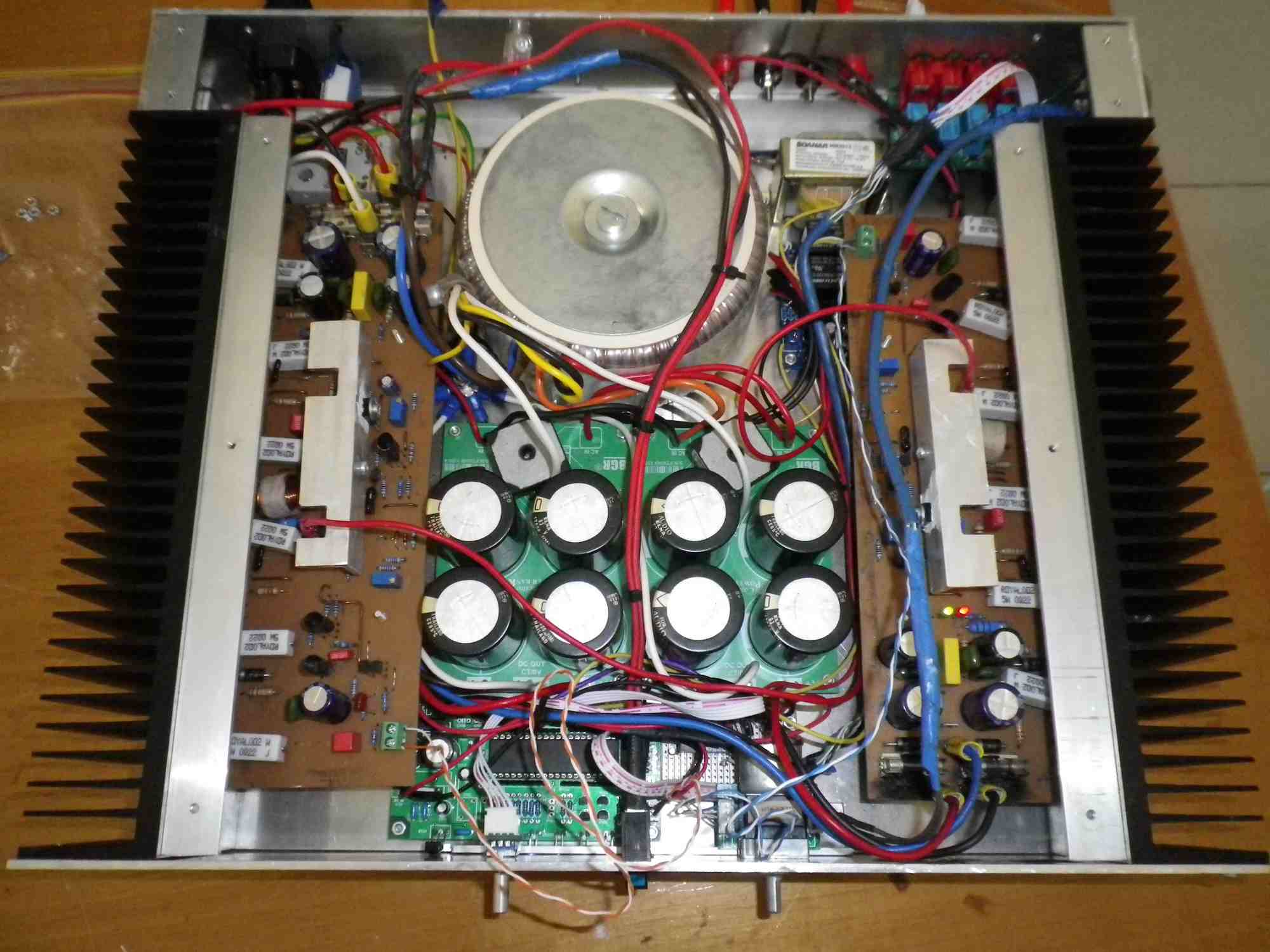

With this board ostripper had many options for builders during the build. 2 different cascodes/current mirrors to choose,2 different vas compensation modes, a choice of the builder for their vas standby current, choice of R27 size and the choice of using an lead compensation capacitor as well(I do not recommend using an LC cap), as well as many transistor choices as well. All these will have an effect on how stable this amplifier will perform in the real world.
I can only recommend the choices I made to cure my amp issues (which weren't a result of a mirrored pcb). It gets quite warm here in summer as repeet would be able to attest to. 38deg c yesterday. I found that q10,q11,q12 heatsink got quite warm and needed a larger heatsink, or better yet tie those transistors to the main heatsink instead of using a separate smaller one.
The choices that were made for my amp were
1. Use the zener referenced cascode/current mirror.
2. For vas compensation I used option 1 the CMC compensation method.
3. Did "not" use a Lead compensation cap. This was tested and the resultant sound was horrible.
4. Changed R27 to 100r. And adjusted to 0.6v across it (6ma).
5. The larger heat sink for q10-12 as stated before.
Has been running like a dream with no blown transistors since.
Regards
Simon
PS. The amps is different to the pic now and a bit neater. The remote volume control boards at the front are removed (chinese ebay type I dont recommend). Solid state relay at top left is removed as well. Now it just houses the soft start and power amplifiers.
