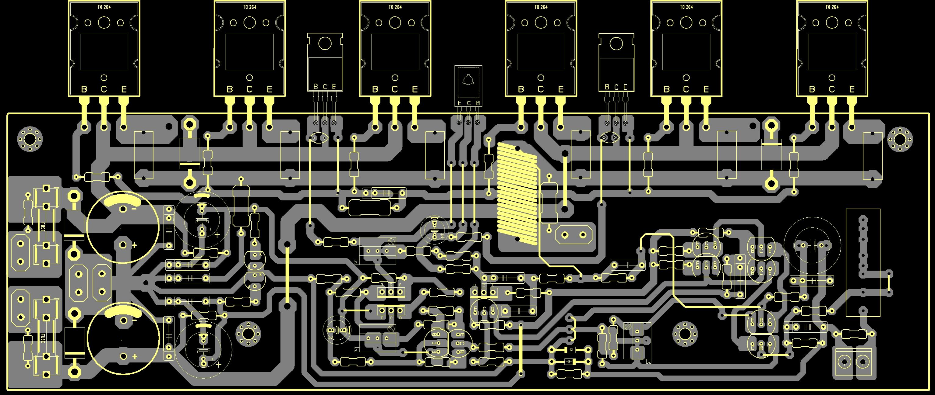

Can anyone reverse engineer the Gerber files back to a PCB layout in it's various layers?

OS layout as it developed turned out to be a good one, much better than the 'schematic style' PCB's that's so common. I like OS layout as current loop areas are outside of small signal areas etc. Of course it could be even better but that would probably mean more layers and that may not be desirable.
I think the best way to honor OS is to make a PCB in a style OS had in mind.

However, it is a step backwards to redo something that we have built an etched prototype for using ostripper boards, and has been proven to work, We'll review the files one more time to made sure the mounting holes are wrong. If they are we will then we'll decide whether to order anyway or not. To most people , the incorrect mounting holes is not a big deal, but we we're hoping the create this standard,, as in the long run, it will be VERY helpful, if all orr boards adhere to it..
It would be useful if someone know how to edit a Gerber file, if that's possible (we think it isn't but there are lots of clever people and programs out there.. )

If no gerber files surface I'll have to redraw the whole thing from scratch. Don't worry though I will follow OS's design as faithfully as I can. My component library only have round pads so polygon ones might take a while since I have to change them by hand. Won't be too hard given how altium is pure awesome, but I'll start with round/oval ones.
And in case you're wondering, I have plenty of layout experience so hopefully I won't disappoint you. I'll start tomorrow if no gerber files show up in the meantime.

I've loaded up the files and from what I can see the distances between the output devices (c-c) are all 40mm (that's what people worried about if I understand correct). Hard to measure with any insane accuracy since there's no snap function or anything. Anything else that needs measuring?

I think that Alex worked with ostrippper to create the first version. Maybe the best thing is to send the latest version to Alex and he (and I ) check for changes and update the board. Then he can move the holes around as we wish, and we're good to go!!
Os version that I made was shown in post 170.

There was nothing wrong with the layout that OS produced. It works, and quite well I must say. Maybe it could have been a little more compact as it is fairly large, but that is all.

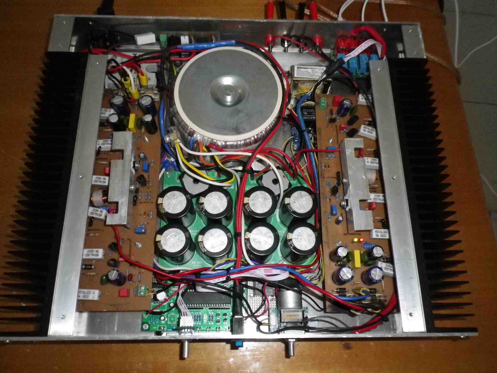

Looking at niss_man photos I would suggest we need a right hand side and a left hand side board for proper layout in the case.
Power side to the front of the box and input to the rear

I wouldn't bother. It works well with zero noise already.
