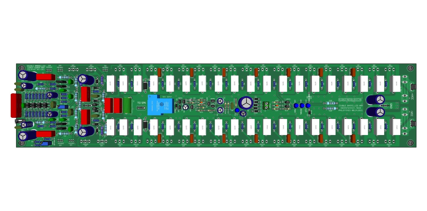

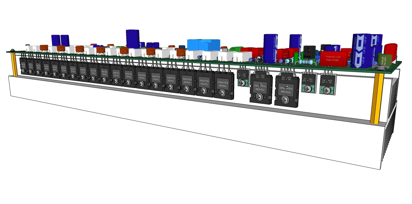

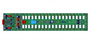

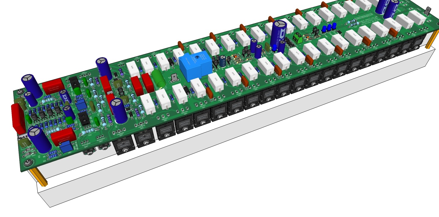

we have a new design using the 3RU heatsinks with 7 quads of output trannies....
  • Linta Amp HS3RU_sch.pdf
