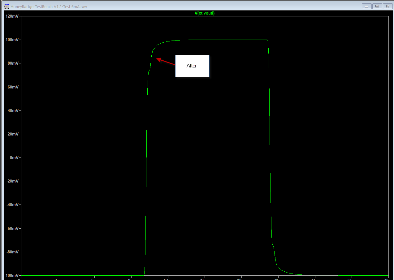

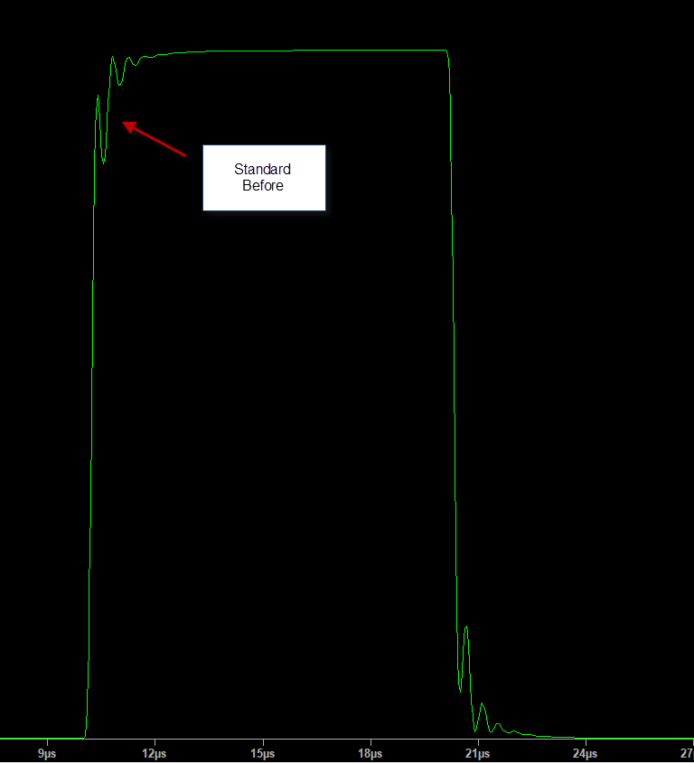

Hi OS, Thank you for sharing that circuit in post 2224. I tested the circuit that you attached with a 100Khz pulse and removing C2 and I still see the same behavior.
In fact it appears to be worse that what I was seeing in the simulation that I was running on the original schematic. What are your thoughts OS?
When I remove the Output stage completely and connect the NFB to the drivers the output is perfect.
This may fix it.
I'll also list them order of contributions to the oscillation.
Change R36 to 50R (1)
Change R34/R35 to 2.2R (2)
Change C18/19 to 100pf (3)
Change C20 to 10nf (4)
Before and after results shown in images

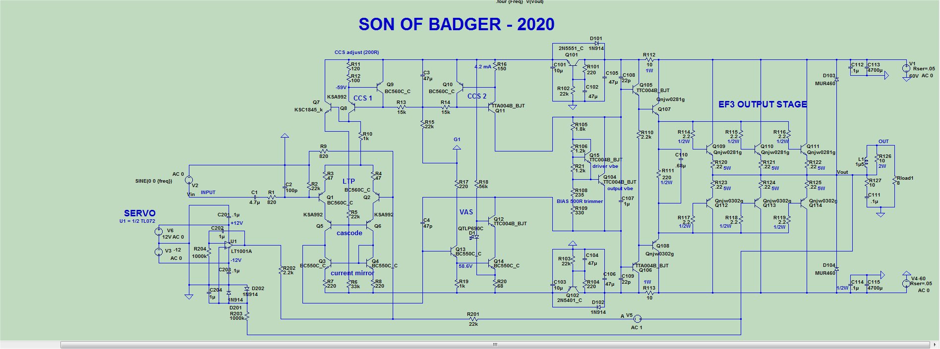

Well , here it is (below).
1. Cascoded BC560 beta enhanced VAS with matching Toshiba 5W devices.
Runs at 4ma - most likely won't need that stupid VAS heatsink.
2. "Slewmaster" EF3 - Don't need to prototype these -
many, many, slewmaster's attest to that. With 3 pair outputs ,the oversized drivers
might also need no heatsink (unless with 3 pair MT-200 sankens and
brutal 2R subwoofer duty). A small heatsink with all other uses. The slewmaster
also has a second Vbe on the drivers . The Harmon- Kardon amp that inspired
this OPS uses a small to-126 on the driver pair HS to quickly respond to
thermal changes. The original HK amp just sandwiched this second Vbe
between 2 raw drivers.
3.Same CCS's as the original badger. Classic "blameless".
4.Ah , cap multipliers. This Badger walks on water in the PSSR department.
5. Servo - Heck with offset trimmers and closely matched LTP's .
Still working on it. VERY nice to have a 16 core PC to use LT on - wow!!
(Intel Xeon V3 DDR4 system - 32Gb ram),
ALL ideas are most welcome ! 🙂
OS
The schematic looks kind of familiar! I can help with the layout whenever you're ready if you like.
hey OS, any reason for dumping the ltp cascode in your new scheme?
To keep the parts count down.
What we lose with the ltp cascode we gain back
X2 from the VAS cascode and the EF3.
We also added the Servo.
Edit - zener free design.
os

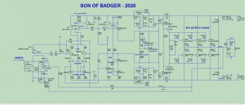

Yes , It is a modified (wolverine). And YES , you are the master of protection.
This (below) is very cool - the IPS uses just 11ma per rail. Could we mix a little
SMT into it ??
The sim (attached) just wants to work. I can push UG up to 3mhz , no issue.
Still might need the Baker clamp option on the VAS. 2R loads on this sim better than 8R on the Badger.
PS - This amp is a "SOB" (bastard son of wolverine+badger). 😀😀
OS

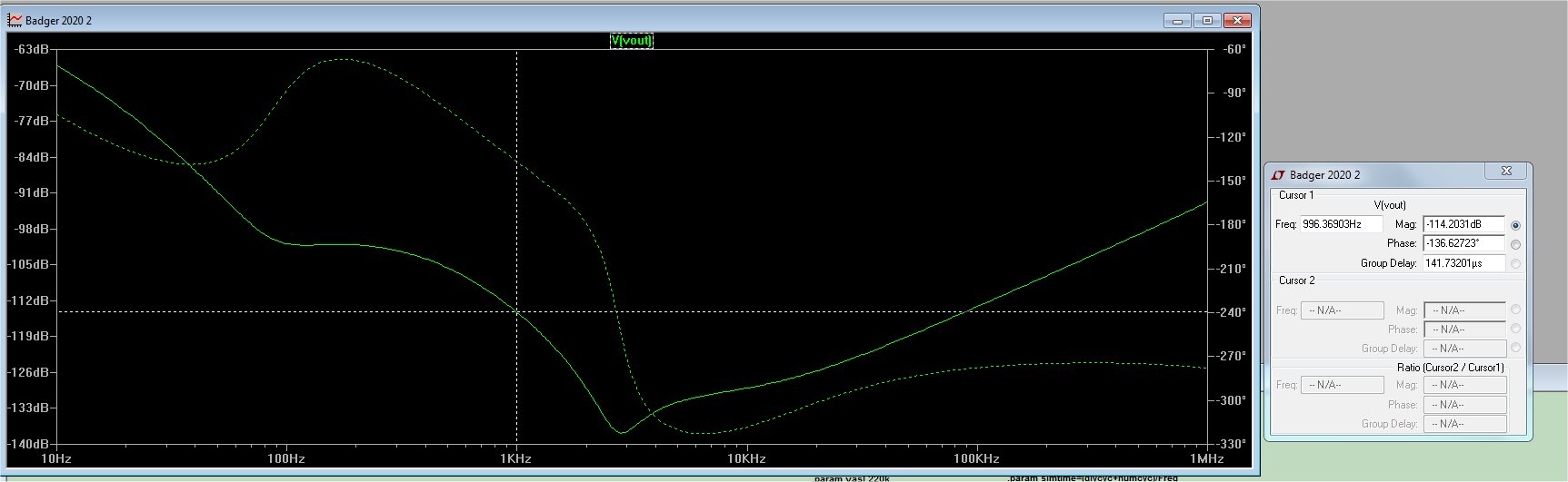

PSRR rrrrrg !
1.Added C5/6 to the input stage - It is just a discrete op-amp .. OK !!
2.Added C107/108 to the EF3 decoupling. I saw a "glitch" at 5mhz. Dumb me,
the Slewmaster EF had those caps. rock solid.
Amp now has -100db from 100hz to 200khz PSRR.
Most of the audio range from 500hz to 20khz is rock bottom -120db. Cool ! 😀
3. C4 -47pF + R3/4 -47R are best (absolute) non-ringing vs. best bandwidth
(1.3mhz) combination. C4 @ 68pF is 1mhz UG (very safe) - still 5ppm at 20Khz
THD. Nice.
