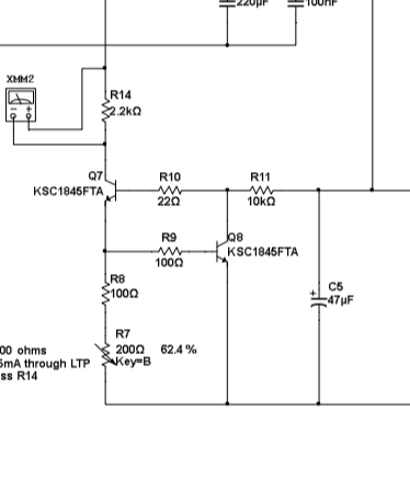

Would I need to alter resisters since gain different?😕
no need...
MPSA06 is also backordered
ZTX450 is available but has a Vceo of only 45V. Problematic for Q7/8 with 60V rails.
Is looks like AmpsLab has KSC1845 available in lots of 20.
unlike the VAS and output stage trannies, Q7/8 does not swing voltage, it is constant current, i see no reason for concern....
ZTX450 for Q8 is more than plenty....Nelson Pass's favorite.....
for Q7, MPSA06 is more than enough even if you use a rail voltage higher than 60volts, you can even increase the value of R14 from 2k to 10k, the output impedance of the ring of two being around 200k is even helped by the higher value of R14...
btw, the usual caveat, be mindful of the pinouts...

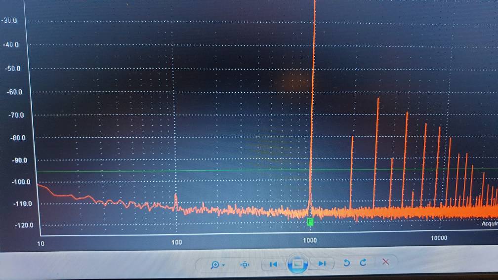

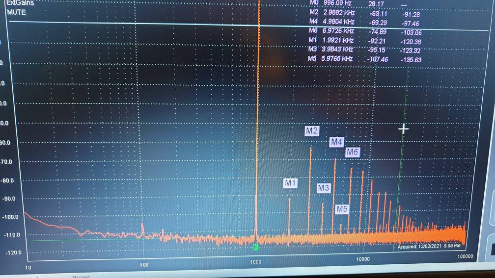

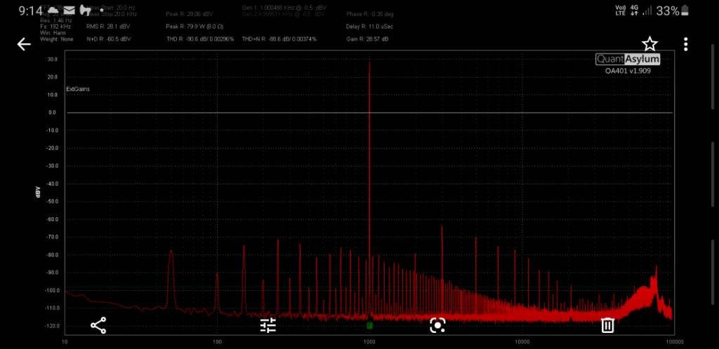

Hi Guys, I have been tweaking my HB over the past few months and have managed to reduce the distortion considerably since my first measurement.
I recently found that increasing the ltp current to 6mA and then changing the LTP degeneration resistors to 120 ohms and changing C7 to 82pf and C8 to 390p to achieve the same unity gain crossover frequency FC. Doing so reduce my 2nd harmonic distortion from -80dB to -90dB and my 4th harmonic from -90dB to -95dB.
First picture is one of my first measurements.
Second is the measurement immediately before the 6mA change.
Last photo is after the 6mA change
Last photo is after the 6mA change View attachment 924507View attachment 924508View attachment 924509
Keeo it up bro... we are watching. 😉
