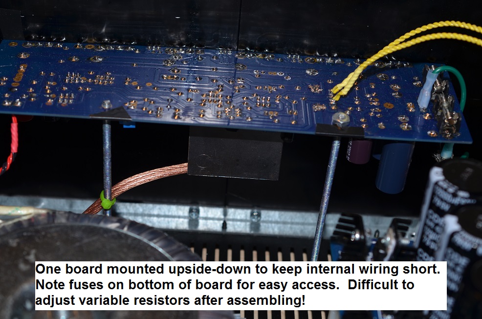

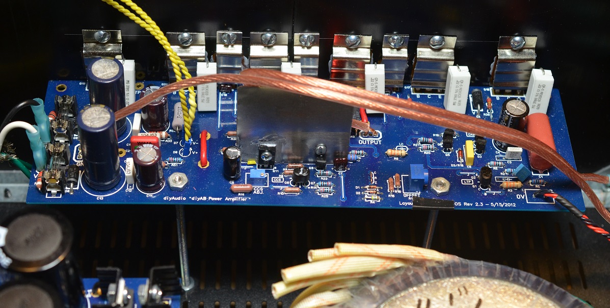

- · Two Honeybadger amplifier boards for stereo.
- · Two diyAudio power supply boards, V1.0 (no longer available)
- · One 800 VA Torroidal transformer with 35V secondaries for +/- 50V rails

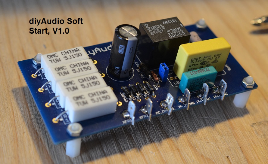

- · diyAudio SoftStart, V1.0 (no longer available)

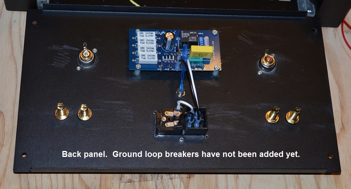

- · Two ground-loop isolation units as described in Rod Elliot’s article Earthing (Grounding) Your Hi-Fi - Tricks and Techniques
