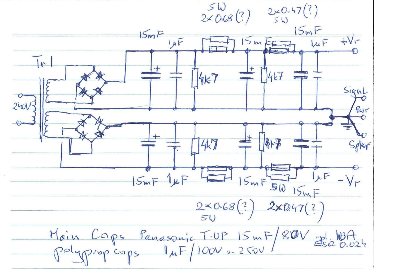

PS for HB
I've just collected all parts for my Honey Badger modules except for toroids. As the system will be active with active sub with diaphram control, I need
2x2 Badger modules to drive bass drivers from 60-80Hz to 600-800Hz and mid-high systems from 600-800Hz uo to 30kHz or so. Mid-high crosover is passive. Each HB dual module will have its own PS and will be driving Left or Right channels. Diagram of my main PS is attached.
First question is the choice of resistors for CRC filters and dreaining resistors. Initial values are shown. Any other corrections/suggestions?
Secondly I have to buy two toroids. The choice is between 625VA and 800VA and 2x41.5V and 2x46.5V. The cheapest, currently on special, is 625VA 2x46.5V and I thought about going for this one as I'll be driving an active system. What do you think?
cheers,
PS nominal voltages are 2x40 and 2x45V on 230V mains but we have 240V mains so actual voltages will be somewhat higher.
PS 2 I may also go for a regulated PS for IS-VAS by adding 2x12V toroid and about 2x70V PS

Power Supply
Here comes my Power Supply for HB. Looks I did not attach it to my original post.
Bridges will be 35A or 50A. Not shown on diagram are 10nF/250V snubber caps

Janusz,
Any of your transformer options will work. I'd go for the ones on sale. If the load is 4 ohms or less you should run through Safe Operating Area calculations, especially if you are using NJW outputs. You're only looking at the difference between 68V and 61V rails, but it might matter for the smaller NJW devices.
Bleeder resistors are just a tradeoff between how fast do you want the filter capacitors to drain and how much power do you want to waste during normal operation. Your 4K7 is a reasonable value. If you are using speaker protection board, you might want to consider piggybacking a NC relay to disconnect the bleeder resistors from ground when the amp is inactive. Then you can use lower value bleeders without having to worry about the dissipation during normal operation.
You might consider more parallel resistors in the CRC section. Again it's a tradeoff, this time between ripple reduction and dissipation/voltage drop. I used Nelson Pass' F5T supply as a guide for the net R value, he uses 7 0R47 in parallel IIRC. The losses are particularly significant in a class AB amp as the signal ends up changing the rail voltage. If the R value is too high you might have ripple that exceeds the amp's PSRR ability. An argument for separately regulated front end supplies. 😉
I'm not a fan of snubber caps, they have the potential to do more harm than good and require advanced measurement capabilities to get them right. YMMV of course. They are also more effective at the amp board where OS has given us room to put some nice electrolytics and a film bypass.
Happy building. My HB is still partially assembled on my kitchen table. Maybe this weekend...

OK, I'll go for 2 x 625VA 2 x 46.5V then. It's the cheapest of all. Higher PS voltage will give better headroom for transients.
I'll be using transistors from my supply box collected over years. Output: mg6331/9411. Drivers as suggested mje15032-33. Other small changes will be q1,2 = ss9014d rather than c so R15-16 will be 150ohm and R20-21=150; Q3,4 = 2n5551; Q5,6 = BC560c; q9=2sa970bl; q8=ksc1815; q7=2n5551 or 2sc2240bl; q10=2sa1406e or 2sa1209e; q11,12=2sc2911e; q13=2sc3117s. Zener probably 18V with higher PS. R24=1k; c7=82pF, c8=390pF.
I might go for front end regulated PS. I'm going to order some boards to be made in China but I won't have these before February-March next year (pcb design still needs some work) so HB will have to work without these for a few monts or longer...

Could you give me a link to Nelson Pass' F5T PS?
I found a number of threds on the amp and schematics but as some threads have thousands of posts finding something in them is not easy.
It would be nice to know corner frequency of used caps for given resistance or impedance for given frequency. Unfortunately in my notes I do not have the formula. I know it's beter to have it smaller than too high.

I'll go further................
I'm not a fan of snubber caps, they have the potential to do more harm than good .............
Remove the four 1uF capacitors.

Andrew T, could you please explain why?
General reason for having these is that big electros are not so good at higher frequencies so adding 1uF plus high quality polypropylene cap provides additional filtering and impedance continues to fall with frequency. One may add additional high frequency RC snuber in parallel to combat potential impedance peaks due to wiring. Sometimes it's worth adding 100uF low ESR cap in parallel. That helps dumping HF resonances. I did it a few times in the past.
