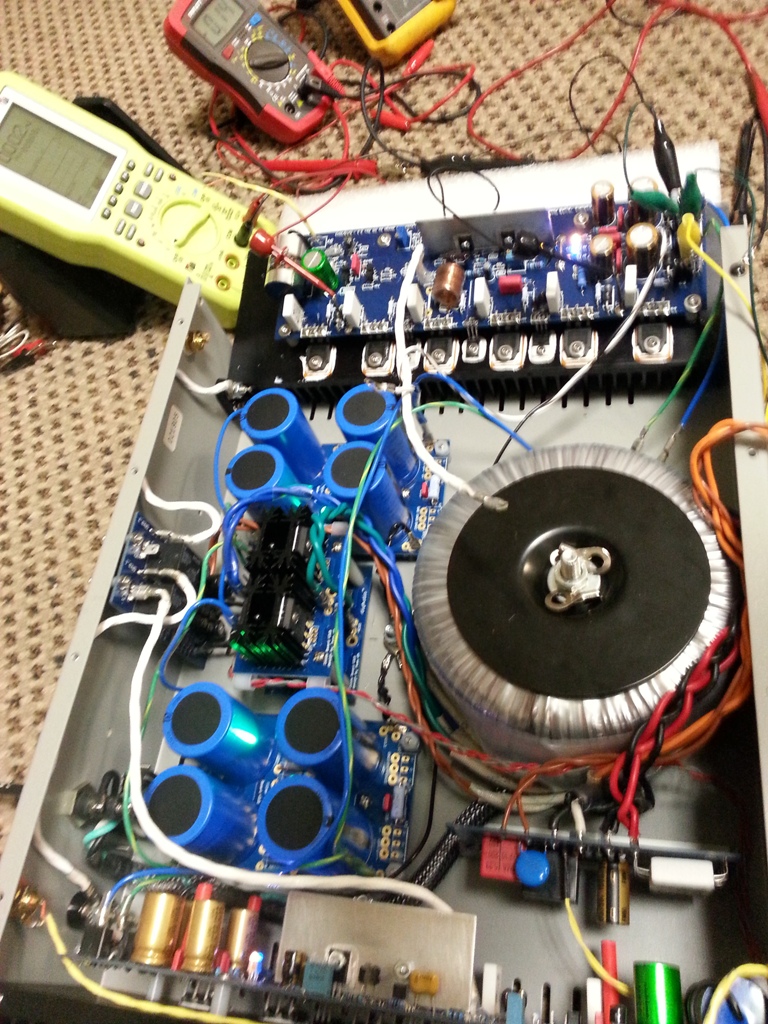

Working on my final layout. This is a DIYA 5U Deluxe chassis which will end up being stuffed to the brim. I still have to add the speaker protection board, which will float above the soft start, and the second PSU above the first.
Couple of questions- In a dual mono config, how important is having all the power wires the same length?
Also, this is a tight layout. Is it bad to have wires touching the PSU caps and heat sinks? I have to run some very close to them, they are of course insulated and also wrapped in heat shrink. I have no idea how hot the caps will get.

You got it really tight. Don't forget that all wires have to be tightly twisted in pairs. With PS in the same case top objective with wiring is silence so sometimes wires must be a bit longer on one side than the other. Under normal operating conditions (not DJ environment) caps will not get much warmer than the environment (about plus 10-15C) although in your case everything is so tight. You may need to drill additional holes in the bottom of the case and its top as well.
That's the trick, isn't it? Black from the toroids goes to the barrier box (front of pic), but red go to a totally different place, the soft start board. If space weren't an issue I could mount the ss board near the PEM and all would be good. But that means I'd have the small toroid for the speaker protection near signal wires.
Now, I am using teflon insulated, solid silver signal wires which should greatly reduce noise but I'm not sure how much I should worry.

If you can help it, I would keep the speaker protection away from the soft start as not to entice 60Hz AC from infiltrating your speaker output. Also, if you must stack the soft start and the speaker protection on top of each other be careful, those 5w resistors get pretty warm. I ran an infrared thermometer around the sand cast resistors and they get around 180-260 degrees Fahrenheit... You may want the soft start on top near the vents.
I am willing to bet that you can't hear the difference in your lengths of power lines--that is, unless you mount your amp boards on your cook top and run the leads from a PSU in your living room😛.

Thanks. I'm planning to mount the speaker protection board perpendicular to the soft start but above it and to the opposite end of the resistors, so the 5Watters aren't covered by it. I do have enough room, and am considering a mu-metal shield under the speaker protection board.

I am using a donor chassis and it is 360mm X 300mm X 120mm. It is tight but plenty of heat sink and and the only thing that gets warm is the soft start. I am using an AnTek AN-8445 teroid (800VA/2 X 45V, 1 X 18V and 1 X 12V) and the diameter is 152.4mm X 89mm in height. I am using 18V and 12V 2A secondaries to run the speaker protect and Halo LED on the power switch. My caps are 12,000uF X 8 and are 35mm X 60mm. To save space I stacked the rectifier boards/mounted the speaker protection and soft start on end. I had to get creative but you should have plenty of room!😉

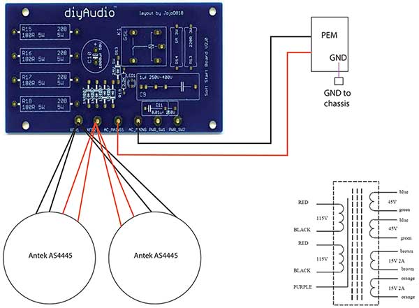

Here is the wiring diagram from the build guide. Red wires from the tranfos go to the softstart, black wires go to the PEM. What I meant was that I can't twist the red and black wires from the transfos together because the softstart board is not close to the PEM. Or am I missing something?
Each pair of AC wires should be twisted tightly together - the two (sometimes four) wires from the soft start to the transformer (red), the two wires from the soft start to the switch (green) and the two wires from the PEM to the soft start (orange). Similarly, twist the wires from transformer secondary windings to rectifier board(s) (purple).
Do you have dual primaries or single primaries? I used an AnTek 8445 and it has dual primaries (2 black and 2 red). For 120v, I placed (in parallel) both sets (2) of primaries to the Soft Start Board (red together and black together to the SS board). The white and black come from your PEM and connect to your Soft Start board. The ground from your PEM goes to the chassis for the entry ground. I just want to make sure you are wireing for 120v operation correct?
I do believe I had it wrong. Here is a diagram of what I intend based on feedback. Yes, two Antek AS4445 tranfos with dual primaries for 120v. Is this diagram correct? (I am not using a secondary switch, just the one on the PEM).
Every pair of Flow and Return should at least be close coupled, but better is twisted.

I do not recommend two transformer running from the same soft start resistor/thermistor.
I much prefer separate soft start resistor to feed each transformer and then a two contact relay (or two relays) to bypass these resistors.
In two of my amps I'm using one soft start unit with two 300VA toroids. Everything works fine but with 800VA trafos I use independent soft start circuits with two separate mains switches.

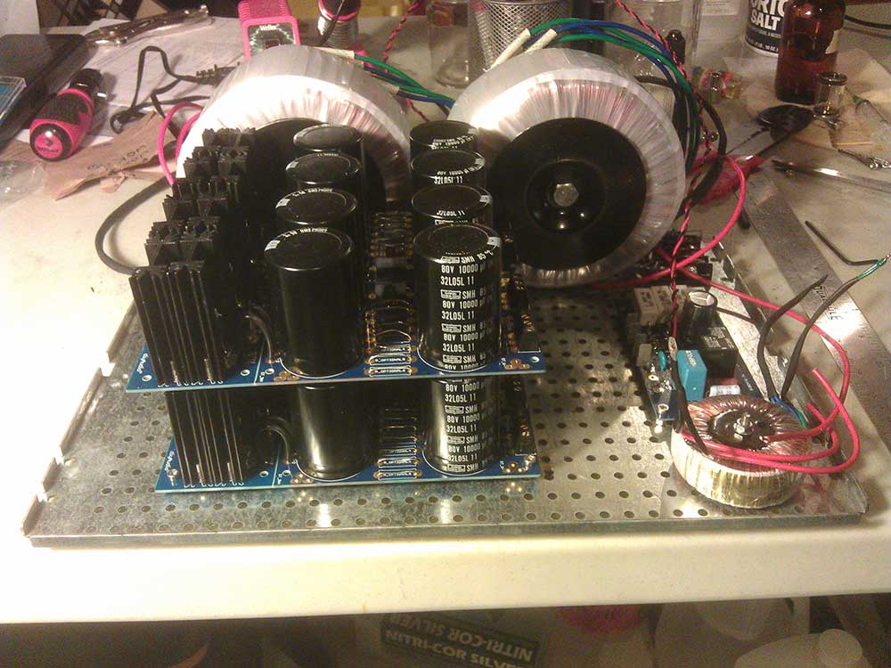

I'm stacking my PSU's on top of each other. I need to raise the top one 60mm. My original thought was to use M3 standoffs, probably several screwed together to do so. I priced them and it's over $50 for a handful of them. I don't have room for a riser panel. Any other ideas? I'm considering threaded rod, which I could cut to length.
Spacers & Standoffs | AllElectronics.com You may need to use multiple standoffs, but a heck of a lot cheaper than buying from mcmaster or mouser.
