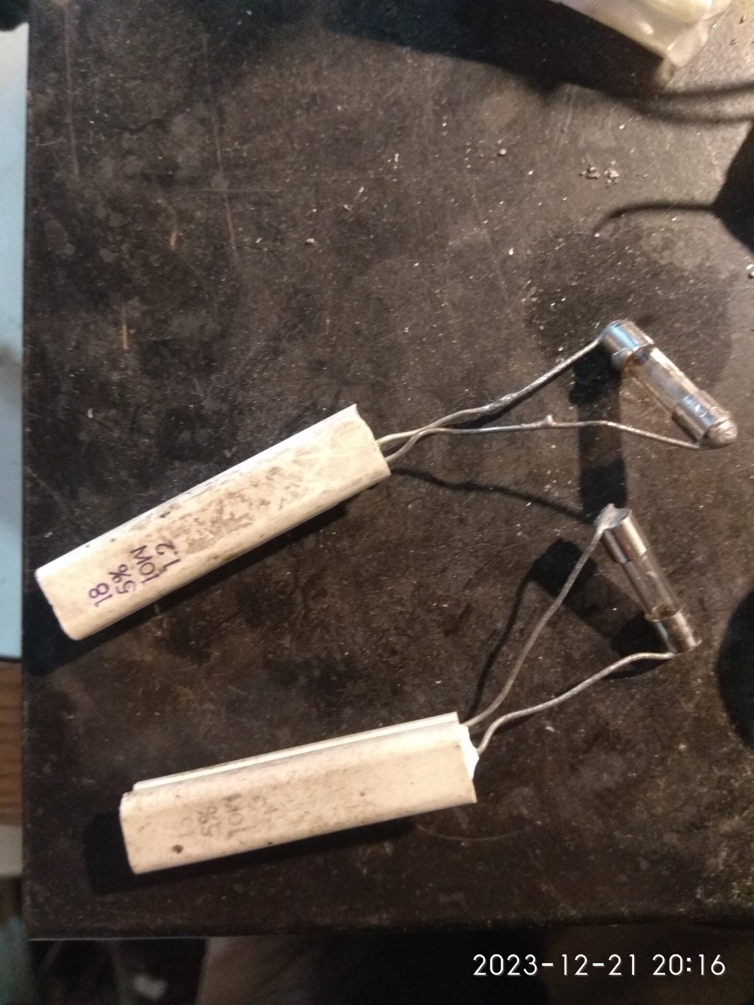

If you are running fast blow fuses on the rails it might be a good idea to have a really close look at the center on the fuse element for any sign of discolouration. They can actually start to melt on higher output swings of the amplifier and cause what is called "fuse distortion" (looks similar to clipping on a scope). Often you can use a lower rated slow blow fuse on the rails which can actually offer a little more protection in some cases.I would think a resisitor, of any wattage, would have a much longer "blowing" time than a fuse. But hey, I'm not an expert. I'll stick with only fast blow fuses on my rails. Of course, even a fast blow fuse may not protect the outputs depending on the circuit, the device and the circumstance creating the short.
I agree with you completely about removing the resistors that are bypassing the fuses, that's just wrong! So is placing the fuse on the amplifier board itself. The should be at the source, the supply. As is there's no protection for the supply if wiring is shorted.
Fuses do have resistance and do produce a voltage drop, that's how they work. The voltage drop and resistance are very small, but do climb as the fuse rating get smaller. The resistance of the fuse element also rises as the temperature rises, more current flow will cause the temp to rise and the resistance to go up and the voltage drop to climb. This is why @jwilhelm's statment about fast blow fuses makes a lot of sense.Fuses have no resistance.
Without resistance there is no voltage drop.No voltage drop no protection.
Want to talk to a newbie about the non linearity resistance curve of fuses? Do you encourage anyone to rely on fuses to test an amp? Sorry, but I have a different opinion.☺️
Of course we speak for test conditions only!
After a susses full test resistors should be replaced by fuses!
I use resistors 18R/5w in series with the rails & a bulb short circuit protection circuit in the primary side always.
I haven't any burned part anymore.
Here is my lifeboat.
Take two blown fuses,solder the resistors and safe test.
You can smell the fault 😤
or sence the hot!
Better way,connect a voltmeter or two across each resistor and read the voltage.
Ohm is your friend.
I=U/R.
For a non fault amplifier you must expect something between 1-2V.
You can try to adjust the bias,not for recommended vslue but just to see the voltage drop varies.Adjust for the minimum voltage reading.
Amplifier INPUT sorted.
If you read higher, disconnect the main immediately and inspect for the reason.
or sence the hot!
Ohm is your friend.
I=U/R.

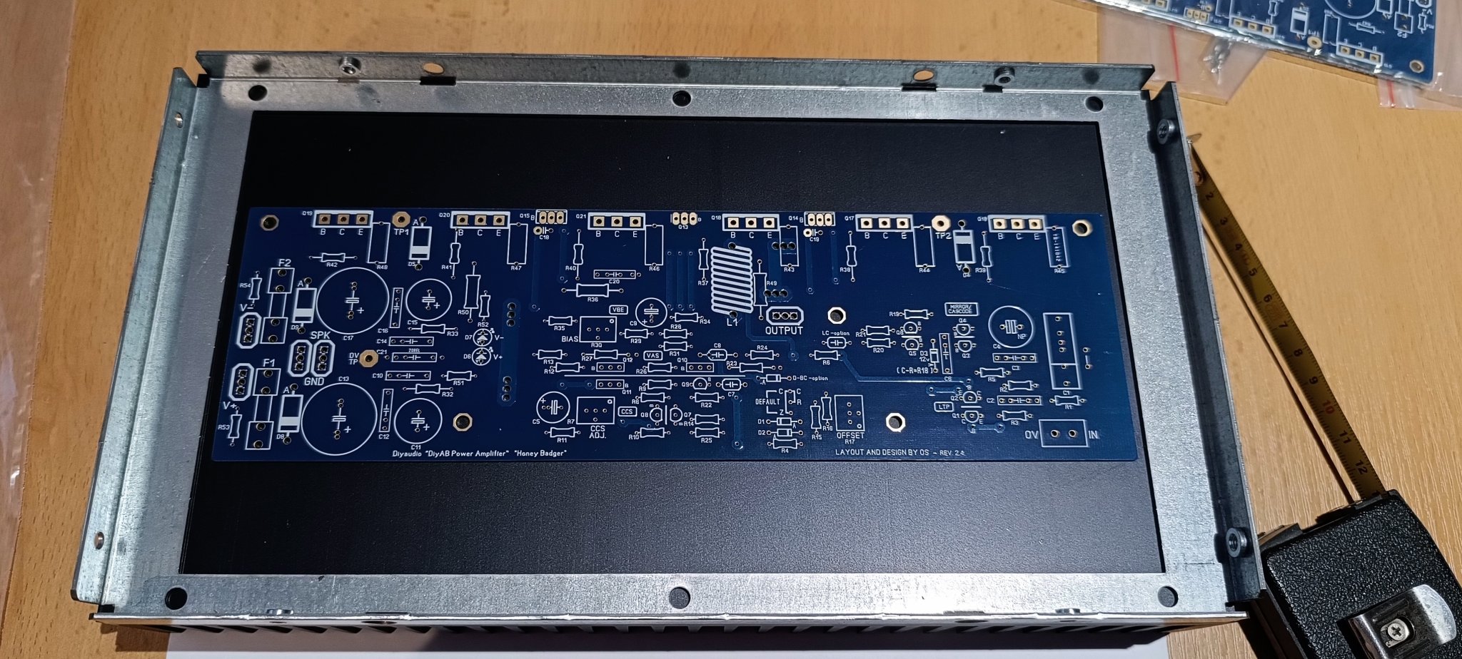

Friends, I have ordered the boards for Wolverine but I'm going to build HB as well. The PCBs on the HB I already have at home are really gorgeous blue+gold. After reading the whole thread, I'll go the way of Stuart, he's done a lot of great work and the BOM will be created from his modified 2.5.4 schematic. I will add an updated BOM by the end of the year. Important thing to keep in mind to avoid oscillations, ...(select input transistors at hfe 300 max and adjust current for zener diode 15K/1W)

I have a theoretical question. Let's assume that I use one of the higher power output BJTs, e.g. MJL4281/MJL4302 and set the rail voltage such that I am within the SOA with a single output pair. Can I, in this case, short the 0R22 emitter resistors or would this cause whatever instabilities? A related technical question is how to measure the bias, then. I think I would just measure the voltage drop on the base resistors of the output transistors and use their hFE value to estimate the collector current.
Emitter resistors are needed whenever there are multiple output devices. 0R1 isn't enough resistance to force the output transistors to balance.

mcsontos - I wrote a thermal simulator to determine the value of emitter resistors in my amplifier. 0.22 ohms requires good thermal tracking. Thermal tracking can be sloppy with 0.47 ohms. Much below 0.22 ohms, thermal runaway becomes unavoidable.
If you want to experiment with blowing up an amplifier, do it in simulation.
