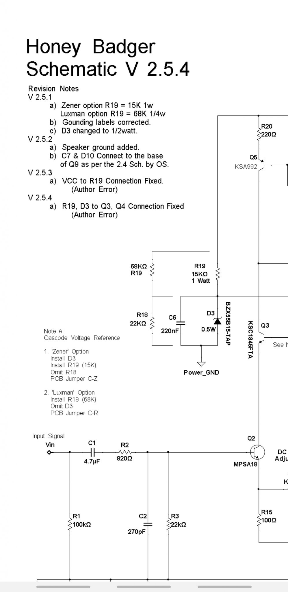

Hello everyone. I am continuing with my HB amplifier build after a long break and I am seeking some help with speaker hum. The amp is completely built and I am running the diy audio universal power supply paired with an Antek an-8445. I am building the 2.4 boards and have them dialed in with almost 0v of dc offset and 30mV of bias current after letting them stabilize for ~1 hour. I get 8.25V across R14.
The problem: With a speaker is hooked up to the amplifier, the speaker hums when idling with no input signal. I hooked up my function generator to the input and Oscope to the output and get a beautiful output waveform 0hz to 20khz (no distortion). I hooked up the speaker with the Oscope and function generator and the tones sound great without distortion but I still hear the hum.
What I have tried: When measuring between the amplifier ground (dc ground) and the chassis ground I get about 200mV. Touching the chassis ground with the red end of my DMM probe (black disconnected) I can hear an audible change in the hum frequency. The 120Vac ground is not connected to the chassis. Connecting the 120ac ground to the chassis makes the hum significantly worse. I have checked all the components for shorts to the chassis and did not find any.
Is this most likely a ground loop? Any advise would be great, I feel like I am so close to finishing the amp 🙂. Thanks everyone.

What value do you have for R19 and D3
Are you using the latest schematic?
If R19 is to large you will run into problems search my previous posts on the subject

I am using the BOM from the diy audio store (https://cdn.shopify.com/s/files/1/1...d_Honey_Badger_2.4_Schematic.pdf?v=1619657915). R19 is 68k at 1% and D3 is a 1N4744 (https://www.mouser.com/ProductDetail/78-1N4744A-TAP). The boards are V2.4
I have not seen that version of the schematic, I have been following the links in the store and slowly readying through this whole thread. I will try to find your post on R19 and hopefully that will shed some light on the speaker hum. Thanks!

The problem with your noise is.... If you use R19 = 68K then your zener diode is not operation above the knee the voltage is unstable and very noisy
Search for my posts stuartmp in this thread and use my updated schematic for the correct components. The original schematic had a option for a voltage divider to set the cascode base voltage. OS later changed the circuit to use a zener but never update R19 accordingly.
As a quick test you can also pull out C6. As R19 is currently 68K the amplifier on turn on is still trying to charge C6 and the zener current is not high enough.
I also provide some links to Elliott Sound Products website for more information.
The info in the store isn't the most accurate and our requests to have it updated have gone nowhere.
