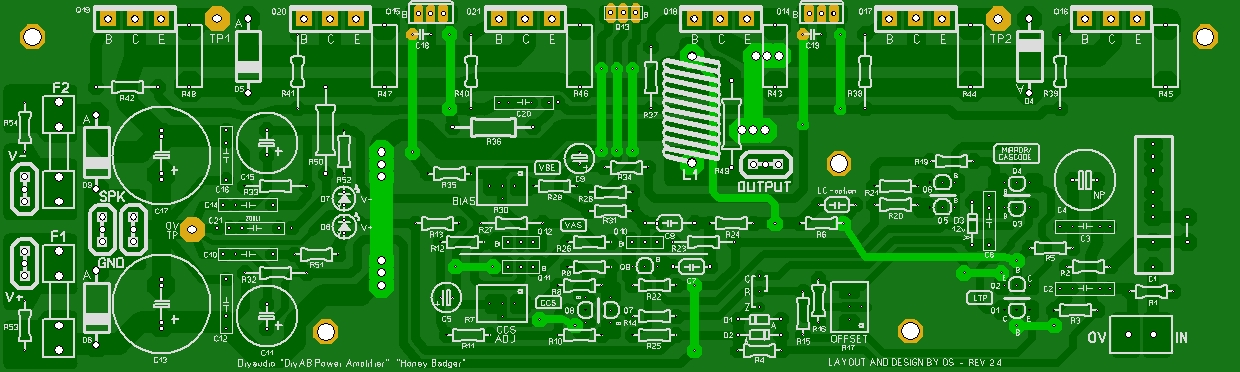

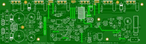

Not sure if this is applicable as I have a v2 board, but I ran into some more tight spots.
Holes for Q13 needed to be drilled out to 1mm
C11 and C13 could have another pad for 7.5 mm LS; holes could be larger
I think they fixed that with V2.3. I have the V2.2 sprint which I have updated .. it originally had C13/17 at 1mm - 7.5 and 10mm LS. C11 /15 , 1mm hole- 5mm LS.
That is strange , the v2.3 actual boards I have ... all my caps and semi's fit with no drilling - I have no pins larger than holes and the lead spacing (semi's and caps/ resistors)- are perfect. I expect to populate these boards nearly to spec !
When I submitted my first Sprint (below-drilling text) - I did my homework (read the text-this is what sprint is set to). All drillings were .1-2mm over the largest expected component. Possibly , the outsourced PCB work was in error (there , I said it :eek:) . I will update the drilling text (it actually is in spec now) for "looser" holes.
"perfection is possible"
FINAL v2.4 is below. --- Zobel cap (C21) even has more room !!
OS
