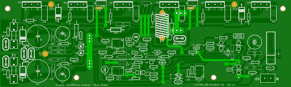

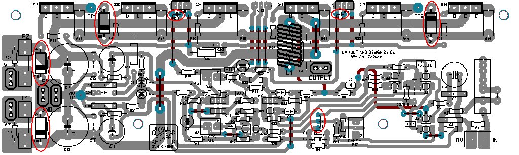

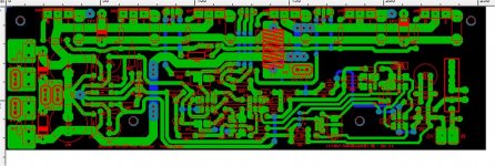

I've identified from the forum some minor issues with layout.
Outlined in red circles below - (first pix)
#1 - D4-5 (D8-9) - output snubber diodes. Read that the fit is tight ...Badger holes are 1mm
I checked MR856G http://www.onsemi.com/pub_link/Collateral/MR850-D.PDF ...
1.3mm diameter ... oops.
#2 - "CRZ" jumper is masked.
#3 - C18-19 pads are masked.

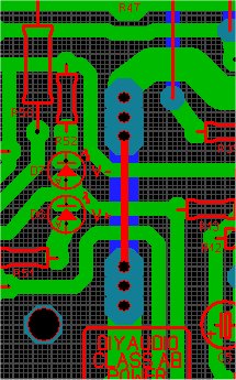

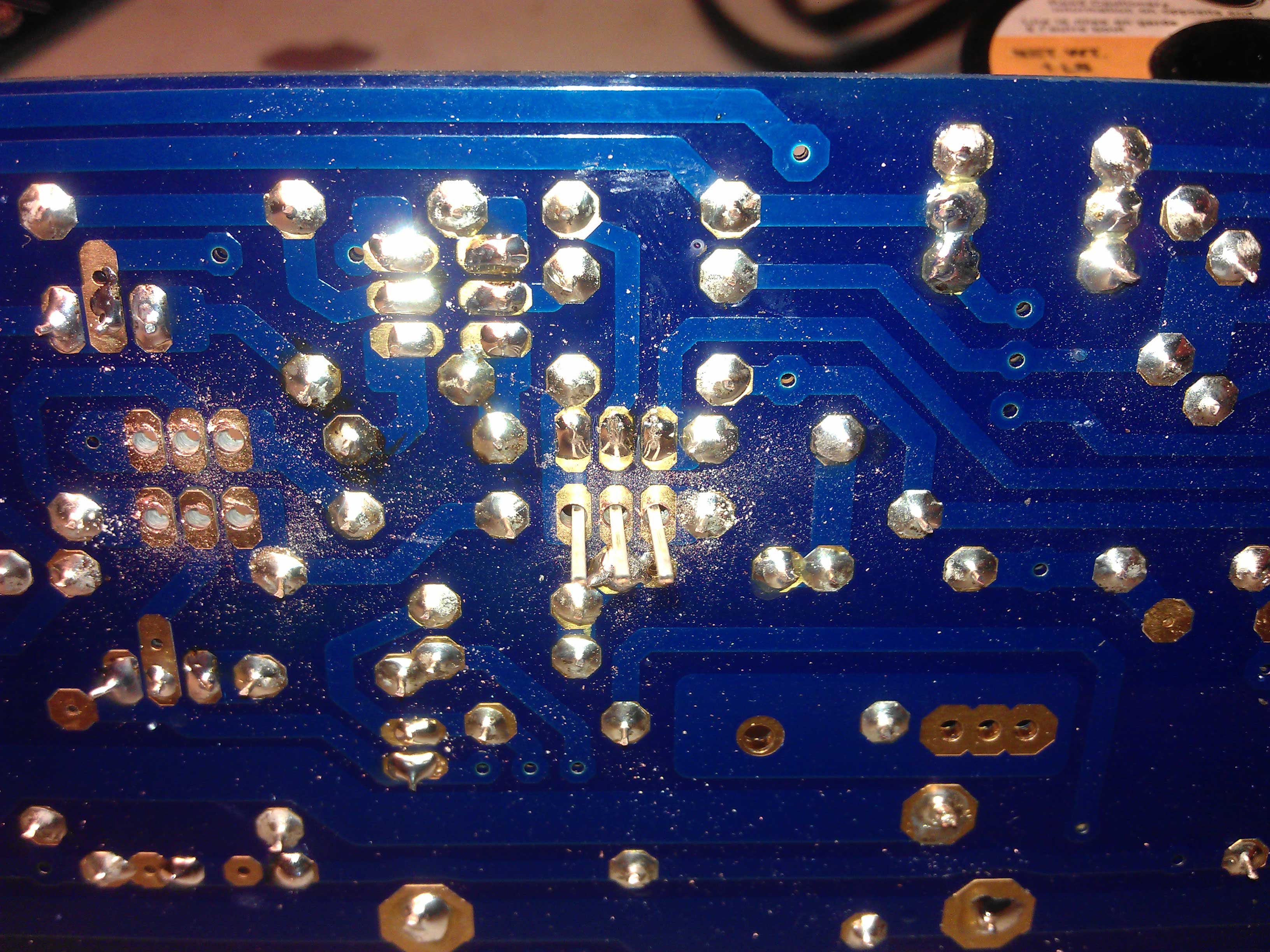

#4 - jumperless design. The print side of the board shows jumpers , but these are actually plated through holes and run on the back layer (physically it is jumperless) ...easy fix ! I would however suggest real jumpers for the V+ trace as the plated through holes might be a current "bottleneck"(V2.2). A more permanent solution would be to increase the number of holes on the 2 points where the V+ trace crosses other traces. Sort of like the power and ground planes on a computer motherboard.
An example is below (pix 2).
These "bugs" are very minor and the version 2.3 board works and is even reviewed (no effect on proper operation). Just cosmetic and ease of construction updates.
Any other version 2.4 suggestions are welcome !!

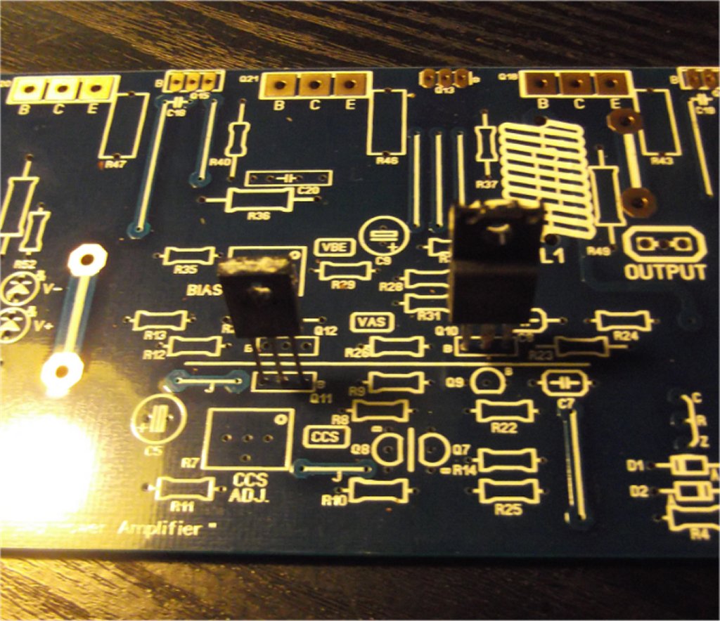

I'm finding the holes for Q10, 11 and 12 to be too small as well.
What version board (2.3?) I just fit a 2sc3503 , it's even loose !
In fact , the to-220 (slightly larger pins)even fits Q10-12 and Q13-15 .. all the medium sized transistor holes.
The only device that has a larger collector pin is the mje340/350 pair. For these ,I could use a sewing needle for the Q10 middle hole.
picture below shows everything.

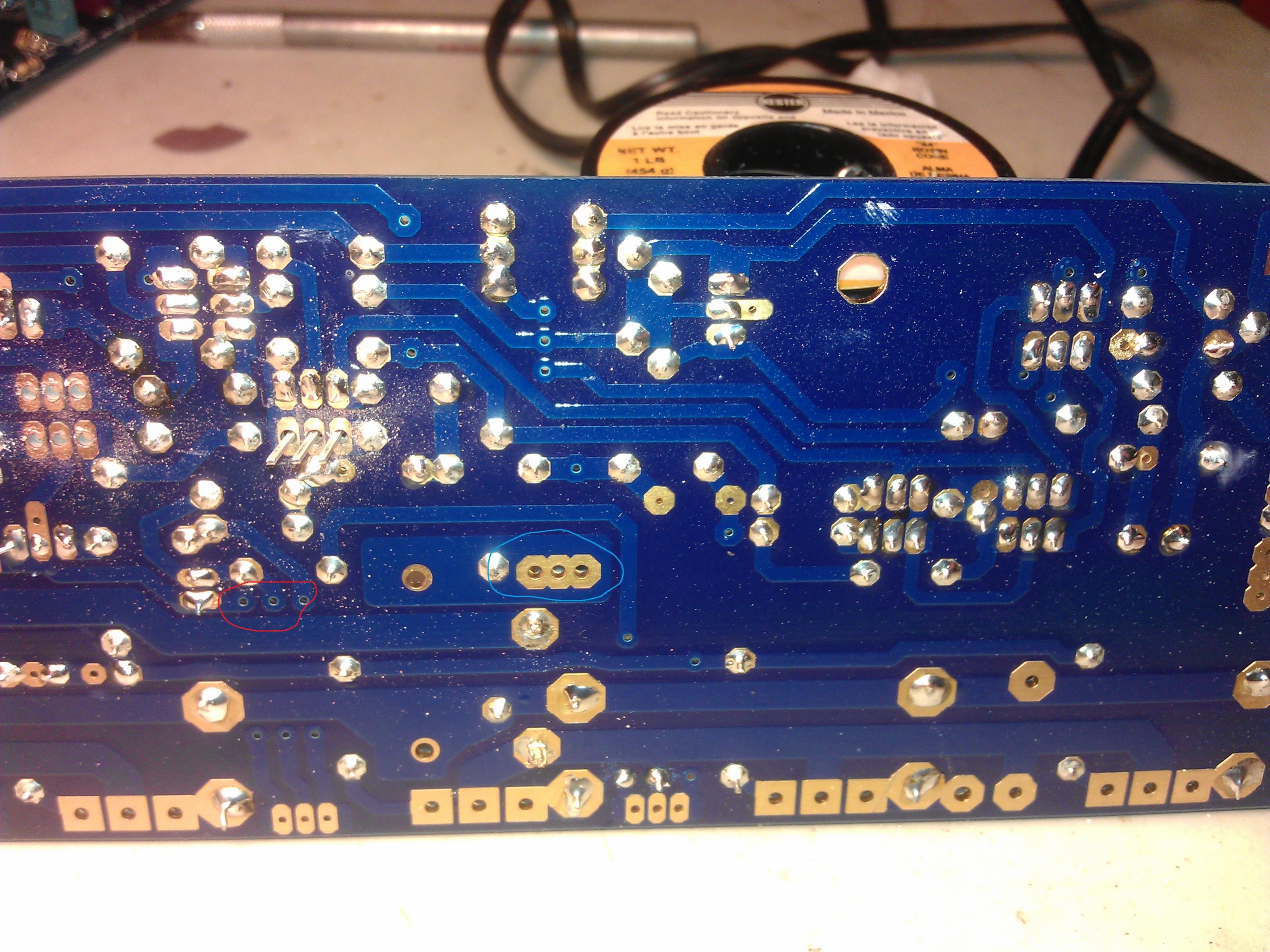

First pic shows Mouser PN 512-KSA1381ESTU inserted, with original board holes drilled out to 1.5 mm. (I don't have a "before" pic.)
Second pic shows in red what size the original holes were (though the solder plates were visible.) In blue it shows the size they needed to be to fit this component.

looks like the pitch (how far apart the holes are) might be the problem, but OS's fit just fine.. ?

wow 1.5mm !! That's big diode territory !
http://www.classiccmp.org/rtellason/transdata/ksa1381.pdf
States .75mm , I set the V2.2 to .82mm for all the to-126's (below 1). I do not know how this happened as I submitted the correct drilling size. I don't know how they got to V2.3 (the holes are right on these) , but (at least)on the V2.2 sprint file , it was right. STRANGE !!
Just about have V2.4 done (below 2). I'm using parts on hand,a V2.3 board, and datasheets to tweak the holes.

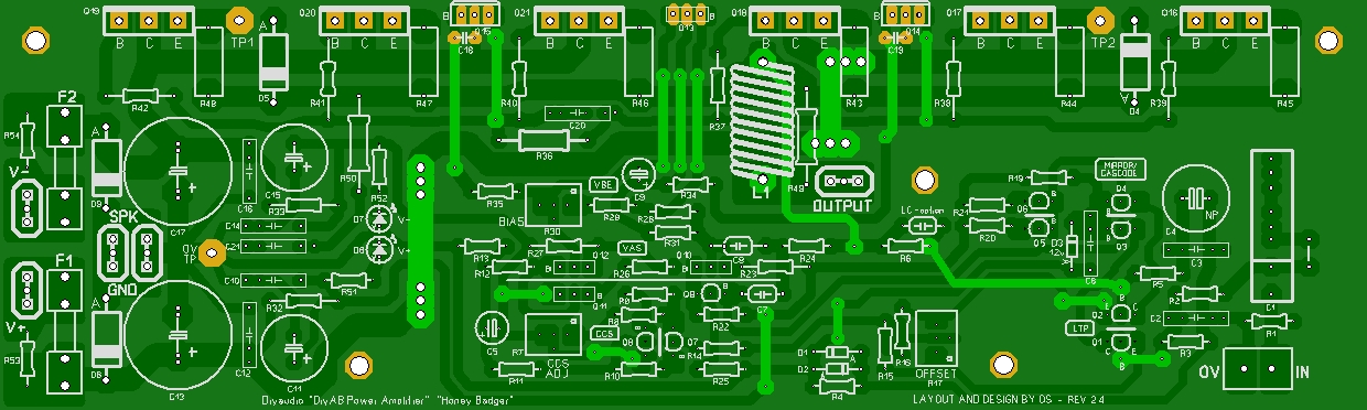

V2.4 is done.
PCB changes -
1. Zener based cascode reference is "locked in" and jumperless.
2. Gave most drillings another .1mm extra diameter.
3. Fixed DIYA universal mounting holes.
4. Fixed the few pads that were solder masked.
5. Removed jumper screenprints.
6. 3A diode holes at 1.75mm.
7. Increased current capacity of power rails (more through-holes - jumperless) .
General "housecleaning" and a more verbose BOM. This is the BOM that the
spreadsheet / mouser "one click" ordering system will be based on.
BOM changes -
1. All 4mm resistor placements are 1/8W devices (3mm - will see the screenprint).
2. 6mm = 1/4w , 8-10mm are 1/2w , power devices are the same.
3. Added notes and more choices for all semi's.
Below is the output ...
OS
