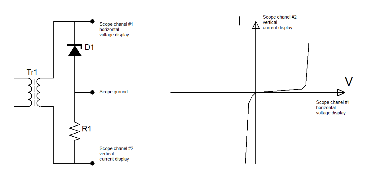

Can you post an example please ?beware of zeners .... some have weird bumps aroud the knee region ... in a low current application it may have a strange effect .. .. in these application all zeners should be check on an oscilloscope with a X-Y display .... to see V/I curves ...

sorry I cannot post example ... about 8 years ago I build a pair of Leach ... and I had many types of 20 V zener ... I did basic curve tracer with a low voltage power transformer, a scope in X-Y display and a resistor ... but I did not make any pictures ...

A zener is suppose to have a sharp bend in the curve at nominal voltage ... I remember having test several zener and at the bend there was a small curve in ''' S '' shape ...

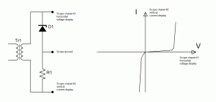

There is no proof ... only my words ... at the time I did not take pictures .. but I did see .. I made a sketch .. see it below ... the difference betwen 2 ... 20 Volts zener from different company ..

I've used curve tracers to characterise zener diodes. Unless you dynamically sweep the component, you would never see the anomaly. I haven't noticed the kink in the curve, but that doesn't mean that the kink doesn't exist. I have seen some really soft knees and running a zener at low current (for the voltage). This is undesirable for obvious reasons.
I try to reach a happy spot where power dissipation is minimised, but high enough so that I'm away from the knee. It's a balancing act with high voltage regulators.

Is your "bump" related to ringing / resonance / overshoot with the transformer in your test setup? A bit like rectifier diodes switching on/off the current, which triggers oscillation in the transformer.
