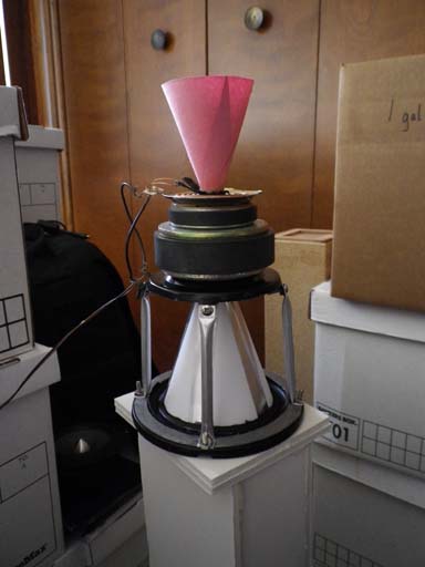

I'm up to page 20 on the 'How To' tome. Got the 'basket prep' and 'cone creation' sections done; next up are the 'base fab' and 'assembly', some notes, and a vague index of it all. Made some bases for the existing pair, which are being 'broken in' by playing a Dave Matthews' CD endlessly...a demented thing to do, but it functions as a sort of metronome.*L*

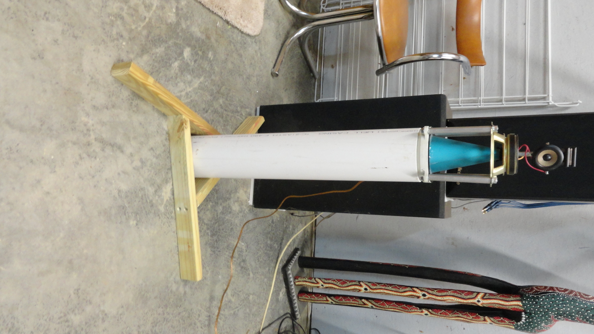

Using a Kenwood car unit as the source,hooked up to a small Sony sub. I can play them pretty loud for a 4" driver. Loud enough for the 120vac>12vdc power source to 'go thermal' and pop its' little breaker.
I'm pleased...*G* They don't sound half bad for 'steampunkjunk'. A friend who 'does audio' likes them enough to want to build a pair of his own....

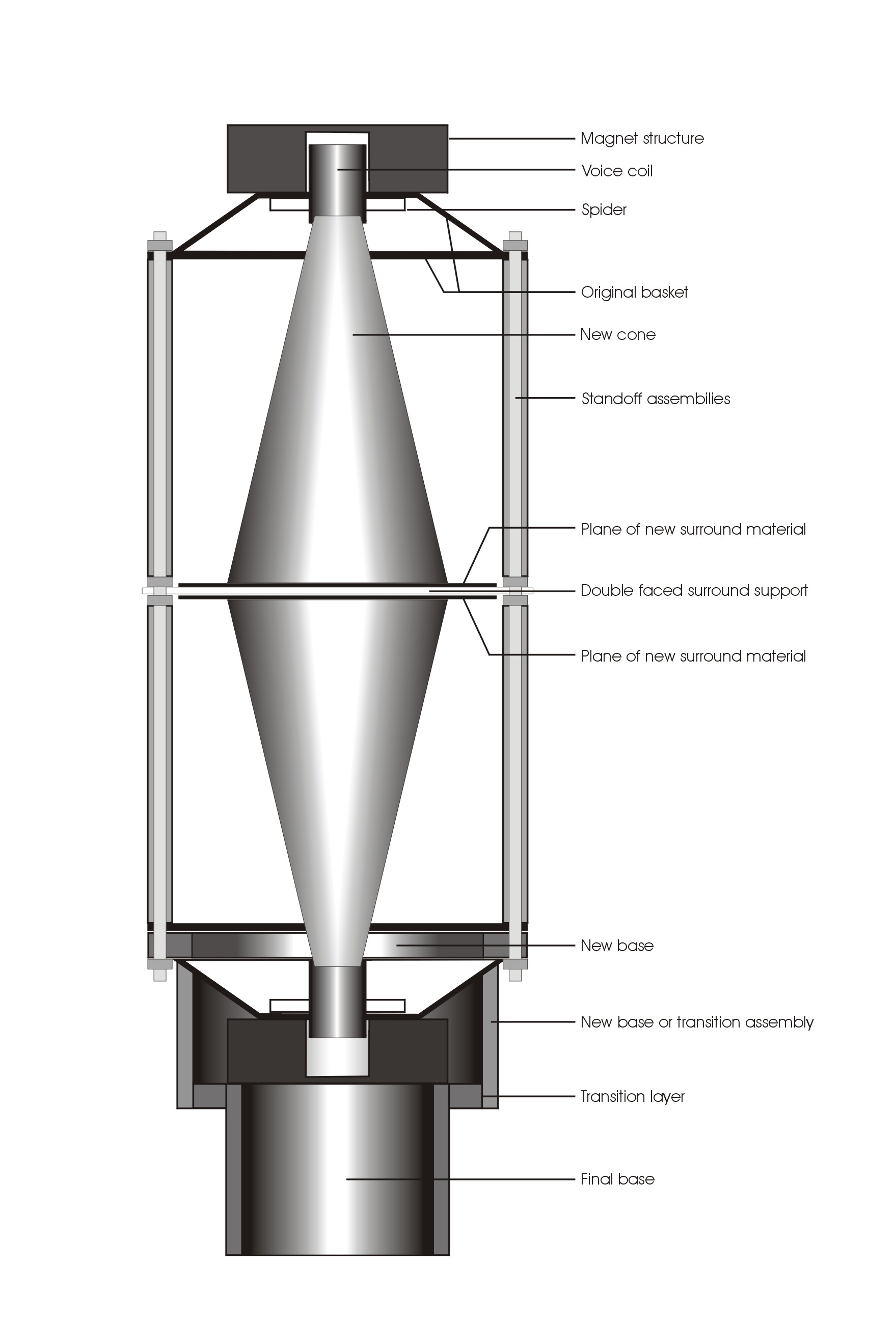

OK, here's something that got stuck in my imagination, a 'push-pull' variant of the German Physiks units. Any one want to try to talk me out of building a pair? I've got this odd feeling based on how my units act that this could fly.
...and adding a supertweeter on the top (Lets' call it The Cherry) could be a Snap, and it could also be a Walsh, sim. to the Infinity 'ice cream cone'...

Is that the finished product? Jerry do you fully understand how the walsh driver works. Or the German physic's.
That's just an experiment, as is most of what I do. I think that is one of the best ways to try to "understand" something.
I say that because the bottom portion has termination. The top portion doesn't seem to have a surround or termination. So I assumed it was taken mid completion. The second question was to Jerry rigged. I would love to build a Walsh or German physics driver with a group I was curios how much he knew or at least thinks he knows for the sake of finding topics of discussion. As I am wanting to learn about the driver.
*L* Yes, Cochleus, Precisely! *BG* But, the 64K$? is, did it work and was it worth the effort? (Well, thats' 2 questions, but...*shrug*) And I'm jealous of the size of your voice coil....wait a minute, that sounds weird...*LOL*
Like the translucent cone, too...paper?

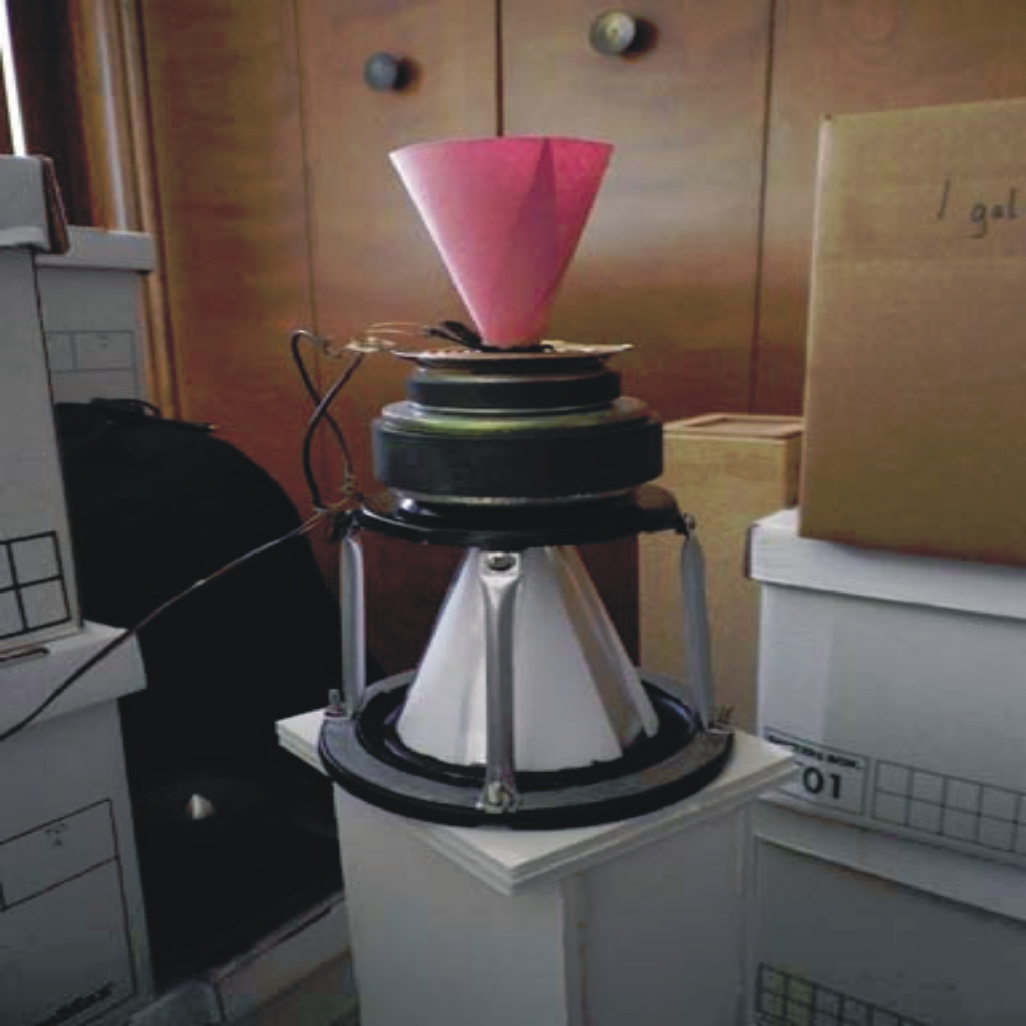

Mags, I was just considering that configuration; haven't built that style, but it was just a thought put into pixels. I've looked over the GP website, and they have a number of models that have a very small base (or termination, if you will). Contrasting that with the originals, the Ohm models, and the HHR; they have a 'medium' (Ohm) to 'large' (originals, HHR) one, more typical of a regular speaker....
One thing that I noticed when testing my drivers on the bench was that, since they merely had the 2 3/4" tall 'tail' of the PVC flange, was that when I'd pick it up while being driven, the 'character' of the sound would change. Well, obviously, since I was now hearing 'both sides' of the cone. The sound from the bottom now dominates; I reminded me of the 'megaphone (remember those?) effect', hollow and exaggerated.
Having them now on bases, their bass output still hasn't increased all that much. I'm not surprised since they're only 4"ers with a dinky magnet (I'm still jealous *L*) and not able to move much air about. OK...
Having this experience, I'd be happy to get ya'lls' '2 cents' input. What I interpret is that, in the current size I've got, is that the sound I'm hearing is the cone radiation 'ripples' as predicted in the Walsh patent. There's not much excursion occurring, which isn't surprising to me. The surround material I'm using is an EVA sheet, a material that on of its' uses is sound dampening. Which the patent points out, and was also pointed out to me by another source that plays with these things, is what one wants to do. That is, to Damp the bottom edge of the cone to stop or (at least) minimize the reflection of the cones' vibration back up the cone surface. This reflection would cause distortion as it meets the 'new' downward traveling waves/ripples....
Or that's what I'm getting out of all of it...

Mags, based on the above, that's why I drew what I did. If what I think is occurring as described above, one might put 2 units together in the fashion I drew. Would there be phase cancellation in a 'push/pull' config like that?
