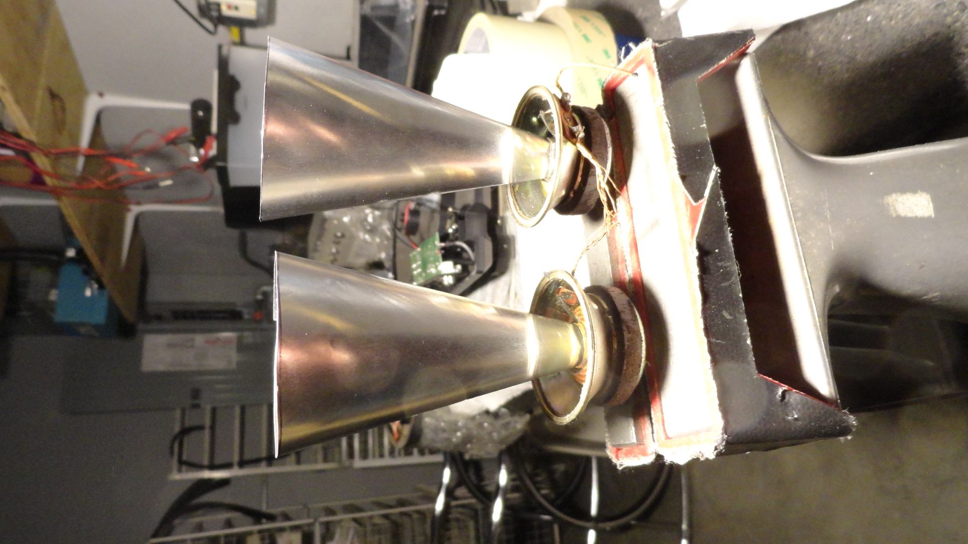

Osh, that's what I suspect, but I'm considering constructing a pair in such a way that they could be temporarily put together in that way to see if that occurs. If done in a 'temp' fashion, no loss incurred...
'Plug 'n Play', if you will. *L* It's just a hardware choice issue, and a pair of 'termination plates' as opposed to what I've been doing. Since these units (still in progress) will need a 'custom base/termination' anyway, that's not a big issue for me. Just one of those 'what if' scenarios, triggered by what I'm noticing from what I'm experiencing with the drivers I'm running.
Besides, I'm just stubborn enough to do it anyway, just because it'll sound funny when it happens. Cheap amusement with sound. *L*

The top portion doesn't seem to have a surround or termination. So I assumed it was taken mid completion.
Yes and no. I guess one could call this a "Walsh whizzer".🙂 Not ideal, but I always tamed them down a bit with a coat or two of rubber cement. A few of the larger cones I made had thin strips of foam rubber on the inside. It was easy to over do it with damping material.
But, the 64K$? is, did it work and was it worth the effort?
I tried using a small (5 inch. diameter) walsh cone handling the high freqs. supported by conventional woofers and, it sounded real nice to me. I think the Walsh cones can really shine in the high freq.

Jerry the design seems like it will cancel with opposite polarity and same pressure wave/origin. The edge damping is very important. There is a difference in how the wash and German physics drivers work from my understanding German physics speakers are more or less only bending wave speakers and the Walsh is less so as the design wasn't really fully bending wave capable which is complicated. Paper is this example paper is not good for bending waves in this configuration which is the primary difference between Walsh and physics paper vs carbon/ Titanium. The speakers cochleus is making are more or less radial cone speakers. Especially with the whizzer part making it obvious. I have a ton of information on all bending wave speakers and the like. Like mbl which is not bending wave. Cheap is relative for a diy project of this kind it is a little pricey They work well but advances are still being made and will not stop being made.

Actually, I've been toying with gluing a shaft vertically in the middle of the cone, and use it to affix an EVA foam disc inside the cone. Apparently that what the Infinity 'cone tweets' had at their larger end. For the longest time I thought they were foam filled...wrong, that would have damped the 'ell out of them. Got the EVA, just need to scare up a suitable shaft from my junk, which is scary enough. *L*

You're probably right about the phase cancellation, but the bases I'm considering for four of the next group I'm gearing up for (6 total, I like to do things in pairs at minimum, but since I'm 'in the grove', so to speak) will allow me to test it without any major fuss. Maybe I'll shoot a vid of it so y'all can have a chuckle at the phase going in and out... 😉
Garys'/Cocleus's speaker is essentially the same as mine, so essentially we've got bending wave units, clones of the GPs'...I'm still game to try a more 'Walshy' variant with a less 'steep' cone, but I'm going to hold out for a bigger diameter voice coil to push it about.
And you won't get an argument from me re damping at the surround. I've noticed that if I apply just the tips of my fingers gently on the surface, the 'character' of the sound changes and seems to lose some 'sibilance'. I tend to like a 'brighter' driver due likely to my ancient f'd up ears, but what occurs is more like inserting an eq into the line.
My completed Walsh drivers were terminated in foam surrounds. I know the function of cone end termination, L. Walsh makes that a major part of his patent.
The cones I make are the same angle (70') and the same material (0.002" high modulus aluminum foil) as the cones that L. Walsh describes in his patent. I also applied an internal damping material which is also in the patent.
I believe there are improvements that can be made, and even Lincoln Walsh himself gave plenty of latitude for that in his patent.
Making the cones out of some advanced material will not change the device. I've made several cones out of carbon fiber, they sound great, but it's the same device as with aluminum or paper cones (in the spirit of the original patent).
I Will link to the information I have on bending waves. The cone material is what drives bending waves as well as the termination function. The material must be high modulas with low density. The more the material is in inversely increased the more octaves the driver will behave in a bending mode function. This can be figured out with a formula. The steepness is to attenuate this function as the stiffness changes with slope. The shape allows for the dispersion of a range of frequencies. that are made at specific point along the cone. The length of the cone is also important. As it relates to the dipole frequency. There needs to be a some what rigid termination which does not seem to be in some of the pictures. Please correct me if there are terminations in the finished models. The benefits of the bending wave speaker are two they allow for near perfect impulse response as the wight of the cone is almost not relevant. There are closely resistor based speaker functions as opposed to capacitance and inductance. They allow for omni dispersion. All this cannot or hasnt been done to the most of the ability. Generally the voice coil is the only weight to be factored. The termination is very important there are lots of ways to achieve this and is something of great importance to me in my clone. The design must be well done to allow for the full ability of bending waves and thus transient response.
The are a host of upgrades which can be made to the conventional bending wave transducer . Like the walsh driver. With only a clone of the cone and termination there is still quite a bit more to do. Even then I dont know how well the Walsh driver functions. If anything I have said turns out to be mis worded or incorrect please correct me. There is only one function which stops mbl from being bending wave. Anyone got a clue? The patent seems to be super extensive and is the most information filled paper on bending wave speakers.
My approach to terminal reflection was to fabricate very light yet large cones in order to radiate as much sound energy as possible. This has the added bonus of efficiency. The last carbon fiber cone I made weighed in at less than 8 mg/sq cm, including an internal layer of latex damping.
