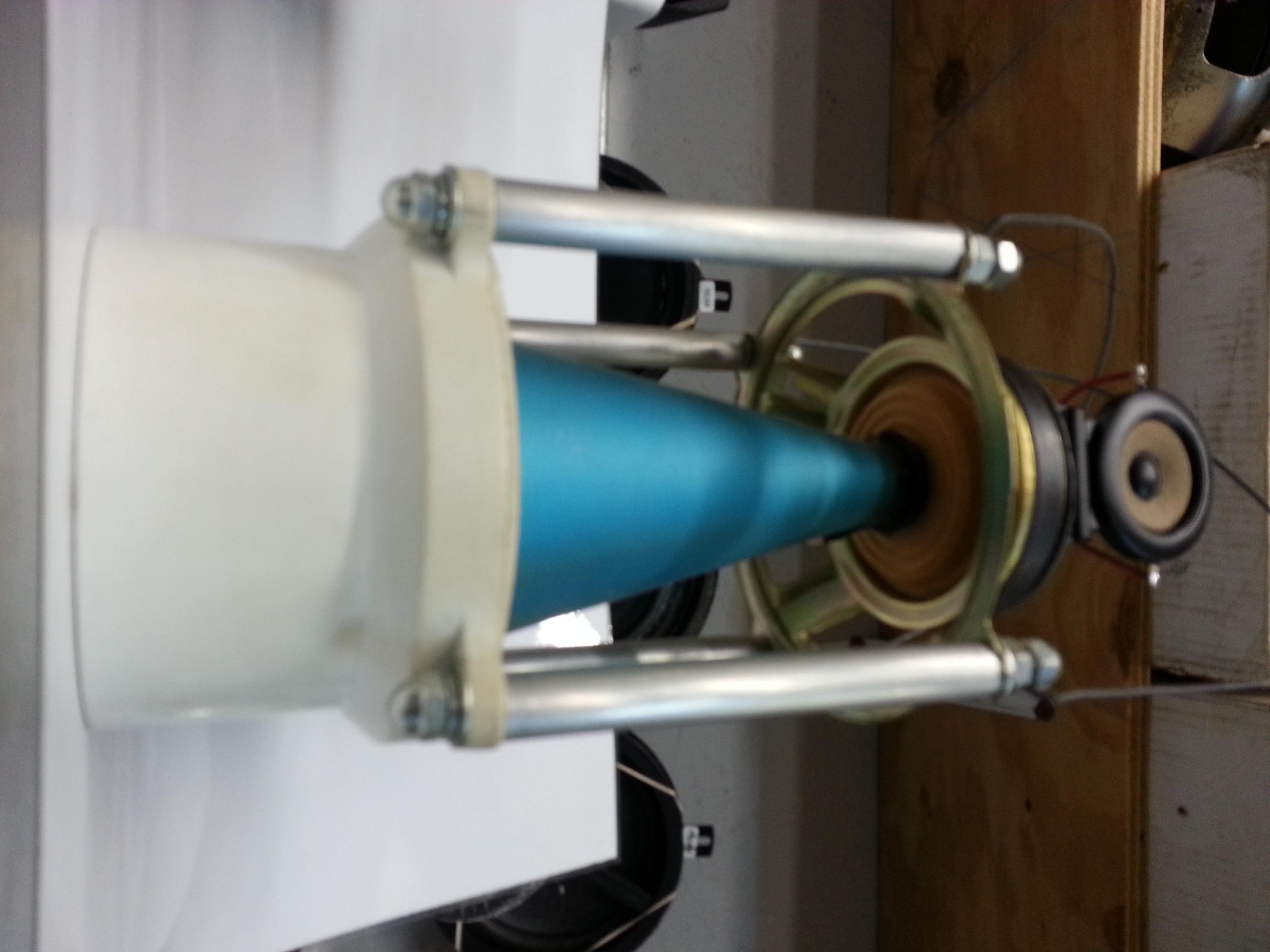

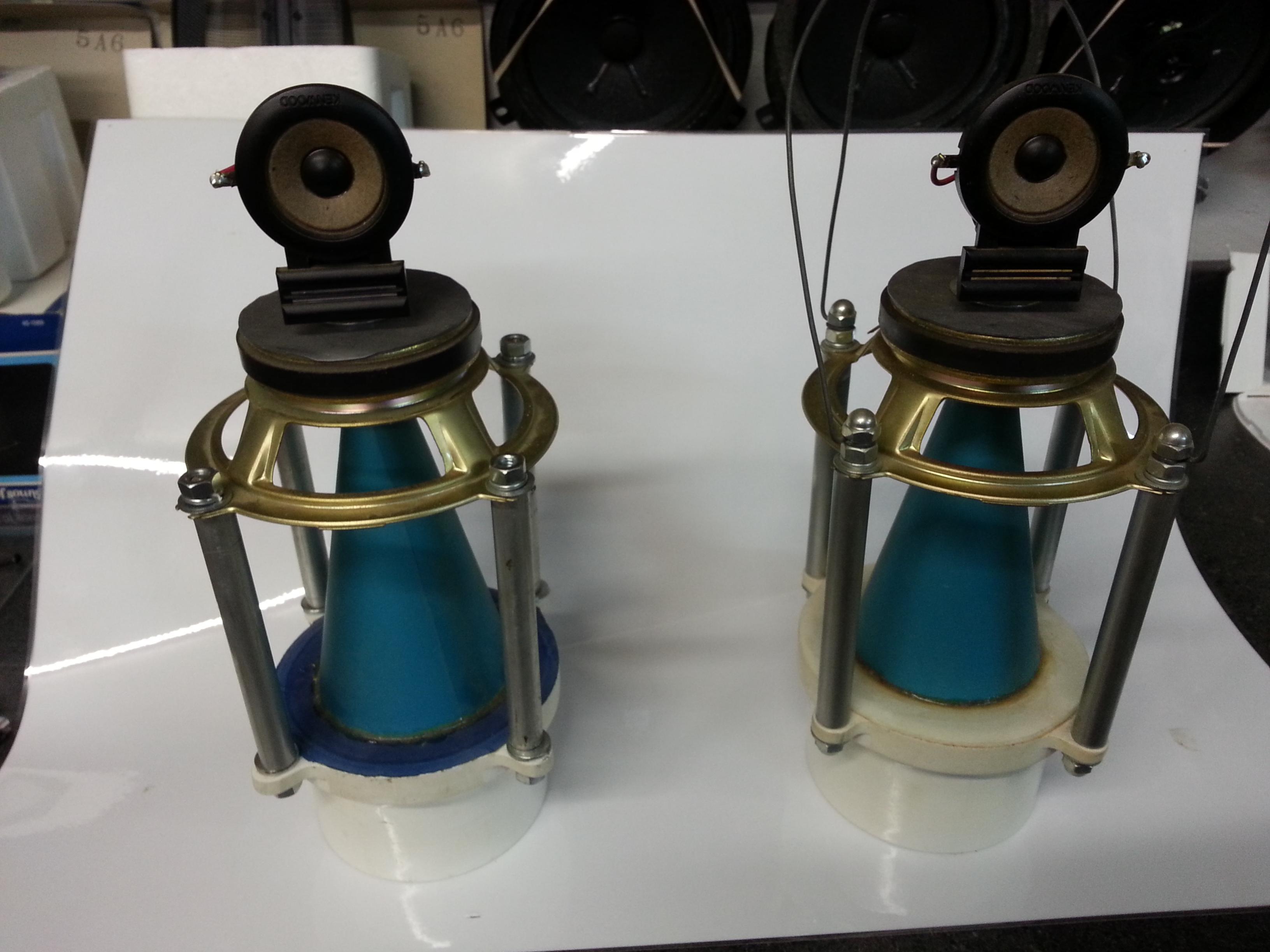

Cretinish, no CREATIVE play...
Well, hi there, Cochleus. I figured somebody's still wandering in and wondering if anyone has been goofing about with the DECware/Conus approach to 'creative speaker repurposing'. Well, guilty...'course, I did these some 8 years ago. Dug them out of storage from moving 5 times in that interval. Finally have the space and motivation to push on to 'bigger/better/louder/all that...
"Submitted for your consideration", as Rod Sterling used to say...
The blue/green cones still make me grin.
