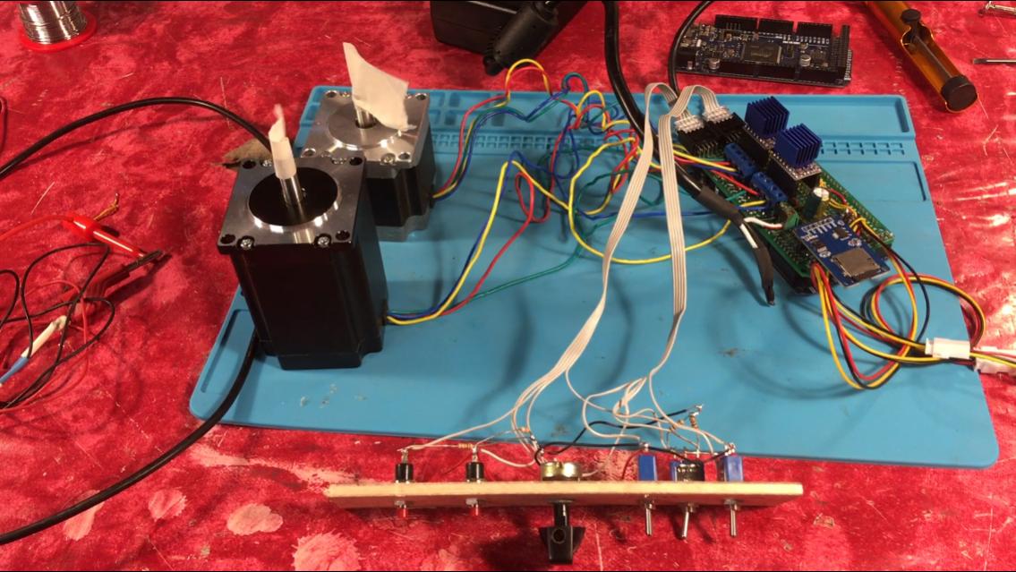

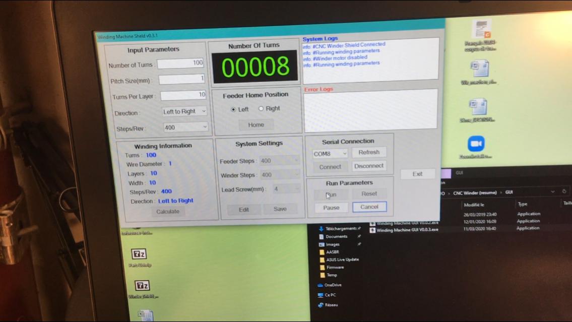

My try:

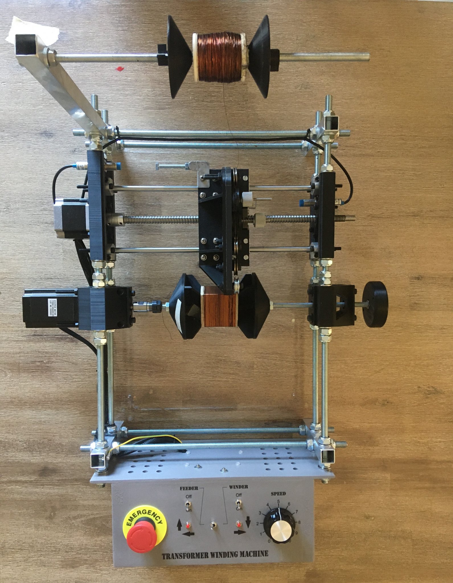

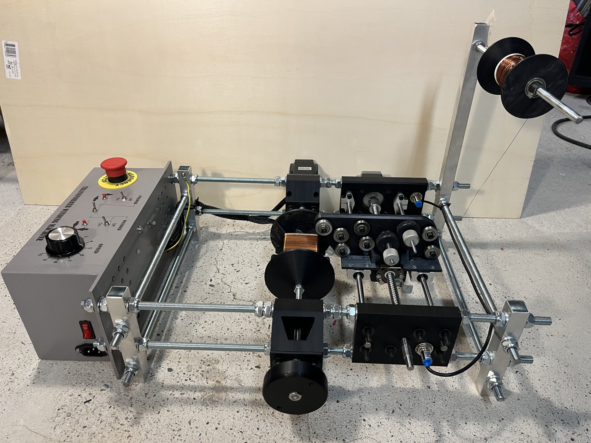

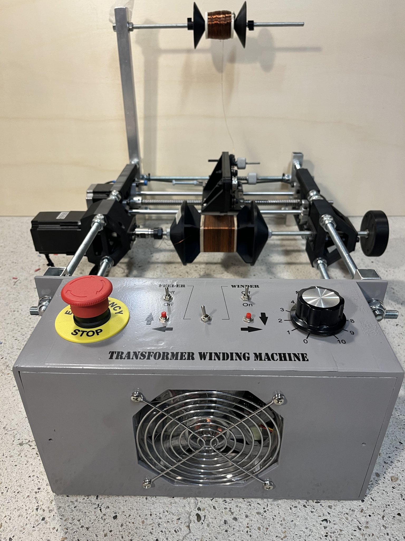

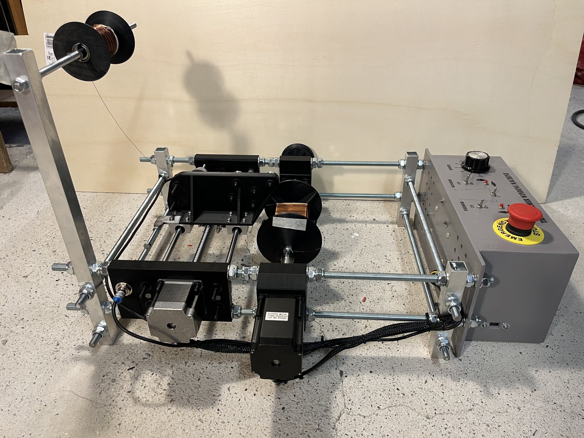

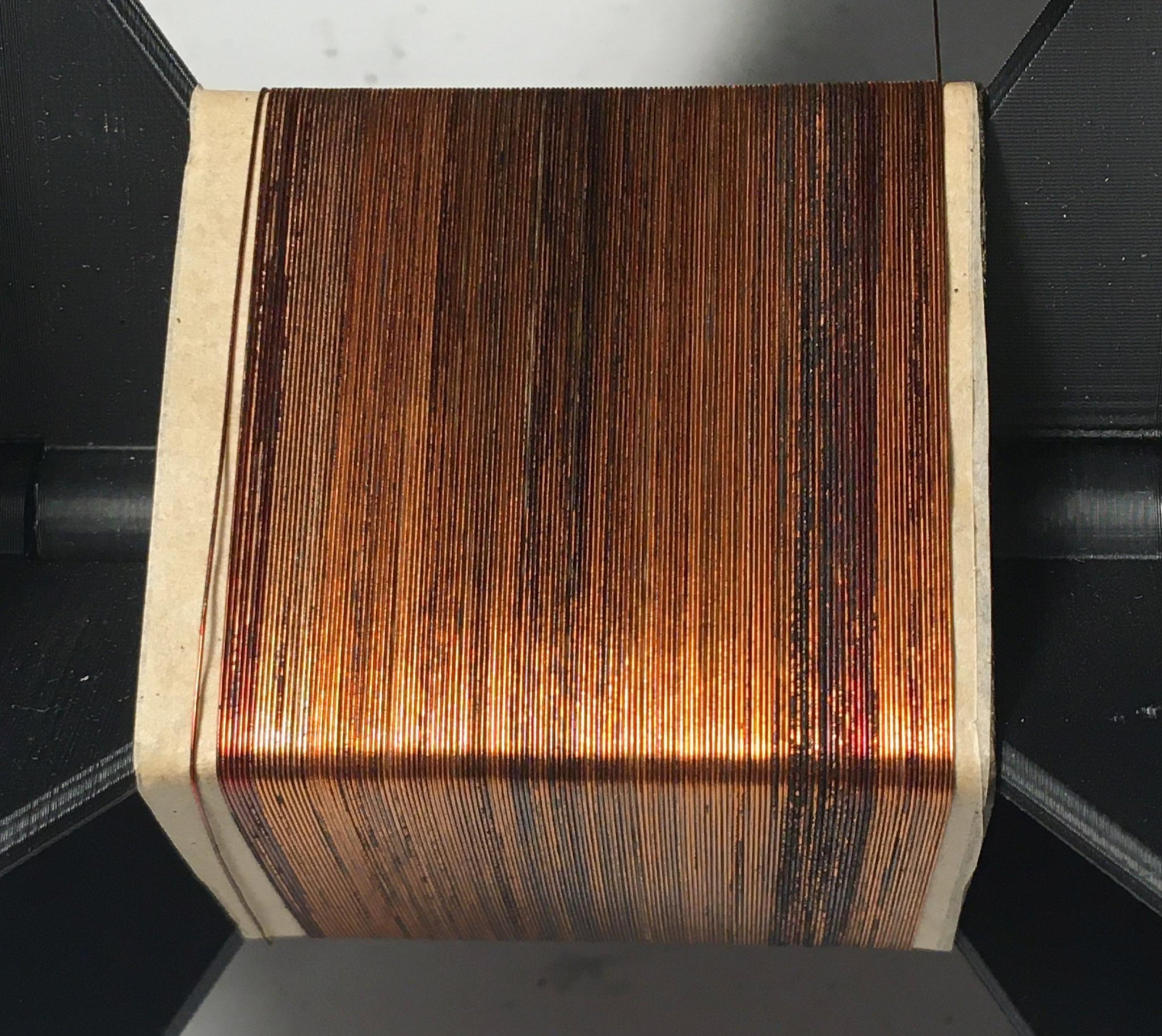

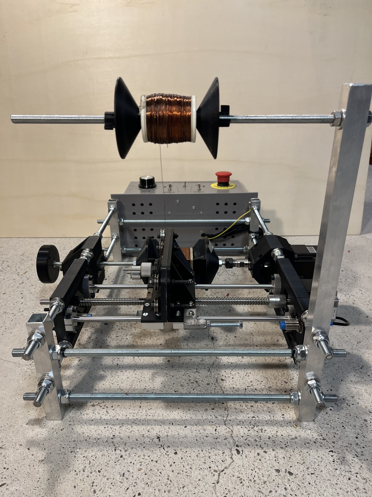

Mono and bifilar transformer winding machine :
This is the version I buid for transformer winding. Particularly, vacuum tube amplifier output transformer. Software and firmware made and modified by ghemml.
ABS printing parts and 10mm rods frame for easy DIY and low cost. All 3D parts are design with Freecad.
I use conventional stepper motors but closed loop are better.
I made it for bifilar as I often need it.
General dimensions without control box (approximately) : 52cm (width), 55cm (length), 40cm (height with reel support)
All STL file and updated PDF on FB group : https://www.facebook.com/groups/804317050166139/?ref=share

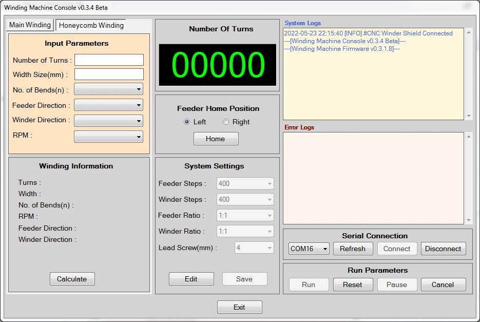

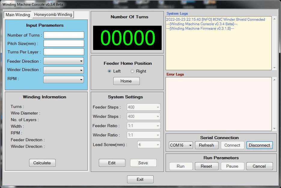

Latest Beta release:
  • Winding Machine Console v0.3.4 beta
  • Winding Machine Firmware v0.3.1.8
  • Added Feature for Honeycomb inductor winding
  • Honeycomb winding will now limited to 60rpm max
  • Speed selection now changed to RPM
  • Microstepping setting been reduced to 200, 400 and 800
  • Controller firmware optimized by removing underutilized parameters
  • Speed ratio setting now reflect as 1:1, 2:1, 4:1
  • Lead screw setting now allow user to select 1, 2, 3, 4, 5(mm)
Winding Machine Console v0.3.8 beta download
Winder Shield Firmware v0.3.1.8 download

Photo of the winding machine and the user interface.

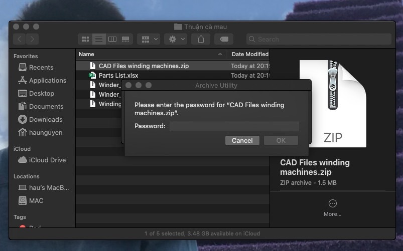

Hi Ghemml, do the actual aluminum/stainless steel parts that make up the machine have to be made or is it a kit that can be bought? I'm very interested in making one of these as I've been building subwoofers for years and with the price of voice coils going up over time, this might actually save me a buck. Thank you for posting this
