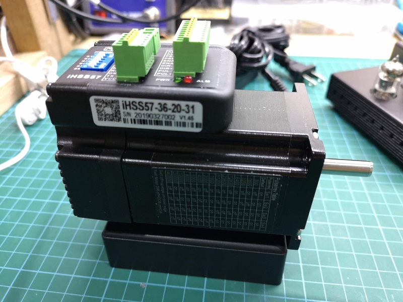

The encoder which you mentioned is called Closed Loop controller in industrial terms.
I have a pair of Closed Loop Hybrid Stepper motor, Nema 2 size. Integrated contoller fron Aliexpress. 2.0Nm torque shold it should be enough to handle at least 18awg wires.
And probably will be upgrading to Arduino Due as it has a 84mhz compared to my current 16mhz Mega.
Arduino Due PWM reaches 8mhz, maybe more than enough for the Closed Loop Hybrid Motor.
800 microstep for the hybrid motor and with Arduino Die, i should be able to reach 600rpm or 10rps.
Currently this machine can achieve is 150rpm using DRV8825, which is bloody noisy.
You should try Arduino, it is very user friendly Microcontroller.

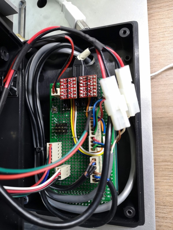

For my design also, there is no need to know arduino or programming. Maybe know how to upload the sketch to an arduino and basic wiring.
All the visual basic and arduino code are for DIYer who wants to customize it.
Otherwise, my share drive contains the executable .exe file for Graphical User Interface. And the arduino code probably just flash into the board.
I also uploaded all the AutoCAD files for the parts fabrication.

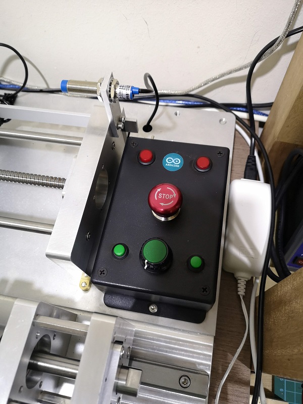

I have a habit of pushing my design to the limit. Therefore for this CNC winding machine i am very concerned about backlash, noise, vibration and heat on the motor controller
For performance i wish to achieve from the current speed of 150rpm to 600rpm. One reason why i bought the closed loop hybrid stepper motor.
For the linear shaft ball slide, i wanted to upgrade it to linear rail slide. To make it super rigid.
Antiback lash for the ball screw to achieve 10 micron accuracy.
And finally the User Interface logic, which i still trying to understand fully how a user point of view will want to see and have on their graphical interface.

By then i be using closed loop hybrid motor, it can go all the way down to 51200 microstep and use Arduino Due(just in case)
Maybe need to upgrade to a better accurate ball screw
Smart iHSS57 36 20 CNC Closed Loop NEMA 23 Integrated Stepper Motor with Driver Step+direction 57mm 36VDC 2N.M #SM749 @SD-in Stepper Motor from Home Improvement on Aliexpress.com | Alibaba Group
