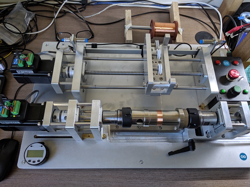

I'm lying a little bit, because i moved to a custom designed carbide ball slipper that offer a better consistency than conventional friction slippers.Hello, On my nano coil winding machine

This is before i upgrade to a closed loop hybrid motor
Those motors are enormous, why chose a stepper for the winding spindle? Surey you want torque control and steppers cannot provide that.
It is a closed loop hybrid motor not a stepper motor.

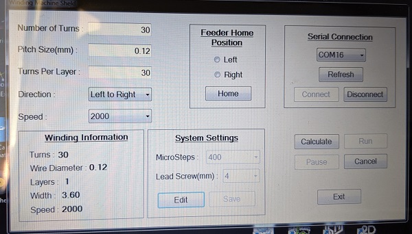

Wire diameter: 0.1mm
Turns: 30
Pitch: 0.12mm
Speed: 60 rpm, 240 rpm, 300 rpm

Photo of the winding machine and the user interface.

The winding machine is capable but largely depends well the bobbin design is.

Clearly you do not understand what type motor I am using now.
Using stepper motor drivers like AD4988, DRV8825 or even the trinamic tmc2130 are just crappy and lousy way of designing a CNC winder. Overheating, lots of noise and vibration except for trinamic drivers.
And probably you do not understand what is C5 grade means on a ball screw. I can achieve 10 micron accuracy based on my current design.
