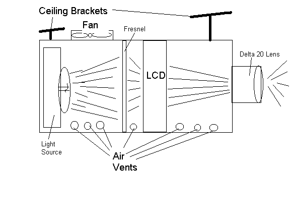

Here's how im planning on building mine. Its a pretty crude diagram, but i think it gets the main idea accross. Do you guys think it'll work ok?

Thats almost exactly how i plan to build mine. What light source are you going to be using? im thinking of Mercury Vapour bulbs atm. 13000 lumens and cheap.
Anyone know anything about these bulbs, and how hot they get?
Also, the Delta lens. Im just about to order one, but what is the throw distance like on this thing, surely being from a rear projection tv it would be short (?)
Thx very much,
Thelaw, I havent decided on a bulb for sure yet, but Im leaning towards a 300w slide projector bulb. They only cost like $20 cdn (approx. $13 usd) and they throw a lot of light.
As for the delta lens, i was thinking the same thing, since its rear projection, your projector will probably have to be pretty close to the wall you're projecting on, otherwise the image would be too big. I'll have to wait and see, though. My delta 20 lens should be arriving in the mail on monday and my LCD panel should arrive soon after.

Your diagram looks good! The only problem I can think of is using the Delta 20 (or any projection lens assembly, or that matter). I still haven't figured out how to use these without placing them nearly in contact with the LCD. This is a problem when using an LCD that is larger than 4" or so. They also have a very short "throw"...my Fujinon and Delta lenses produce a very large image in a short distance (maybe over 100" at 5 feet distance? I never really checked, that's just an estimate). Has anyone had success using these lenses with an OHP panel?

For my LCD (only for testing) i have a DSTN from a handheld TV. If i'm happy with the results i get from testing that, i will get a more expensive casio tft lcd handheld with composite inputs about $120.
I really need a lens with a large throw distance 🙁 maybe the delta ain't 4 me 🙂
