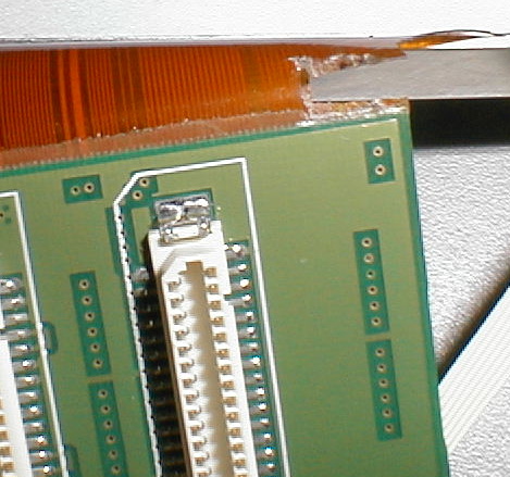

torn ribbon
Hi Joe
If it's the copper coloured ribbon, all you need to do is scratch away the coating on the broken tracks one at a time, it should be copper underneath, get some of the right flux non corrosive type, tin each side then link together. I've done it to mine as well different board same problem. A good stead hand will get you through.
Don't lose heart, can be fixed.
Cheers😀
Jason
Hi Joe
Cheers😀
Jason
The lady tried that...
She scraped and tried to solder, but couldnt get it to wick onto the cable. The only way is to find the source pin on the connector plug (easier) and then the destination on the panel driver chip PCB (more difficult). I have a microscope, so, it may be yet possible as others have suggesed.

Yikes
Joe, wow, that sucks. I think this is at least the 3rd complete lcd panel disaster that has happened to us here in the DIY thread. Funny thing you posted that the day I got my panel.
Anyways, kinda of turing point for me today ( I guess you could call it a step back...) I just got my new Viewsonic VG150 moniter, and while I was explaining this to my girlfriend over the phone how great this thing was, I started realize how much all this was costing me. I'm mean I haven't even bought the MH light or screen yet. I think I'm going to have to wuss out and get a 640 x 480 or a 800 x 600 lcd projector panel, I should be able to ebay my vg150, and cover my losses though.
