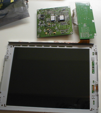

The tiny cable toward the lower right corner is the problem, as the following proposal for a board arrangement illustrates.
This cable is 20 pins, spaced on the LCD at a solderable 0.05" pitch, however on the driver card they used the tiniest connector imaginable, with a spacing of probably 0.02. A long cable would have to be built to go from the driver board, as shown, all the way down to that small cable. Whether this would effect electrical signal timing is ??? There are some square labled pads similar to that shown in a previous reply - but not 20 of 'em...
The big cable at the top of the driver board is much more durable to folding, etc.
So I put it back together and it still works - using it now to type this in. Until I get a reasonable solution to the problem of that small cable, it'll probably stay together. BTW, color and response time are both excellent!

Guess there's not much interest in the VP140 insides... After I resized all those !@*^%% pictures to be < 100K...bastards!
Anyway, for those of you who are actually interested in this particular panel monitor, but perhaps unwilling / unmotivated to say anything at all about it in response to my posts, I have the following FYI -

Thanks for the pictures of your LCDs guts, I'd love to have one of these monitors, especially at that price, The cheapest LCDs are around £300. Too much for a poor student like myself.
Anyway, thaks for the pictures, at least I've an idea of what I'll be doing once I find myself a display.

jjasniew, in response to your photos, I loved them...Thats exactly the kind of things I like to see and I plan on trying to do the same with my project.
Since you seem to want to talk about it I have some questions...
It seems to me that you end up with a completely unobstructed view through the LCD with the circuiboards where they are in your last picture...I know the cable doesnt allow you to move the board much but cant you get around this fairly easily by just mouting it perpindicular to the LCD? Or am I completely missing the point???
I dont remember who it was that was using the VG150 project...but does it look quite similar to this??? I never got to get those pictures.
I had been looking for a 15 (preferably smaller) monitor with a higher contrast ratio than 350 but cant seem to find any undre $500 so I had anticipated going with the VG150...but for $150 (MY GOD IS HE CRAZY) I may have to go with the VP140 and screw the CR and Response time for now.
Please Please Please tell me if I am right that there is an unobstructed view throught the display but the PCB relocation is quite limitted.

Yes, for the vp140 an unobstructed shot through the LCD is possible - provided you can solve the PCB relocation cabling problem.
This of course implies that you can simultaneously solve the mounting and cooling problem for both PCBs, so that along with the panel, it all fits atop the OHP.

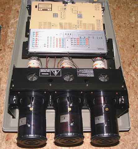

I'm seriously considering bidding on a 9" CRT Barco on ebay. Here's a picture of the insides, for all those going the 3X CRT route, as an example of such an arrangement -
I think the 50X brightness over normal you'll need to see anything on a big screen show may not be possible, w/o some real special tubes. The tubes in the Barco shown are liquid cooled, because there's so much energy hitting the phosphors to get the required brightness. (Take a straight-on look through the LCD panel atop a 7K lumen OHP, to see how bright that really is...)
