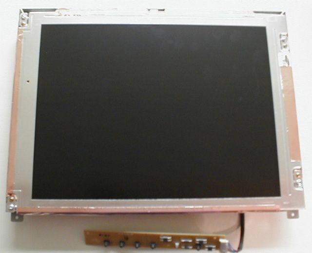

Got my VP140 last night...looks like it has an achellis heel, as far as moving the panel driver boards out of the way...
These photos will show the drill down to the problem. Here's the unit out of the plastic case -
