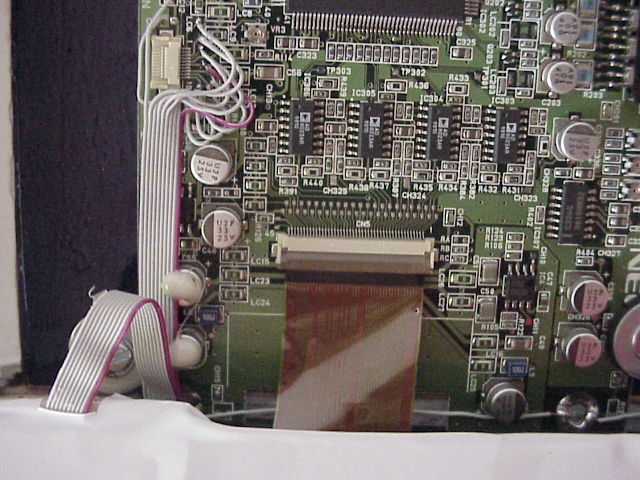

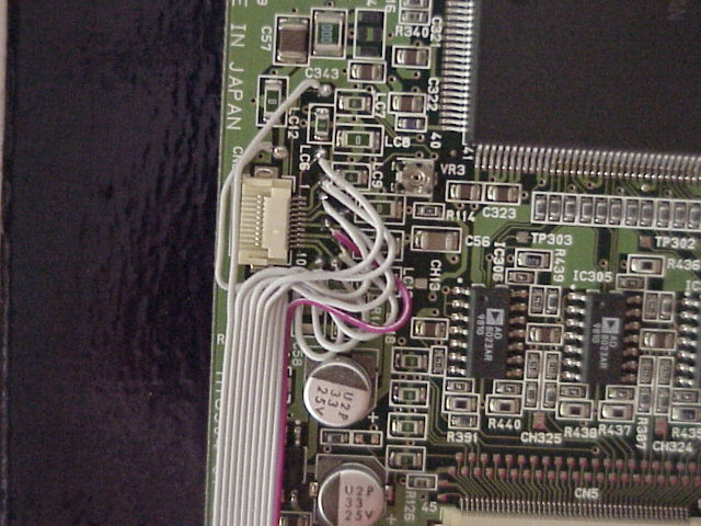

The TFT I used was a NEC Multisync 400V. The difference to the NEC Multisync 400 being a narrower viewing angle. While the viewing angle of my display really sucked as a monintor when I tested it prior to disassembling it, this really does not matter in a projector. BTW I did state that in my first post but I know about that searching issue... Since the display had to be mounted in a tilted position I had to mod the OHP housing. Although I did not plan on doing that in the beginning, I am now glad I had to, since I think it looks better than a cubic housing. At least a littlebit. Repeating earlier posts:
I first wanted to elongate both the 10-pin and the 45-pin ribbon cable. The ribbon cables are both 0.5mm pitch. I tried soldering on that and failed, it was just too close together. Thus the tilted design wich allows for the 45-pin cable to go without elongation. Luckily on the 10-pin cable there where spots on the PCB for everyone of the 10 connections. These spots, little (maybe .5*.5mm) are used for testing the unit after manufacturing I think. These spots are present on the Display-side PCB and the main PCB so I could connect those using a 80-pin UDMA 100 Harddisc cable. (Only 10 pins of that of course). The pitch on these cables still is slightly larger than .5mm so connecting the 45 pins of the other flexcable would have been really difficult even with soldering points...
If your display has these points, too, consider going this route (I don't know your soldering skills, of course...)
Use a soldering needle (those 12 volts 5$ ones) to apply little "balls" of soldering "tin?" to the points, which you apply soldering "honey" to before you start. (The honey being an ACID FREE) product. Then use an average soldering iron (very fine tip, I ground mine to be needle-sharp) to just liquify the "balls" one by one and push the "silvered" cables into it. I really don't know if it is nonsense voodoo or not, but I heard people say when soldering on sensitive electronics you should heat up the soldering iron and unplug it before touching the PCB with it. I did not do this on the display side, but did it on the PCB side and my unit works, what can I say.
I did take pictures of the display-side soldering, but with a normal camera and presumably it will take years for them to be developes. It is not that interesting anyway. I did take digital photos just now of the PCB-side connection. Hope they help.
