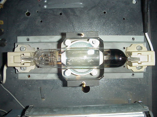

Alright, now I am able to post pics.
jjasniew, althoug I think (see my last post) that it doesn't make a lot of sense to go and look for the exact same parts just because they work for someone else, that probalbly doesn't apply to the lighting. So here are the specs for my bulb and ballast.
Bulb: Osram Power Star HQI-TS 400W
Ballast: May & Christe QI 400-03.2H
Don't look for the parts but for a whole lamp. I got one for 8$ (I was VERY lucky with all parts) off of ebay. It was a very shabby convolute of 10 of them but I only bid on one. You can also buy Sodium discharge lamps, which generally are a bit cheaper on ebay because there are no aquarium guys wanting to buy them, which is the case for HQI-Lamps. For the Sodium-lamps you may have to buy a new Ignitor-coil (just translating to english word by word...) since there a two different types. One (Pulszündgerät) that only works for sodium-lamps and one (Impulszündgerät) that works for HQI and Sodium. The bulbs are fairly large. HQI-TS has sockets on both sides and the bulbs are SMALLER. HQI-T are screw-in bulbs (onesided) and are said to be a bit more spot-light. However they are much larger (same wattage), so forget them. First pics are of the lamp in the housing of the OHP and of the ballas on the outside of the housing. Screwed to the top of the housing is the ballast for the display (silver-grey). Everything below that is the electronics for the lamp wiht the big green thing being the ballast. More pics to come.

Pics II
In case you wander why the lamp is crooked in the above picture, it's not fixed, yet. It was fixed exactly below the center of the fresnel, but I now found out that the picture gets a lot sharper when it is fixed slightly offside. Dunno why. Anyway second pic, closeup of the bulb, with a frontside-mirror fixed below it. I don't think it does a lot of good, but it came with the OHP, so what the hell.

I think I can offer an explanation for why you need to keep the mirror and also have the light source off-axis.
The concave front surface mirror is actually creating a diminished real image of your light source - thereby getting you closer to a point source. This diminished image is closer to the mirror and with the results you are getting, appears to be located at the focal point of the original setup of the OHP.
This is what happens when an object ( the light source in this case) is placed outside the center of curvature of a concave mirror.

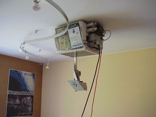

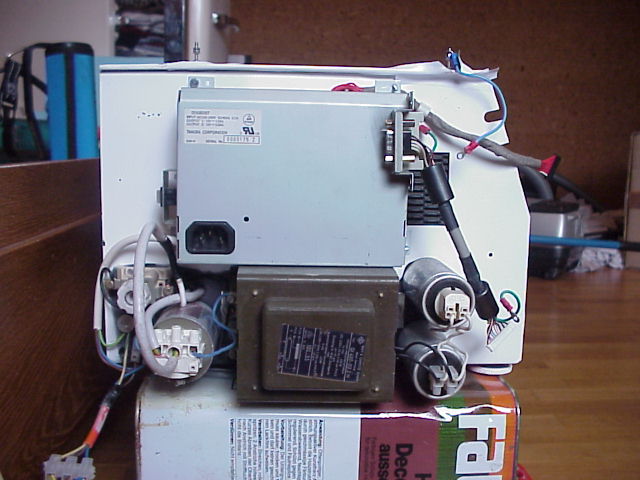

Done.
last night I enjoyed my projector for the first time. I watched football and movies with friends and it rocked. Some things that have to be adressed:
It was not possible to go with the f=400mm lens in the end. It did not work with the fresnel or some other part, my knowledge in optics is not sufficient to figure it out. So I went with the original lens setup, thus I had to mount the projector not on the opposite wall but more to the center of the room. While this is not really nice to look at, I can deal with it.
While I would still recommend my lighting solution, there seems to be a considerable drawback. The picture is a littlebit blurry at the outside. It really is bearable and movies are very watchable, but when projecting my desktop, the icons at the outside are pretty blurred. I think this is due to the bulb not being a pointlike lightsource, so there really is not a lot I can do.
Now I have to mount the cables, build some more housing, make the projector's "arm" detachable and paint the opposite wall partially white. That should do it.

Frankbatzen!
Your pictures are very encouraging, looks like what I want to do in the end as well, thank-you!
Could you post some detail around the LCD mounting and the cable hookup to the driver board? I can see that this will work (conceptually) via your last photo, but the details of how you "swung tthe driver boards outta the way" would be most interesting, pix being worth 1K words...
Also, the brand and model of the LCD panel, might help others decide on a purchase, simply being based on that you're shown it's possible! (If you've posed this info before, I apologize for asking again - this forum should have a search for all entries by user function)
