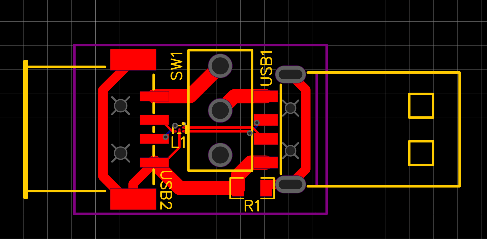

since there are no warnings about this on RC filter guides i guess the statement above is trueor if it just lets 500mA trough and essentially heats up "because" of the 500mA.
it also makes more sense since the resistor itself would need a direct ground connection to actually "burn" wattage which is the case in a voltage devider for example
So i guess i will buy some 10 ohm 5W resistor to test this with my current boards maybe there is also a audible difference because the DC filter frequency gets shifted even further down with a resistor

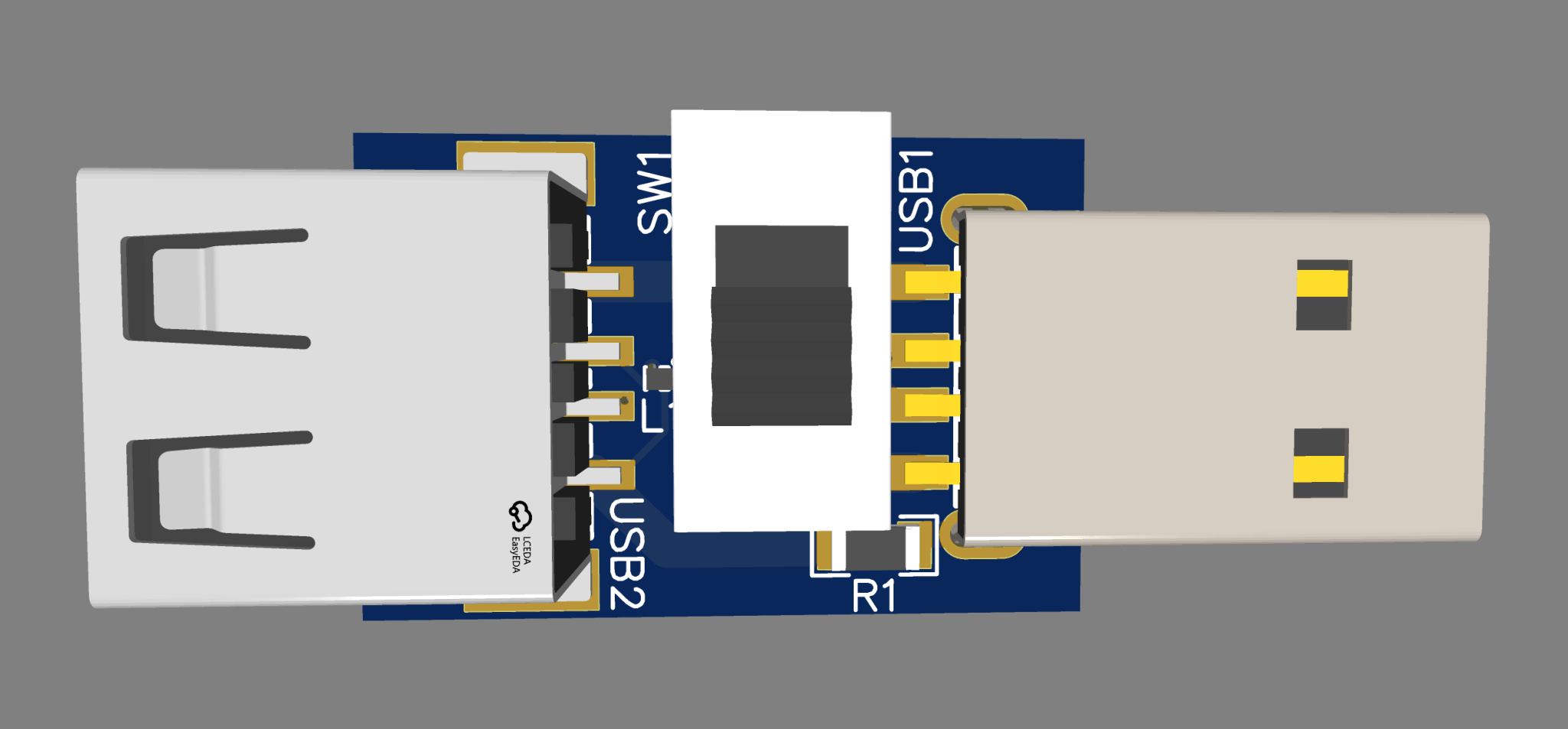

i just need to cut the trace from switch to supercap and solder a resistor from supercap + pin to the right switch pin
i just bought these: https://de.aliexpress.com/item/1005005621955006.html 10 ohm 5W metal film ones, metal film seems to be a good choice from what i read and im not too concerned about quality with resistors (since i bought on aliexpress) ...
Also the CDA supercaps arrived yesterday, unfortunaly with some bent pins but still useable

if tests dont go wrong you get a fully working prototype with the resistor, so no risk in frying usb ports... i probably can finish them in around 7-10 days when the resistors arrive
the other issue with ground resistance has to be avoided manually, just set the ground passtrough switch to on as long you use PC power since i cant gurantee that the dac is grounded elsewhere in each setup...
if you use a external power supply (or know what you are doing) you can play around as you wish

Soo, kinda bad news
resistors arrived and i think i got something wrong theory-wise ... even with 5 ohms resistance, after plugging the dac in voltage dropped to 2,83V
Tho, im not quite sure how i calculate the voltage drop, seems like RC filter just can be used on static loads where the load resistance is known?
Question now is what we can do else for a next revision... IMO a power switch IC is the simplest solution here i think and actually would offer different settable current limits, so the usb filter could be used as a nice 2A power filter only too, larger capacitances should be no problem with this solution either

About the Prototypes... i think i will have to send them out like they are now, with the risk of overloading the power supply, tho like i said before, i have no problem whatsoever using a Ifi power X 5V 3A power supply, the charge process only takes a few seconds, but i havent tested yet what happens if you charge the unprotected cap with a low power power supply like from your usb (500mA), i think some will shut down because the cap charging looks like a short
if people feel safer i could remove (or glue) the voltage selector switch, so PC power cant be used at all and you have to use a external power supply
