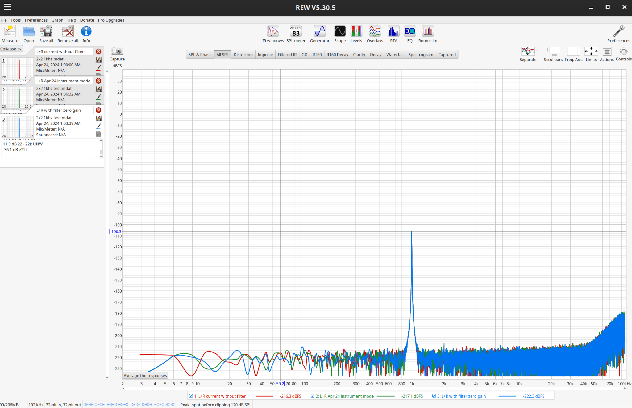

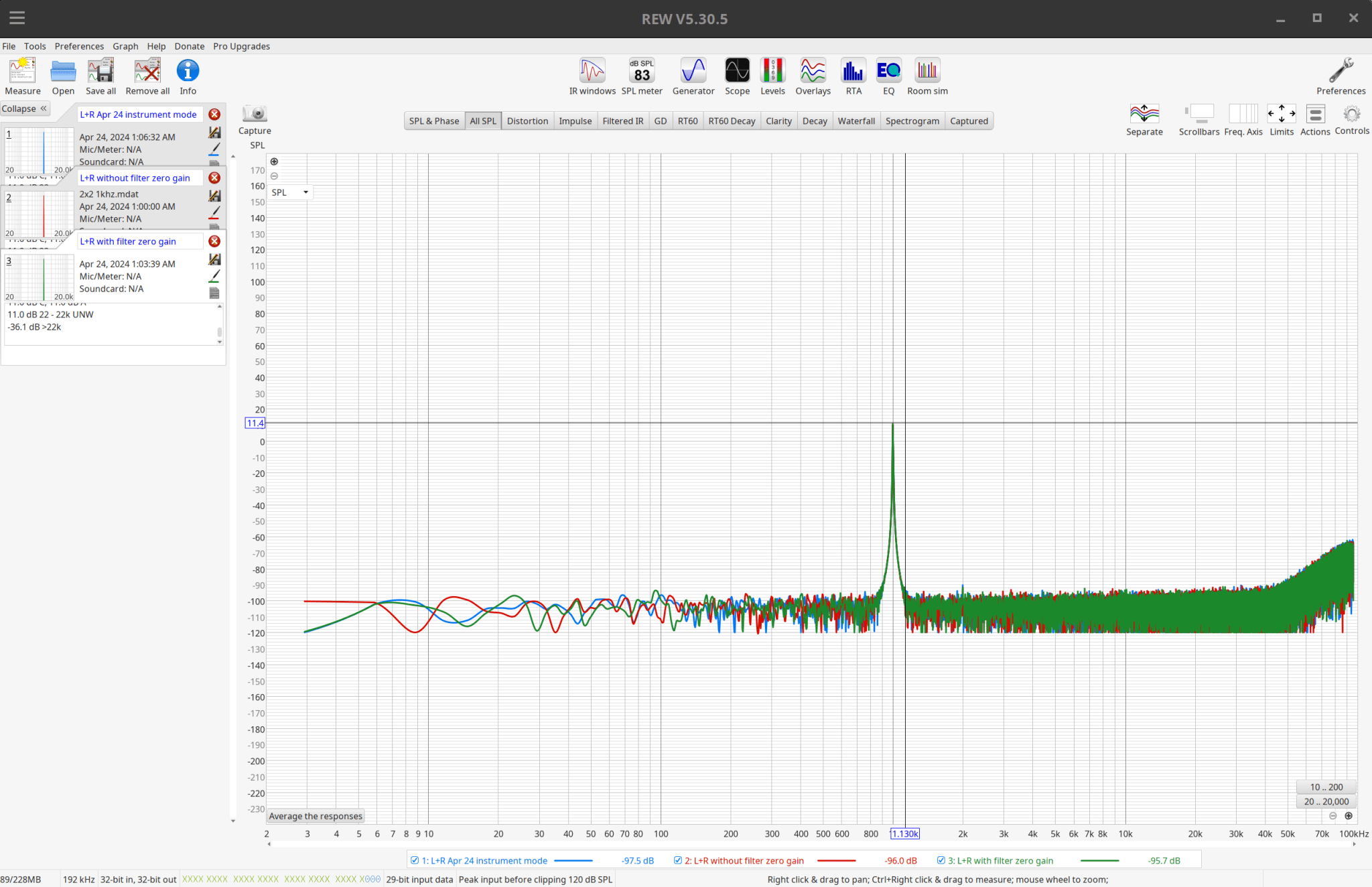

hmmm my first ADC measurement... tho i did soom roomacoustic measurements before...
but im unsure if i got things right, the results look different from amirs
this is -106db noisefloor , i set the generator to -5db and didnt had the volume knob turned all the way up, i just hooked up a TRS to XLR cable from output to input on black lion audio revolution 2x2 with zero gain on the input, so with generator volume and volume knob compensated we probably land at -115db
Do i have to set the generator to generate harmonics or something? or the noisefloor might be to high, i actually see a blip at 2khz
edit: instrument mode measurement was with filter too
and yea... basicly no difference... maybe under the rather high noisefloor but i think i can just verify that nothing got worse (above the noisefloor)
but it actually showed me that amir's measurement of the noisefloor looks far worse from a scale perspective than mine, this was one thing i was worried about but 100khz still sits at -70-80 db...
i actually think that a higher noisefloor might sound better if there is no "crap" sticking out
It tells that there is something wrong in you measurement setup. Generator level was -5dBFS and RTA records -106dBFS. Also noise floor is far too low.
i dont know the noisefloor doesnt get shifted if i try to calibrate on the top of the RTA window... tho in the end it doesnt matter much, i just wanted to show differences, which are nonexistent, the db/spl values still seem applicable

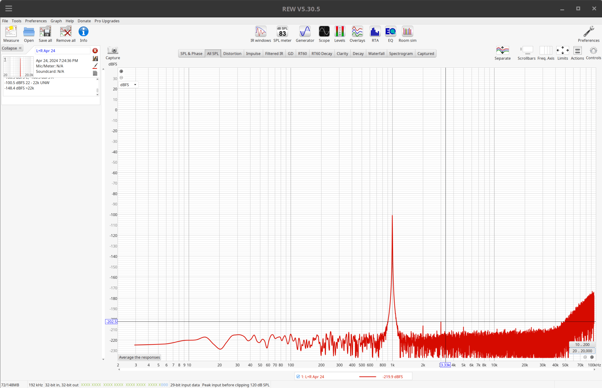

here i did a measurement with generator set to -4db and volume knob on max... this should give 8.224 dbu (since the dac output is able to produce 12.224dBu, where the max mic input at min gain is 8.6dbu
i calibrated the generator to 8.224 dBu (if this matters)
H3 is around -102db

I've had issues with pulseaudio so I usually disable the audio device in pulseaudio just to be sure. Anyhow you need to solve the issue with your setup if you are going to use it for measurements.
well since its only a scale issue i dont think its that crucial to do some quick and dirty measurements
but i actually noticed too low levels too with room accoustic measurements with a Umik-1 since i use linux... i dont know what goes wrong here but since i didnt use the measurements "directly" but just for doublechecking where roommodes lie and what Q i need i didnt persuit to troubleshoot this crap...
