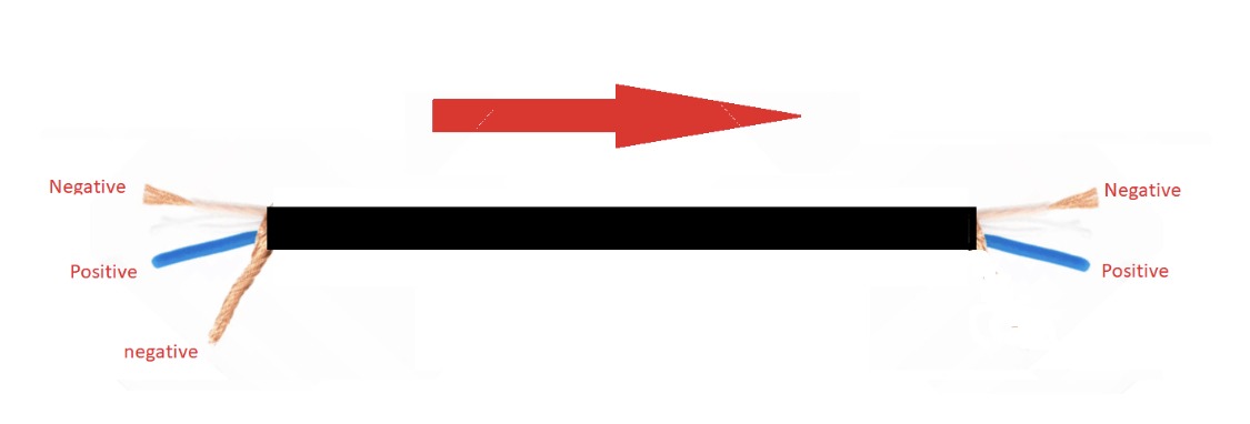

If the arrows are indicating signal direction (source to load) then they are correct. Ideally, the shield should be connected at the low impedance end, which is usually the source. This is especially important with tonearm cables to prevent hum, but in practice I've observed that it makes little difference with line sources. YMMV.The arrows should be in the other direction.
- Analogue Source
- DIY Turntable RCA Cable
