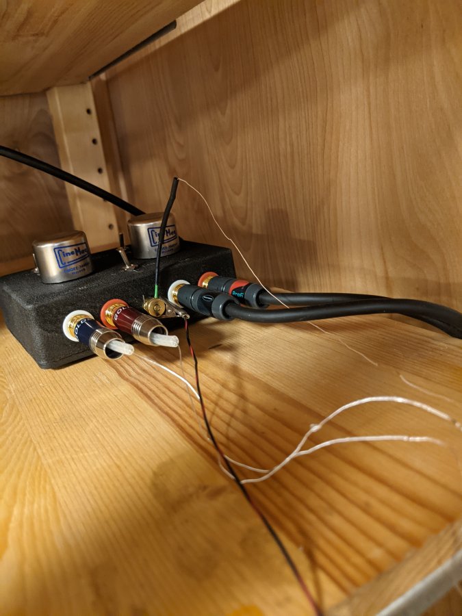

I changed my turntable interconnects to Mogami 2965 (dual version of 2964) as it has low capacitance for my MM ( 57p/fm from Mogami specs). Previous cables where diy silver and a braided shield, so probably would have had higher capacitance. Mogamis are silent.
I have some KLE harmony rca plugs i got for friends rates some years back. I am curious, and hence reviving the thread. If the phono signal is low, does it pay to use better rca plugs (higher copper content) . I was thinking for the other turntables, about using good old Switchcraft rca plugs (which i like - tight fitting , nice dull gold plating)

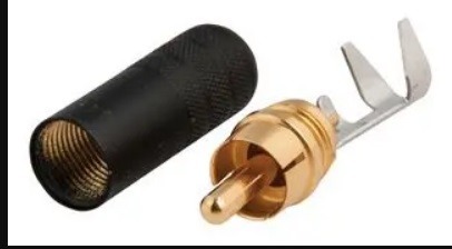

Then its not gold! Gold plate is 100% gold and never tarnishes - its wears through though...nice dull gold plating
Gold plating that is dull, or at least non-shiny, is not necessarily related to tarnishing.
Seldom is gold plating applied directly onto an electrode; usually a sub-layer (or intermediate layers) of metal plating is applied first, and the gold applied as the final layer.
The shininess of the gold plating is greatly affected by the composition of the sub-layers (as well as the surface finish of the electrodes themselves).
Assuming the same level of surface finish on the electrodes, among the more common sub-layer materials, electrolytic nickel will give more shininess than non-electrolytic (electroless) nickel, which in turn will result in greater shininess than a copper sub-layer.
The following page shows RCA jacks made by Mogami.
They are gold-plated, but clearly the plating is not shiny. This is because on this series of RCA connectors a copper sub-layer is applied first (sans nickel), with the gold plated on top of the copper.
http://www.monta-musen.com/shop/products/detail.php?product_id=3473

Thanks Mark. I was comparing the neutrik (which seem a bright gold plating) vs the Switchcraft which isnt as bright . I am not sure but both the neutrik and switchcraft would have varying copper content in the brassDue to the tiny signal current, high conductivity, which high copper content translates to, doesn't count as much as reliable contact. Hence, you're on the right side when chosing decent gold plated jacks from a manufacturer with good reputation.
Best regards!
Thanks Kay, What i thought the connection contact is important, and I think goining Mogami over my diy cable was a good idea
Thanks @jcarr The neutrik are brighter gold than the Switchcraft. So that means different material is in the sub layer of the mentioned brands. That means the Switchcraft may have more copper in its sub layer.
They are nice jacks those Mogamis so they have higher copper content than say a shiny Neutrik jack
switchcraft with the dull deep gold look vs shiny of the Neutriks
